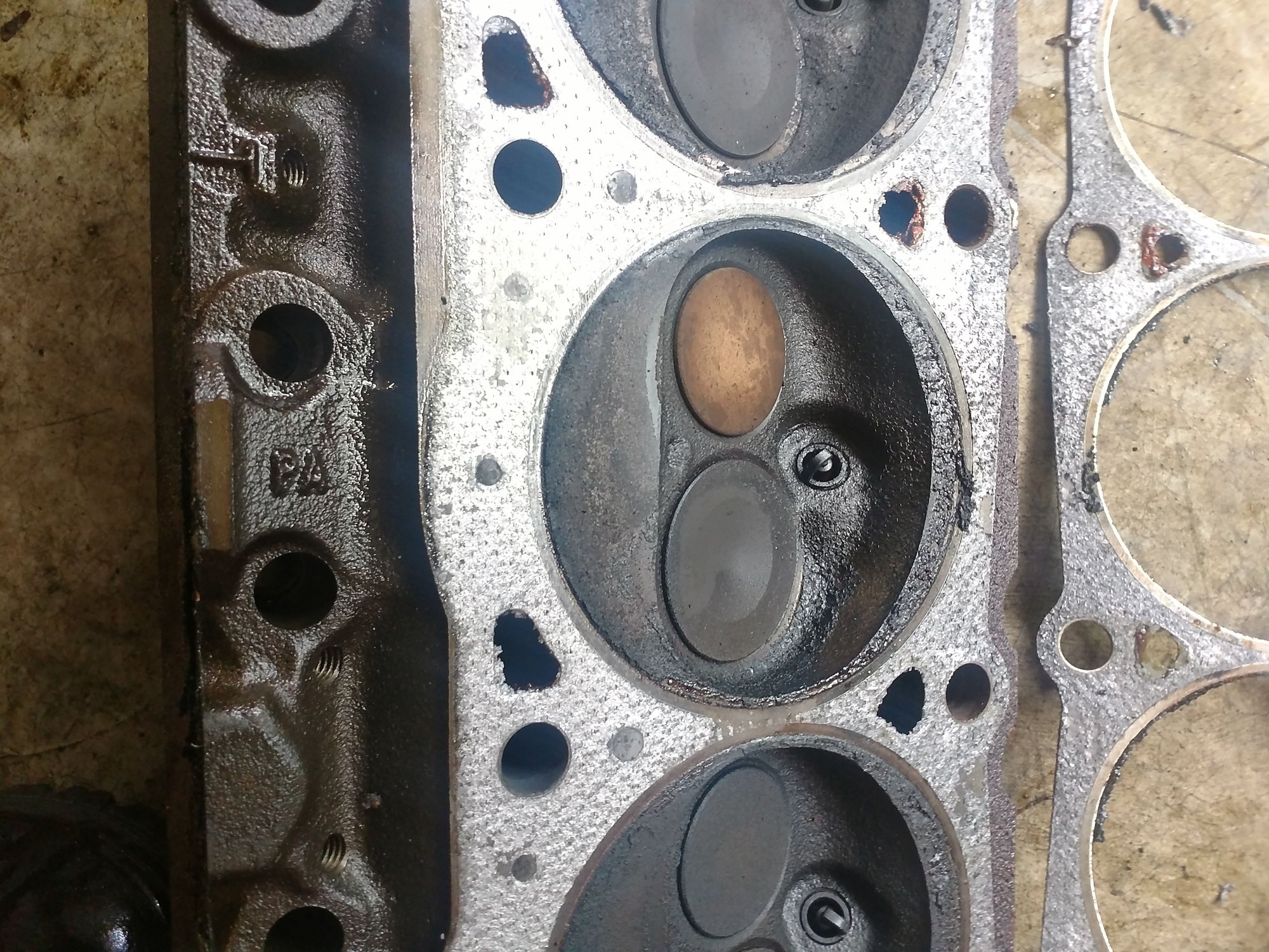

So I went with a 96 351w roller motor out of a bronco. I tore it down today and took some pictures. Looks like two burnt valves but cylinders look ok. Hoping to avoid boring them.
My plan is to invest in the heads, pistons, and possibly camshaft. I want to make about 400 rwhp with about the same amount of torque.
Thoughts?

I wouldn't consider those valves burnt but just those cylinders running hotter than the others.
It seems to be penny wise and pound foolish to invest in new pistons on a stock XXXXX bore.
Unless of course you mic the bores and they are OK for the piston you intend to use.
I would do more than a dingle hone on my hand drill though to seat the new rings.
400rwhp out of 351ci and towing don't go well together. Add in an automatic and tall gears and you really have an under-performer.
You would be better to realisticly identify what the truck will be used for, and then build to that.
You'll be happier in the end.
