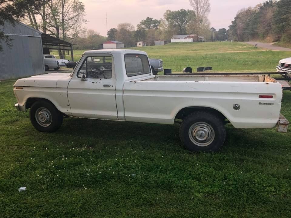

Wanted to show off my new toy.
1974 F-250
360 FE/T-18
Power brakes, everything else is manual. Seems like only a few years ago, this body style was everywhere but I don’t see them so much anymore. I got this one because the guy was in over his head mechanically. Dude put a 4 barrel Edelbrock on a 2 barrel iron manifold (with adapter), but used a high pressure electric pump with no regulator. Acted shocked that the carb was flooding. I ended up putting a timing chain, new mechanical fuel pump, belts, hoses, and new 10-ply tires. Going to tackle a clutch job next week or so.

nice survivor!

Uncle Jessy.
looks great.
