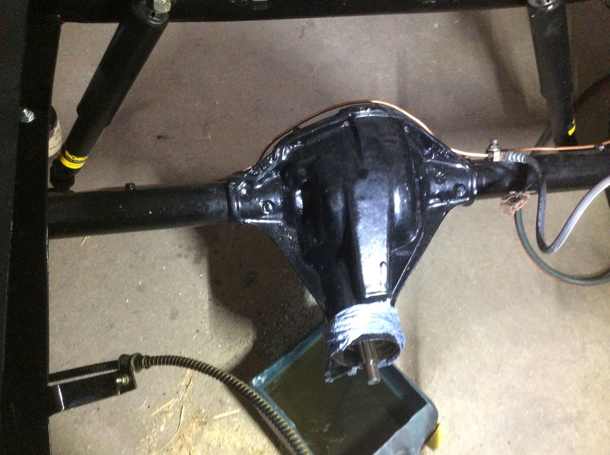

Rear axel help
I'm doing something wrong or just sitting well. I have also tried to heat

I assume the nut is off? Of course it is.
I have pulled many that way but the stubborn ones required the use of a bearing splitter behind the yoke. Too much pulling force in your configuration will actually cause the yoke to close in on itself and the pinion shaft. And don't forget to smack the puller bolt head smartly when it's under tension (stand clear). Has this ever been off before?

Putting a bearing splitter close in next to the seal allows the pulling force to be applied as close as possible to the splines and away from the yoke preventing deformation.

That pinion flange has a big locking nut on it that is torqued to about 115 lbs. It should have given you fits to get it off. Best thing is fab up a flange nut remover and bolt it up to the flange to combat the torque wrench. Then when the nut is off tap the puller with a brass hammer and that flange should come right off.

Add some type of spacer between the puller and the pinion shaft, you are about out of puller threads, apply pressure and hit the end of the puller as Bob said.

Might be hard to do from the top with the cross member in the way but you need to smack that hex bolt that you tightened while you have the tension on the puller. An eight lb sledge will work with less than full force. The shock will cause the yoke to pop loose. I think a couple folks have mentioned this above, the way these pullers work.
