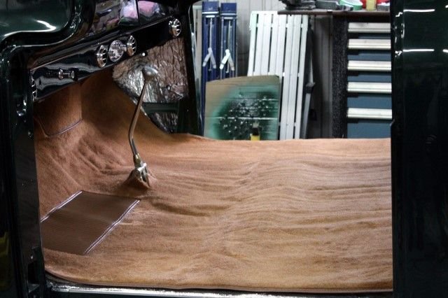

If your LOKAR shift lever is anything like mine there is a switch right on it, just split the wire to your solenoid

Are you using a column shift ?
As John said the lokar floor shifters have a detent switch .
