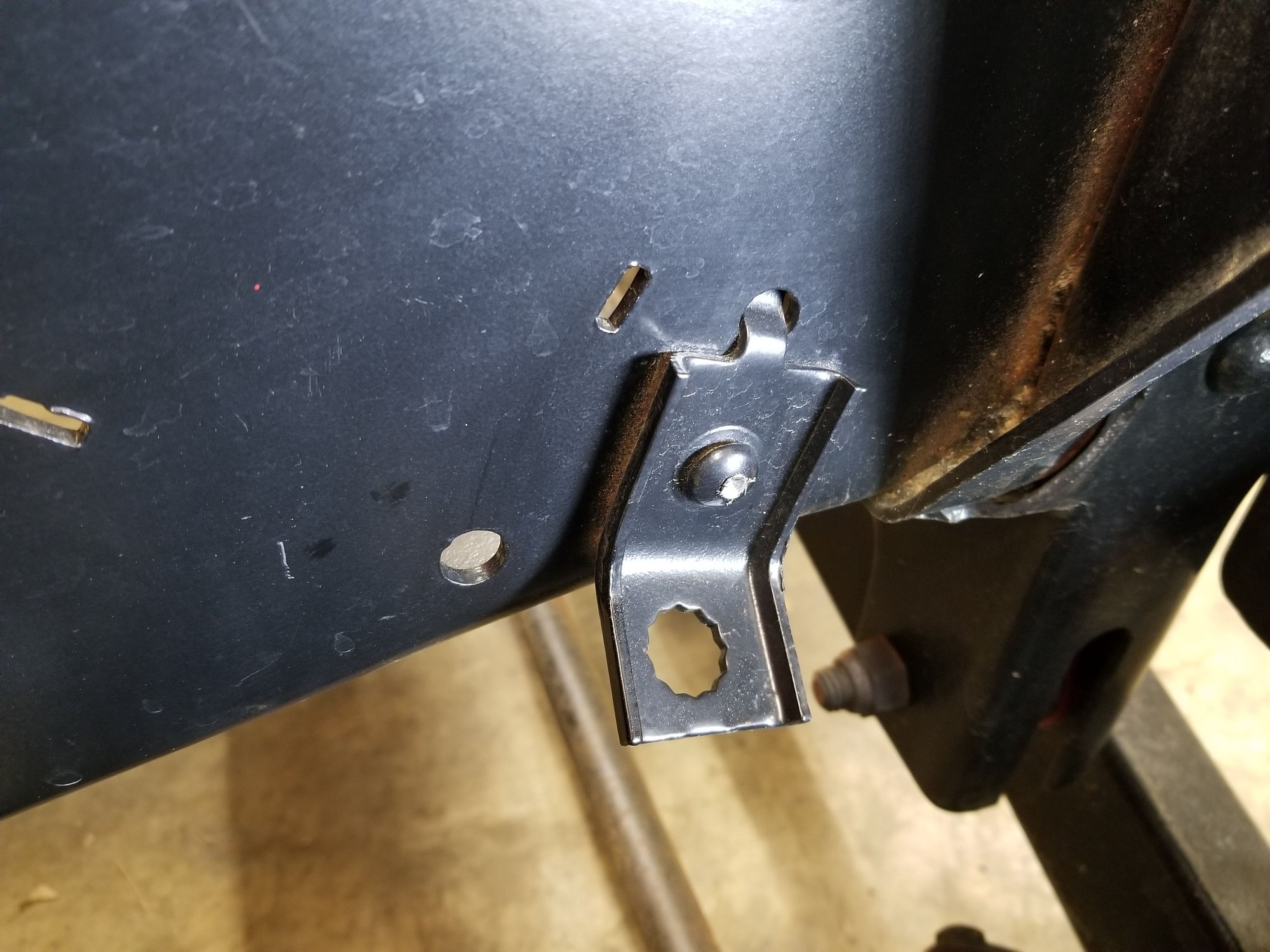

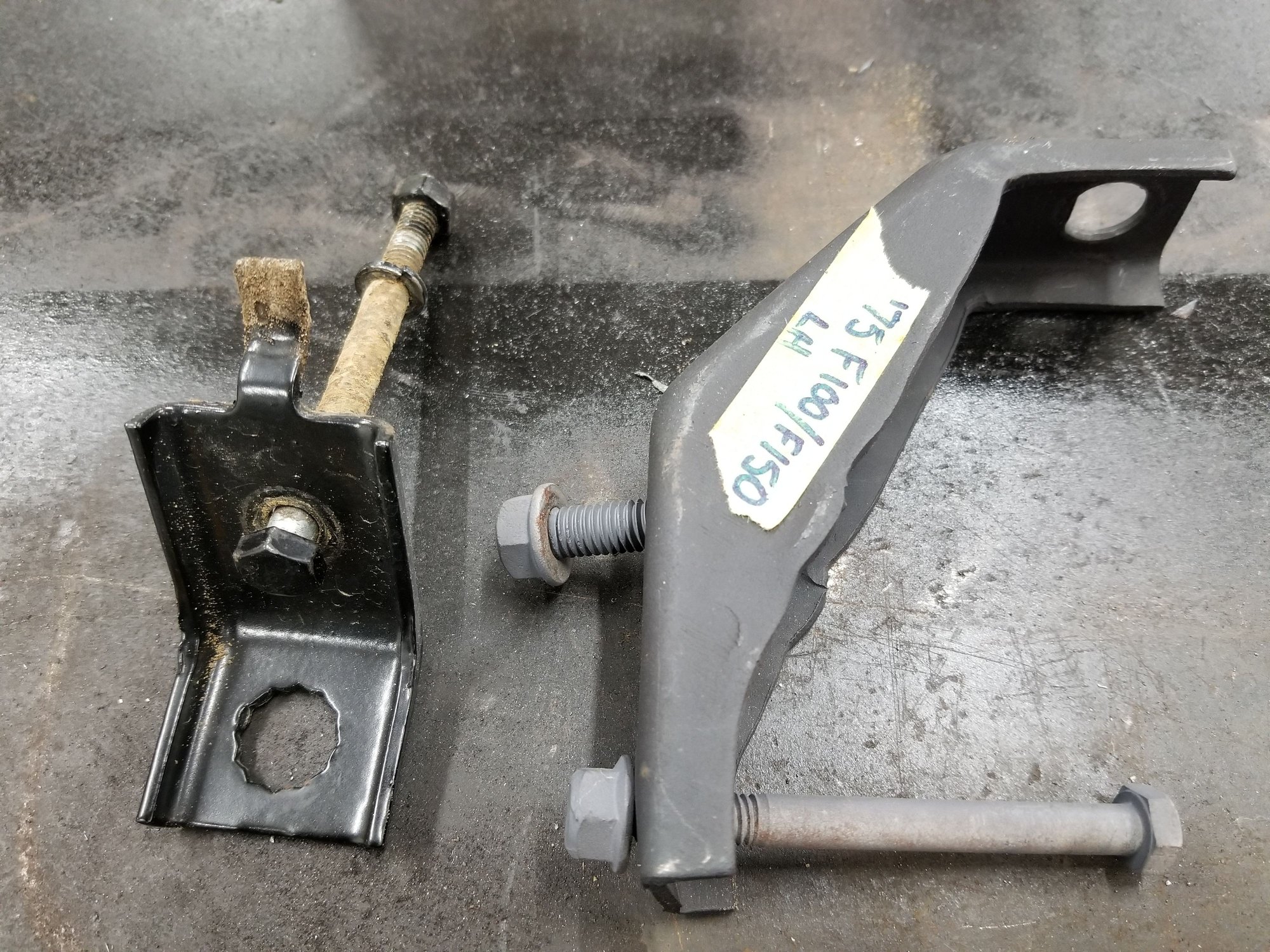

You only need the hard line-to-flexible brake hose frame brackets if you have a '65-'70 model truck. The '71-'79 models have the correct, taller, L-shaped brackets from the factory.
Small, low-mounted frame bracket that would be on a '65-'70 model (this one pictured is on a '65 F100).

That's perfect! I actually pulled these off of the donor, if anybody needs them. The ones on my '72 are already the correct ones.

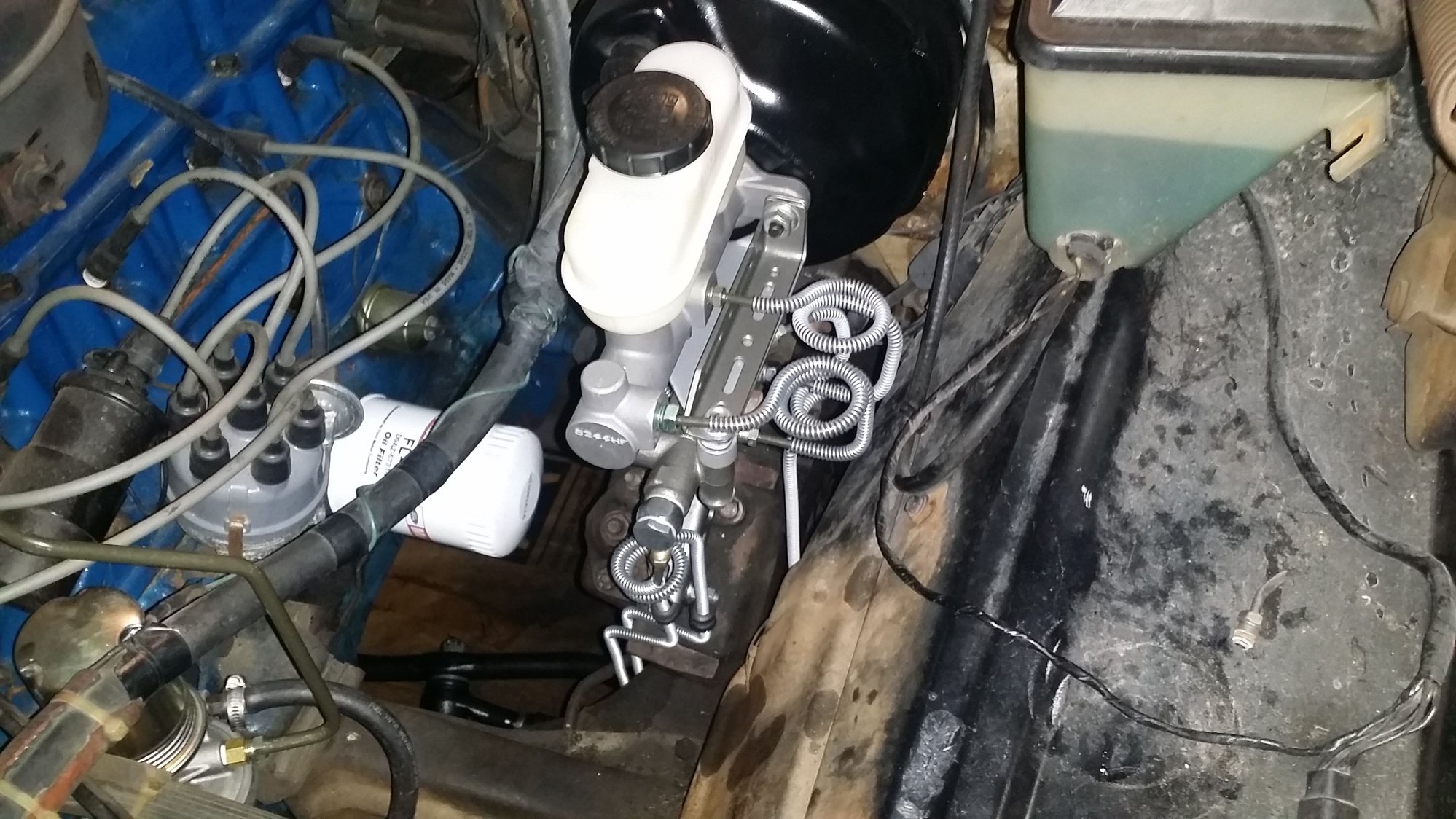

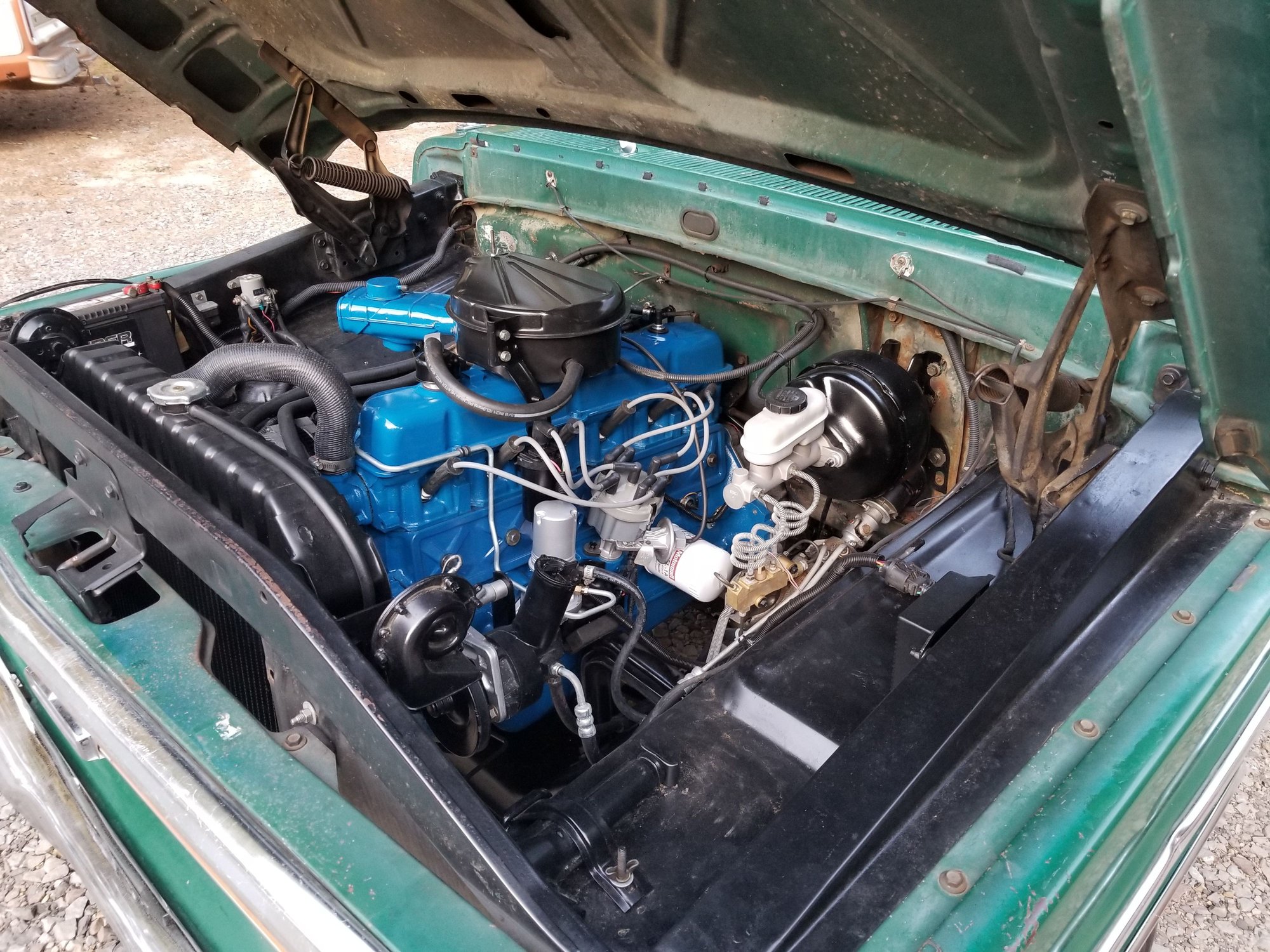

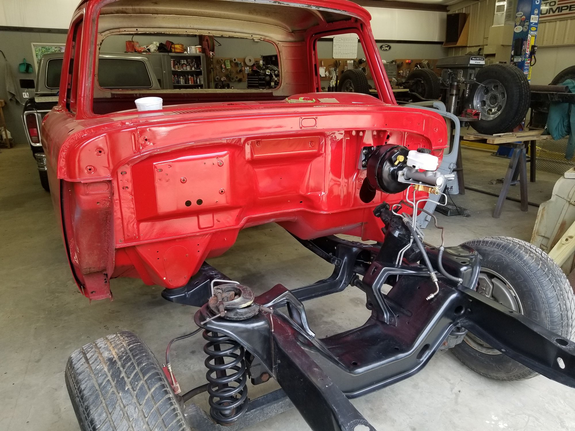

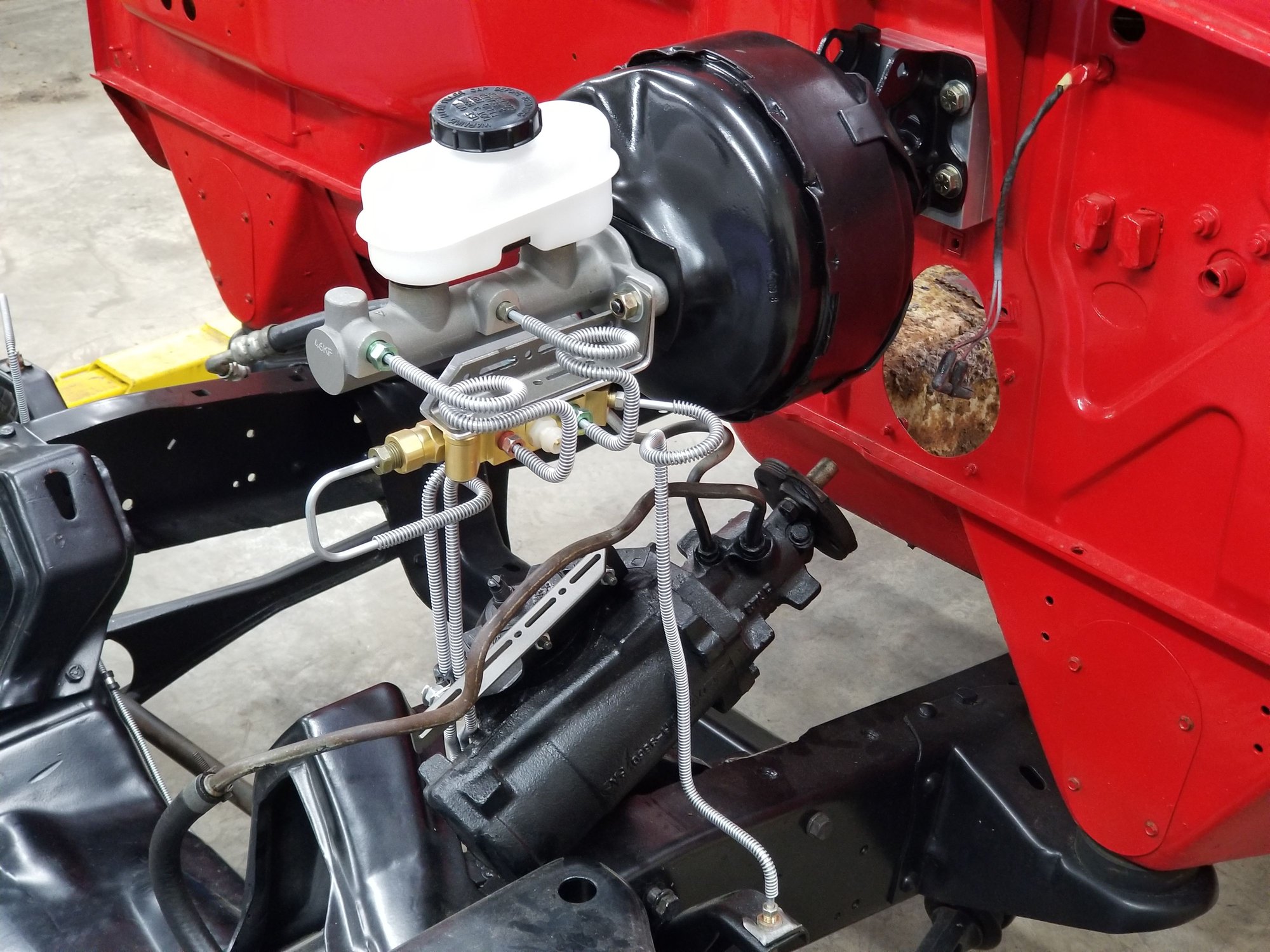

A booster from a '68 through about a '77 Ford truck would bolt to the firewall without modifications to the parts or to the truck itself. The dual diaphragm booster in my '69 F100 came from a '75 F350 (I traded the booster in as a core for a newly rebuilt booster). This booster has an adjustable output rod but the long input rod (between the brake pedal and the back of the booster) is not adjustable.
This is a rebuilt dual diaphragm booster for a '68-'72 F350. It has an adjustable output rod as well as an adjustable input rod. I've installed this type of booster in a '72 F100 as well as in a '65 F100.
Application in a '65 F100.
Application in a '72 F100.
All 3 trucks (the '65 F100, '69 F100 and the '72 F100) have Dentside F100/F150 type front disc brakes and stock drums on the rear but would also be compatible with a CV swap and even with discs added to the rear too.
--I had a 2003 CV front suspension but, decided I didn't really want to cut up my '69 F100 Ranger's frame to install it. I sold the CV front suspension to a buddy who will be installing it in a '77 F150 with a turboed 5.3L.
