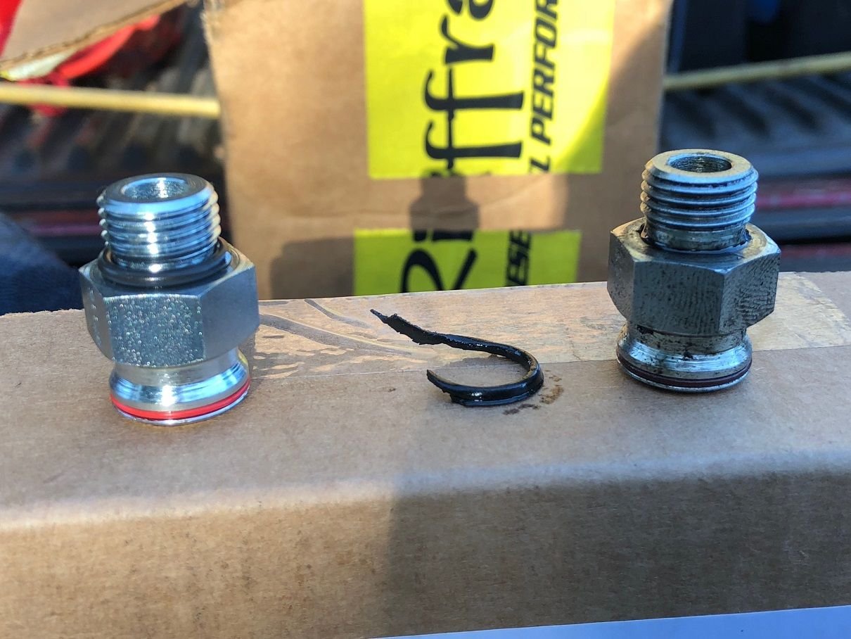

I was under the impression that the HPOP would be returned to the customer with new fittings including new o-rings and loctite. I might be wrong on this.
The non-check valve HPOP fittings simply remove the disc and spring from the fitting. RiffRaff sells "high flow" fittings which are welled out a bit.
You can see them in the picture below going off memory of what they look like.

I am too. When the oil started streaming onto the ground I opened the hood and started poking around with a flashlight. The forward HPOP fitting had a steady flow of oil coming out of it and I could see a bit of the o-ring sticking out. Everything else is covered in oil (from this and other things...I gave up cleaning the block a long time ago) so I don't know if this is the sole cause of my problem or not. Short of pulling everything out, cleaning things up, then camping out with a flashlight and a good book, this is my quickest option to getting the Money Pit back on the road.
I am confident that this might solve the issue though. In case it's not evident the new fitting is on the left ...

Are you still supposed to put lock tight on the threads? There's a lot of pressure there. I know when I got mine I had to call around to find out how to remove the lines. He got back with Clay and they asked me if I removed the fitting. I hadn't. I made a 9/16 old wrench I had work for the clamp. I'm pretty sure that was your problem for sure.
Old Jun 5, 2018 | 02:26 PM
brian42's Avatar
brian42
Veteran: Navy
Joined: Dec 2006
Posts: 7,092
Likes: 145
From: San Diego, CA
Yes, Loctite 680. It only goes on the first 3 threads and helps seal the fitting to the pump. The fitting is only torqued to 25 ft-lbs so the o-ring is the main pressure boundary. Doesn't seem like much to hold back 3000+ psi but it does.

Looks like you found the problem Brian. At least it was the front fitting too.

Yep, that o ring look like it might leak!
