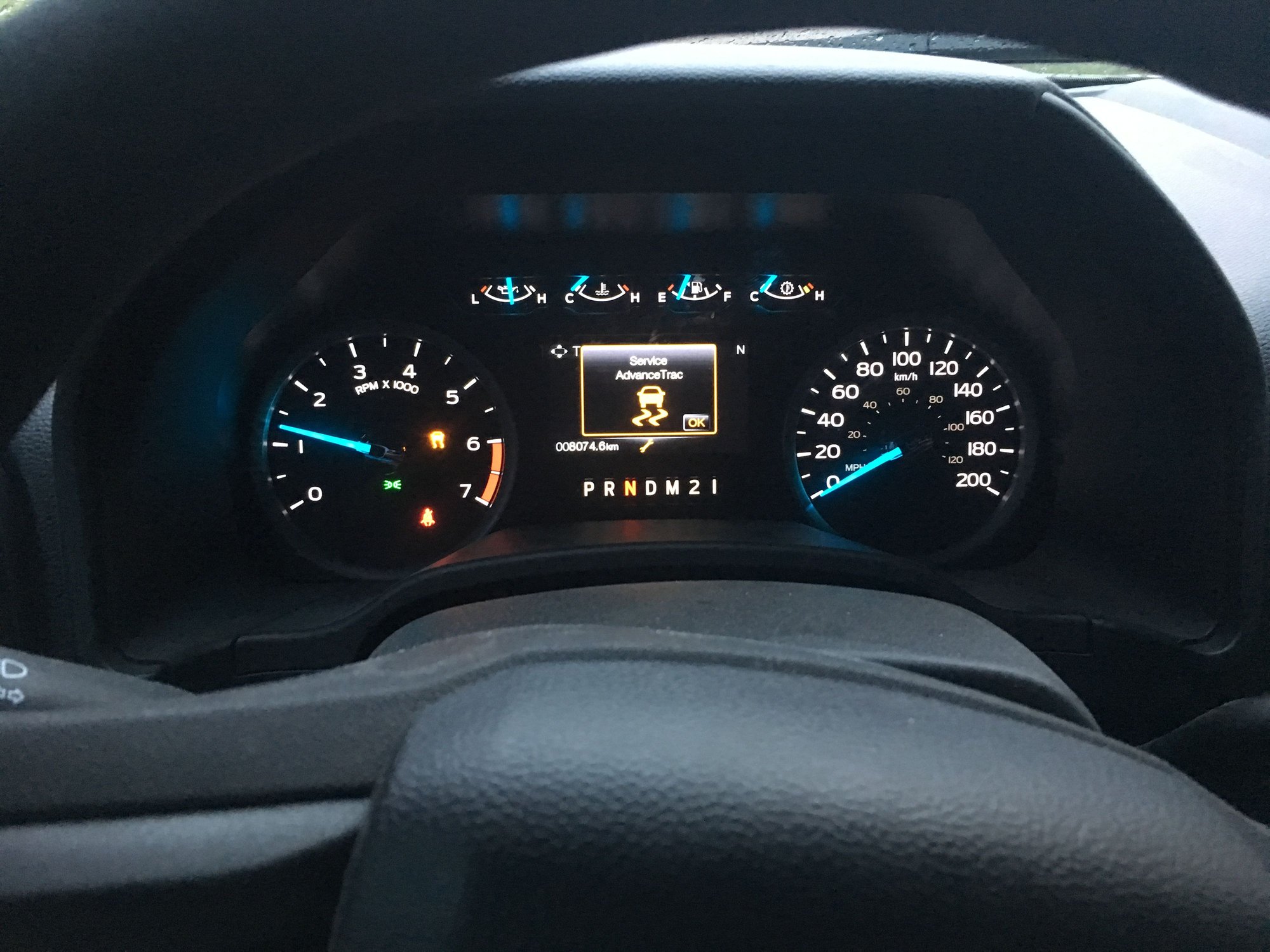

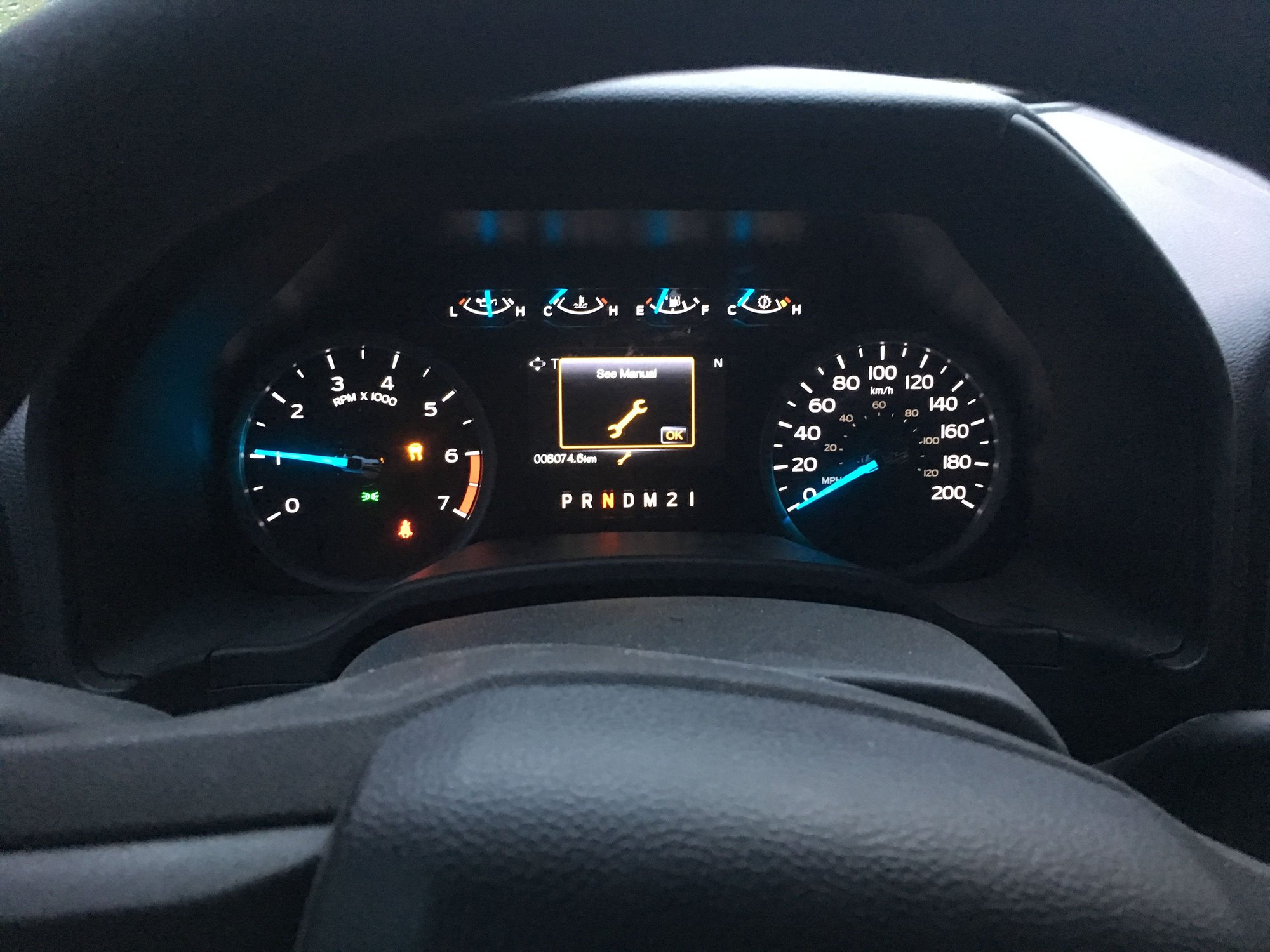

Have an almost new f250 with about 9000km. First time issue happened was with 800km. Problem occurs only on very damp mornings (likely 100% humidity).Truck starts fine but instantly goes into a service mode with the wrench icon appearing. Service advancetrak warning box also and hill start assist not available. Truck also goes into a limp mode and is gutless (no lights or icons, just that you feel it while driving). It would literally take 30+ seconds to get to 60 mph if I were flooring it. These modes usually last an hour or so and then clear with no lights coming on the dash... everything back to normal until next very wet day. It took me a couple months to get it to the shop as I own a contracting business and was far too busy to take the time to deal with it. Hence why I bought a brand new truck in the first place.
Next problem occurred when I started the truck and lost all accessory power, although it started and ran fine. I had no power at all to my gauge cluster, radio, windows, climate control, etc. At this point I finally took it to a local dealer. Once there I got a rental, after emptying out a full truck... pain in the ****.
The dealership ended up keeping the truck for a month and replaced the gateway module. Apparently over a $1000 fix and the advice of Fords headquarters. Got the truck back, 2 days later... same problems as before.
I now took the truck to the dealership I bought it from because if something will ever happen as far as getting a replacement truck I have to deal with the dealership I bought from (not close to home= pain in the ****).
They had the truck for a week and replaced the throttle position sensor, and assured me that was the cause of those problems. A few days later, same problems except both of them came at the same time. This has “not” happened before. Unreal. I’m running out of patience fast. I’m also beginning to think to trucks whole electrical system is toast. Ford can’t even seem to diagnose it. The codes stay in the computer but it mustn’t be obvious what to do. Problems occurred yesterday and going to start making calls tomorrow
Any suggestions out there.. I don’t have time for this back and forth to the dealership with nothing being resolved. I mean, who would. Should I be demanding a new truck? Anyone ever had to go through that process?
