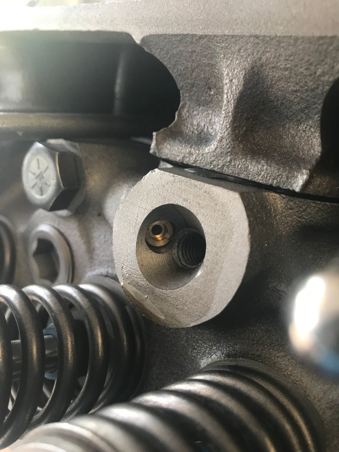

There was a recommended Holley jet size that did the trick, and they were the perfect size to drop into the oil feed hole. Anyone remember?

The perfect size is determined by your engine build and use. Holley jet sizes .060 through .090 were used most of the time. The outer diameter on the jets were the same for these sizes. The difference was in the size of the holes.
I don't know if you could get a consensus on which size would be the best for most applications. .090 works for me, but I do not have scientific data to prove it is the best. Only data I have is that I have never lost a FE from oil starvation in the last 50 plus years if building FE's,

One of my old Ford Performance books said to used a short piece of 5/16 rod with a .080 hole drilled thru it, probably what they where doing before someone realized a Holley carb jet was a good fit.
So what ever size Holley jet that has a .080 hole, the number doesn't always recipient the size of the hole.
Edit: Acording to my Holley book a 74 jet has a .081 drill size, 80 jet is .093 drill size, 90 jet is .104 drill size

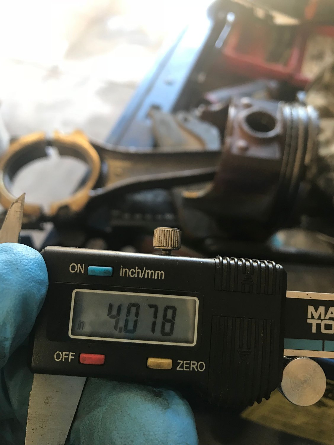

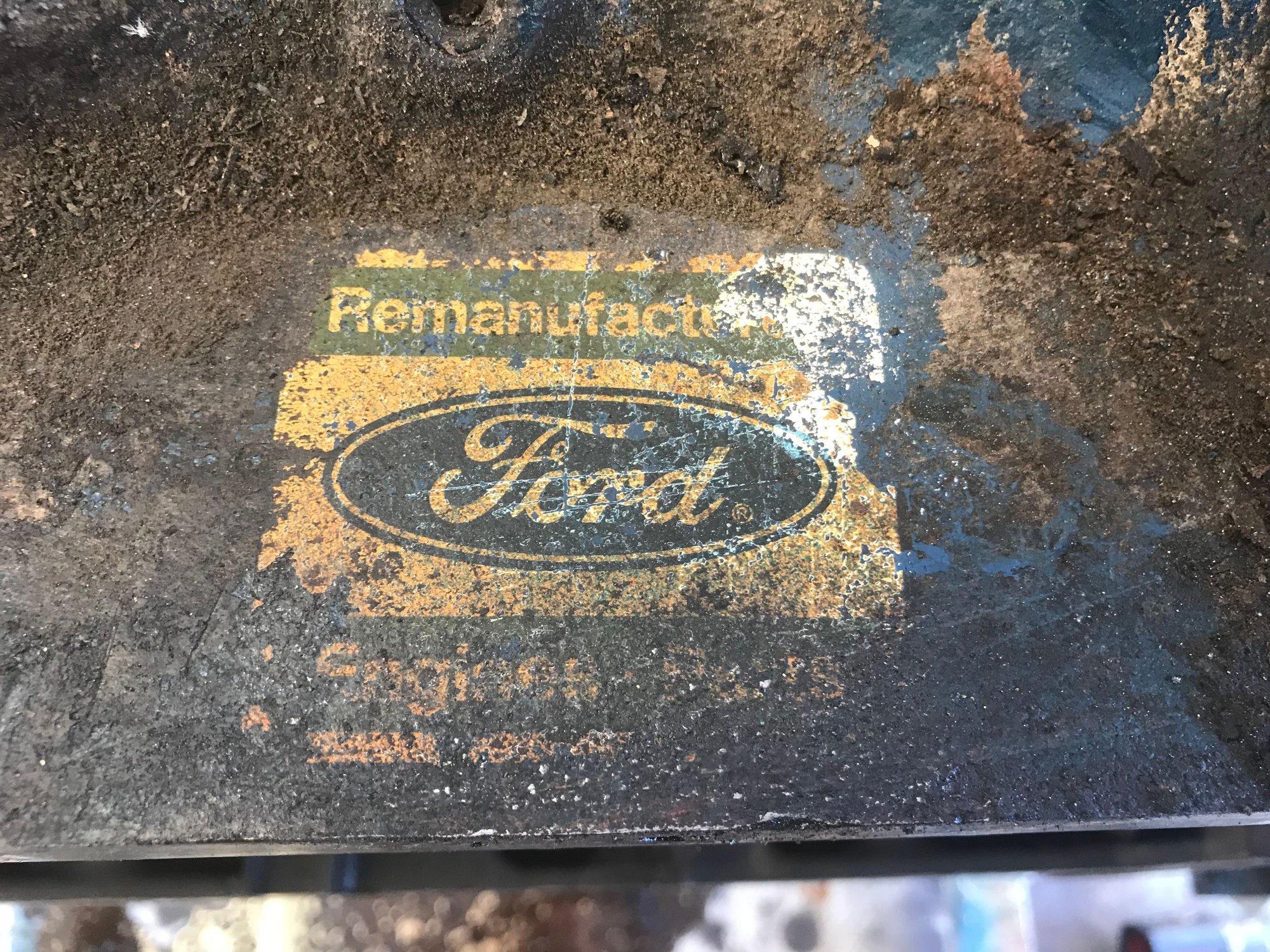

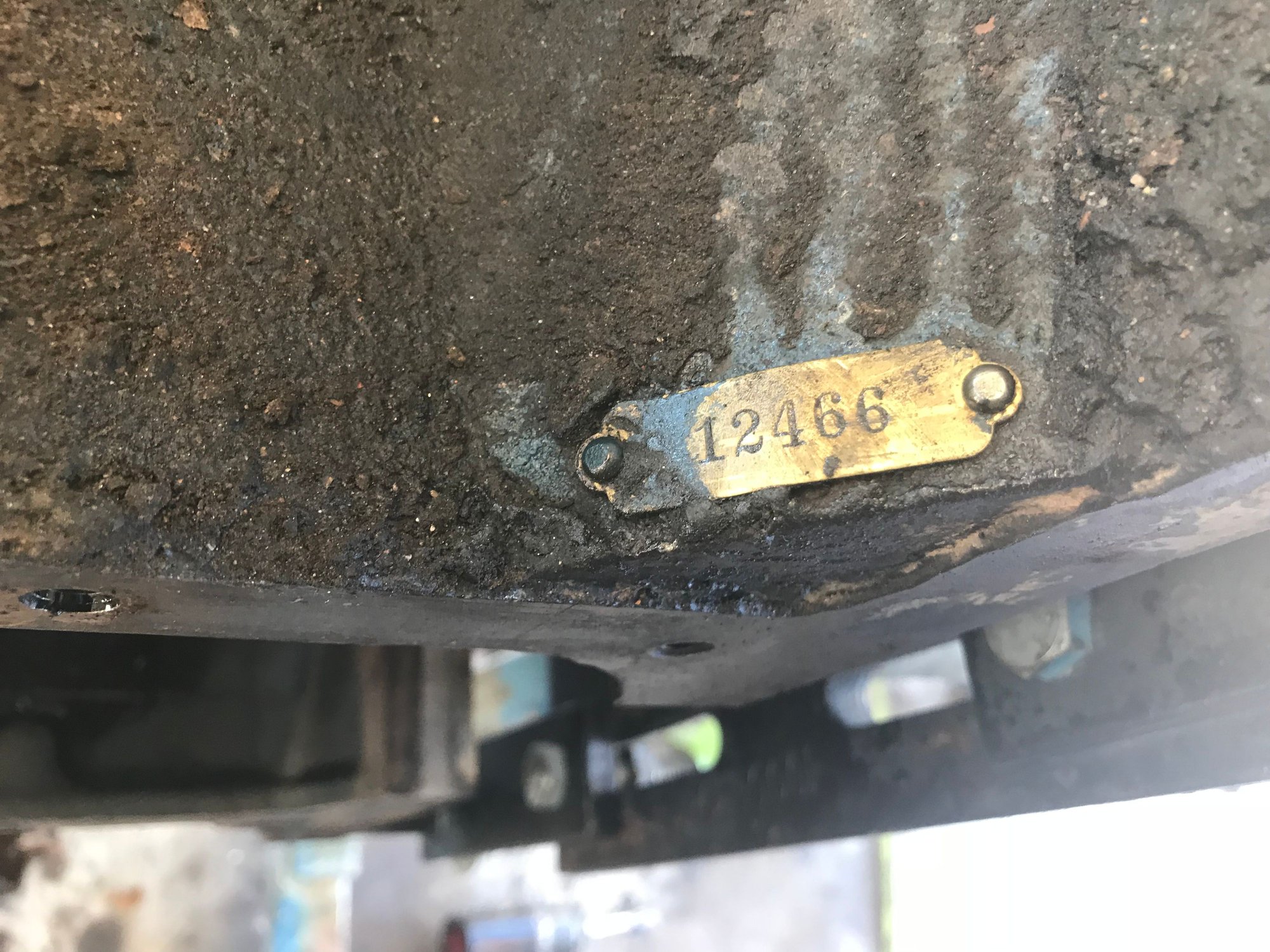

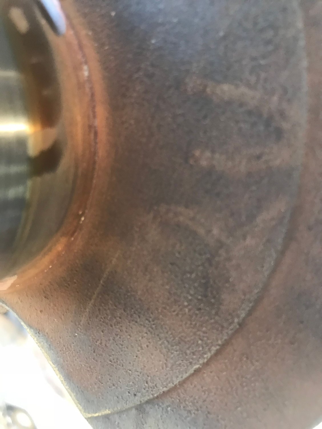

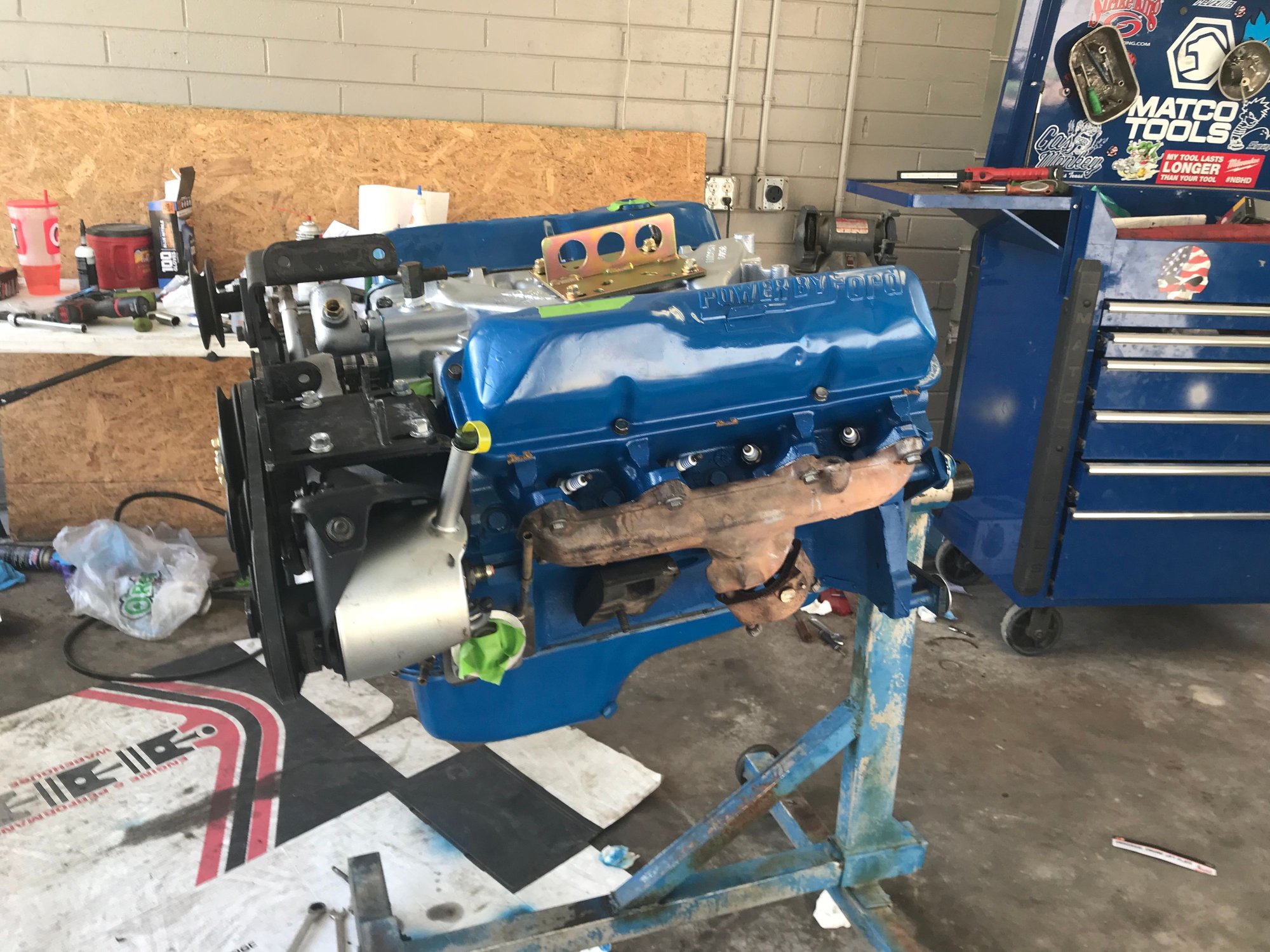

An update!
I was able to pick up a 390 this weekend. Made a two hour drive down south and checked out the "390" from the 71. Measured the stroke and it came back as a 390. Paid the man and headed home with it. Disassembly further revealed that it is in fact a 390. The crank has the 2u marking and the rods have a stamping of C7AE-B. The engine has obviously been rebuilt in the past and appears to be low mile. The cylinders measured 4.078 and all bearings had a 010 stamped in them. Crank looks phenomenal as do they cylinders. They still very much had the original cross hatch. I disassembled it and will be dropping it at the machine shop tomorrow afternoon. I'll let them check it all over again, do any machine work needed and order me a kit.
I may be able to use the rockers off of this motor, they look to be in really good shape and the push rods are pristine.

If it looked that good I would clean it up and put it back together.

Got it all back Monday. Took the week off to build it and install. Tomorrow I’ve got some odds and ends to do, then it’s time to prime the oil system and fire It off .
