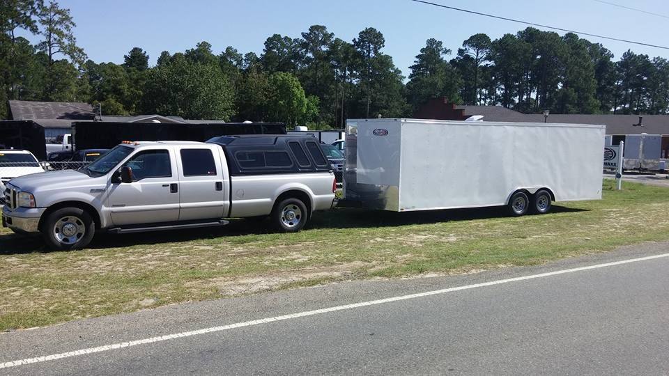

I never towed my trailer with an F150 but the brakes worked virtually identically on both my '07 F350 and my '17 F250. And I towed the identically loaded trailer one day with the F350 and the next with the F250. But I suppose the F150 might be more aggressive on the controller due to the lower capability?
My two trucks with the same trailer.
