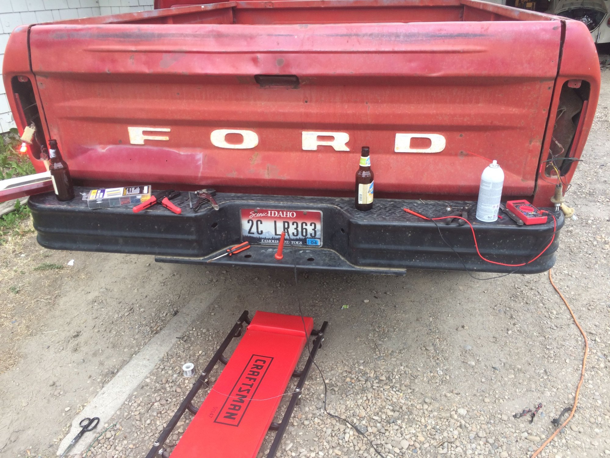

Your thread last month prompted me to swapped out OE incandescent for LEDs in my 77 F-150 for just the rear tail lamps and they work perfectly. But I have the two rear step bumper license plate lights, that I see your missing, so instead of tucking an extra socket behind the lenses and body, get one or two license plate sockets and bulbs in case it solves your dilemma with the added electrical draw.
On a different note, were you rolling on the creeper or using to lay on? From the picture it's a little difficult differentiating between exposed aggregate finished concrete or gravel, though both would be difficult for a creeper to roll on.

I thought about that, use a light for a purpose.. lol. I guess it would make sense. Yes. I do wonder about adding those 2 plate lights in, as LEDs though.. wonder if that would do it.
Was using the creeper for laying on, lol. It's gravel out there. Not good for roll'n! I bought that for the lady for working on her 73 bug, which is on concrete.
