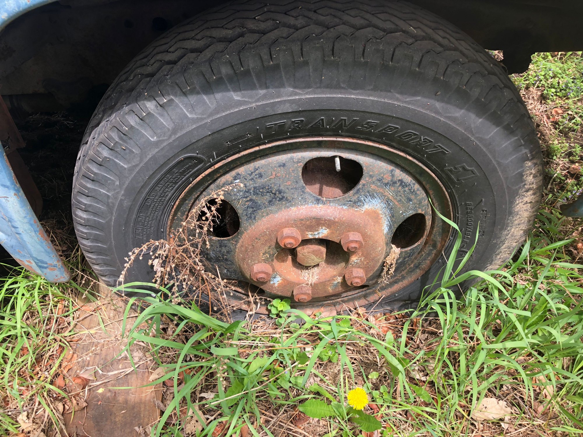

Welcome. The stories that bus could tell! As you do your research about the truck please learn about its wheels. I can tell by the shine on the outer rear dual that it has what are called “widow maker” “Firestone RH-5°” wheels that few shops will touch these days. Some Google time will give you better pictures, and old discussions here with replacement solutions. Stu

Here are more pics of the wheels

Yeah, widow makers. The raised band area on the concave side is the joint. I mentioned the shine seen in your picture as a clue to them being widow makers. The width of that side ring, and the fact of the ring being galvanized and shinier than the rim are the give aways. Plus the simple fact that just about all big Fords of the 1950s were fitted with them. Below is a factory new picture. Search using my user name and you’ll find lots of discussions on safer replacements. Stu
