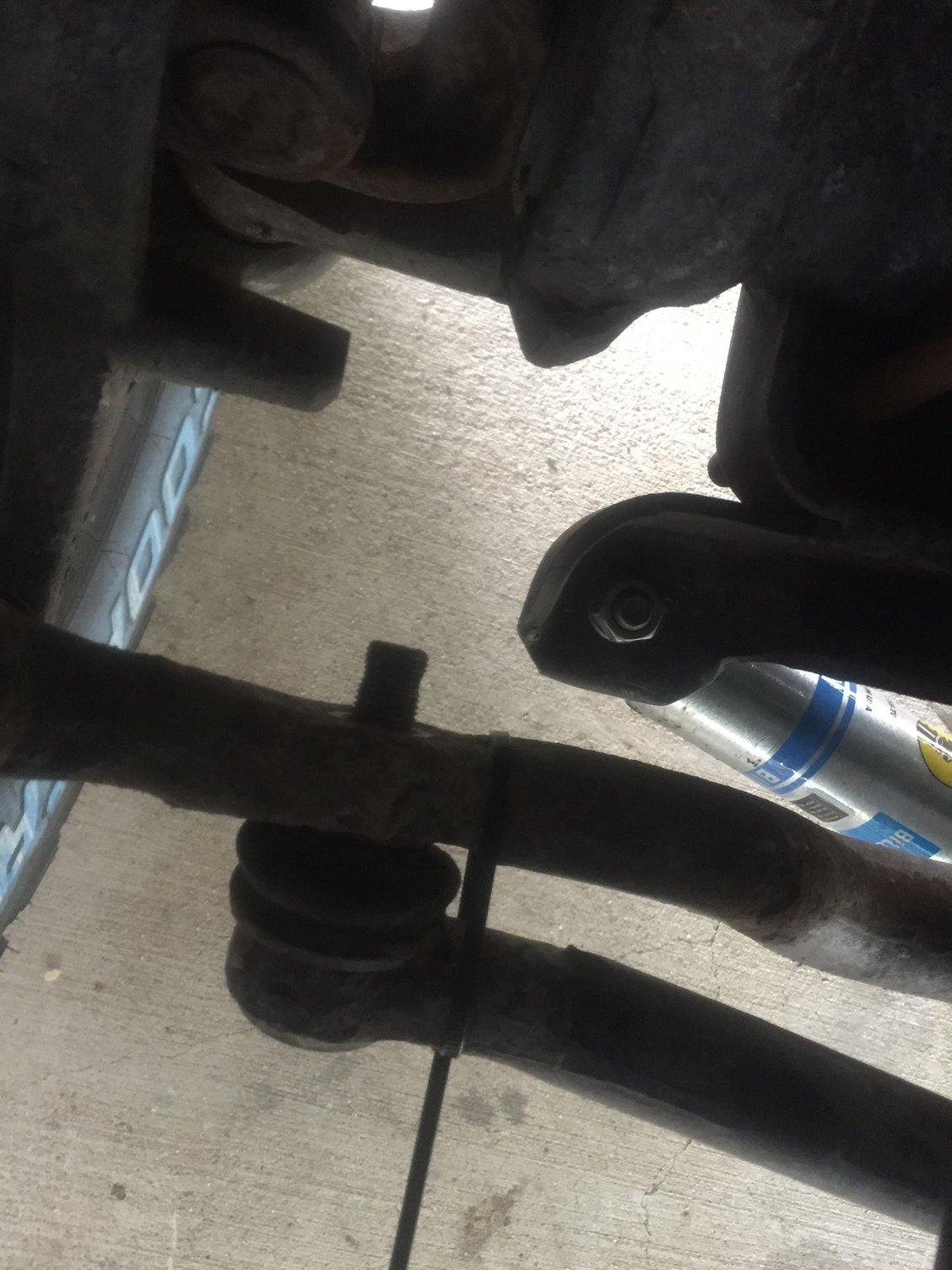

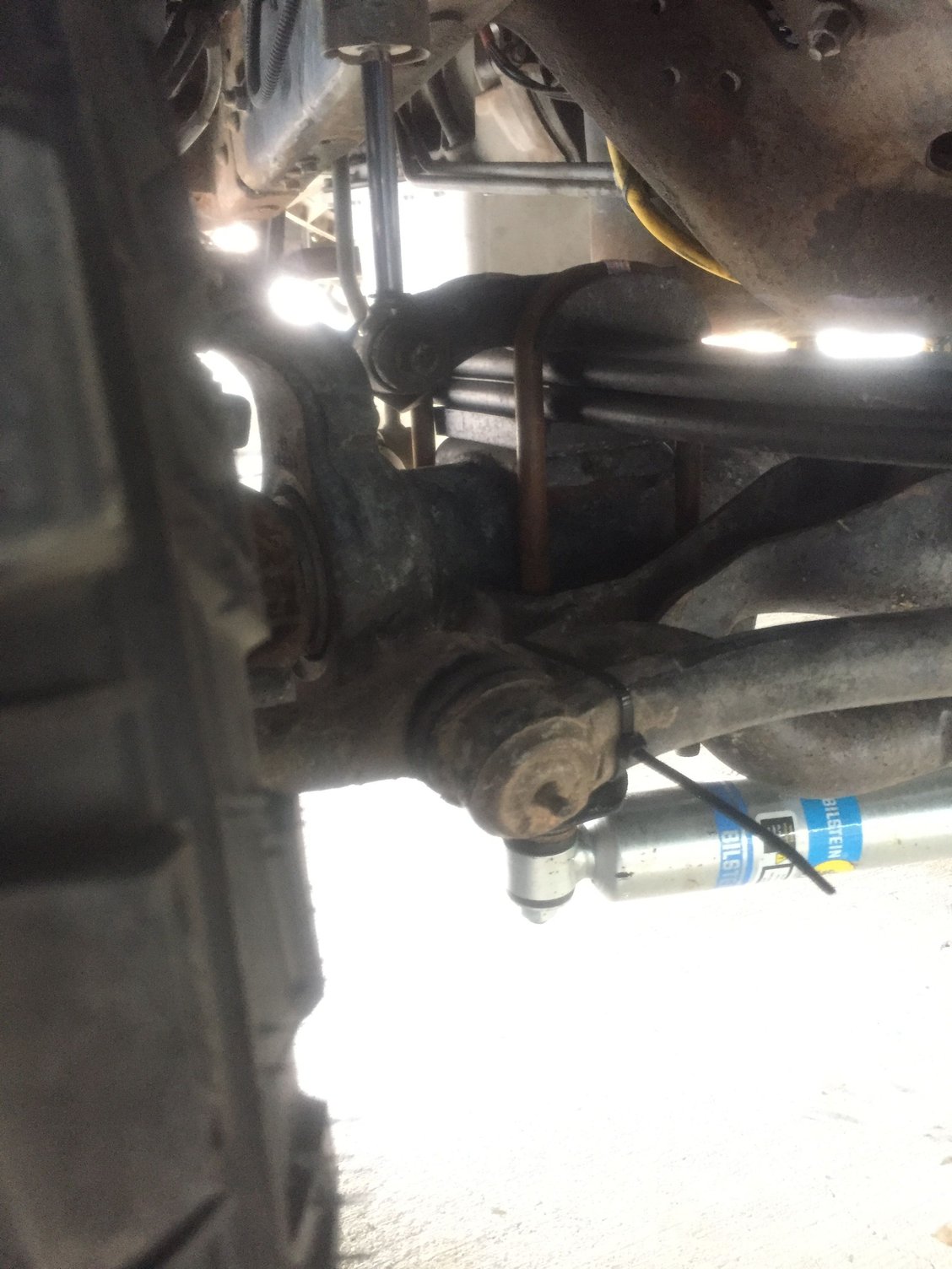

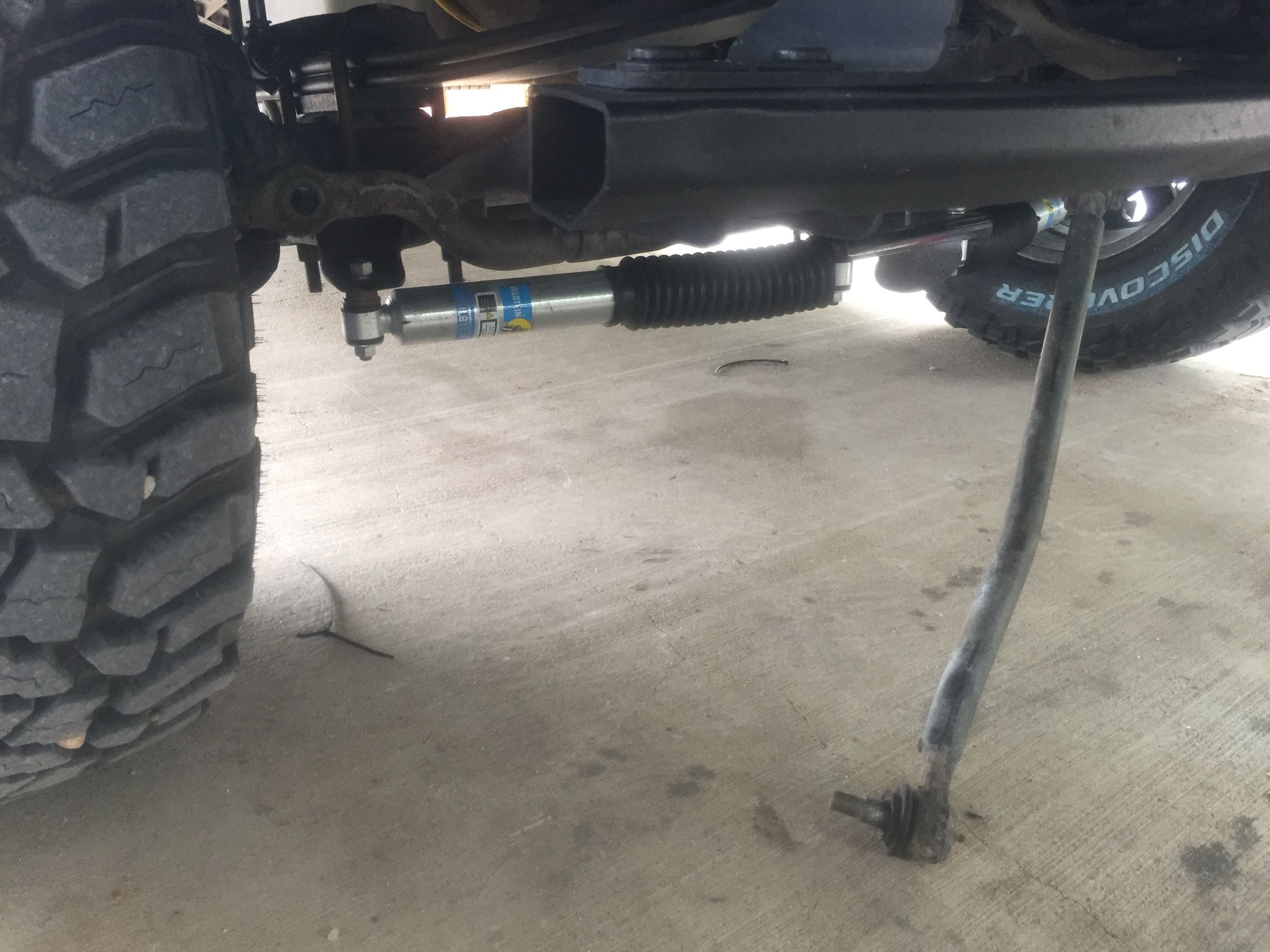

I left the house this morning to run errands and had to drive to the next town 30 miles away and I had a bad feeling for some reason. As I got on the highway I noticed a little more play in my steering than usual but nothing crazy. When I got to town I checked my castle nut on the driver side pitman and it was intact along with the cotter pin so I thought nothing of it and went about my business. On the way home I could tell it was getting worse and just figured I’d check my adjustment on the steering box when O got home. As I was driving doen the gravel road to my house my steering wheel went slack and the wheels steered me into the ditch at 10mph. By passenger side castle nut was gone and the lower end of the tie rod was on the ground! I pulled it back into the hole and zip tied it to limp the rest of my quarter mile driveway home.
Just last week I adjusted my track bar length after X and Mod C spring install and had to drop the driver side of the tie rod to access the lower track bar bolt but never touched the steering castle nut on that end.
Moral of the story- if ANYTHING feels odd with your steering make sure you check everything and don’t be a numbskull like me and only check the side you worked on last!

This is how it looked when the nut backed completely out and the arm dropped while cruising down my driveway.

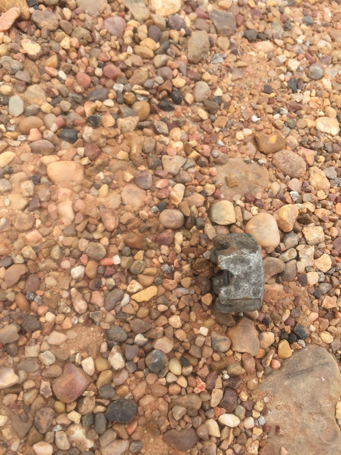

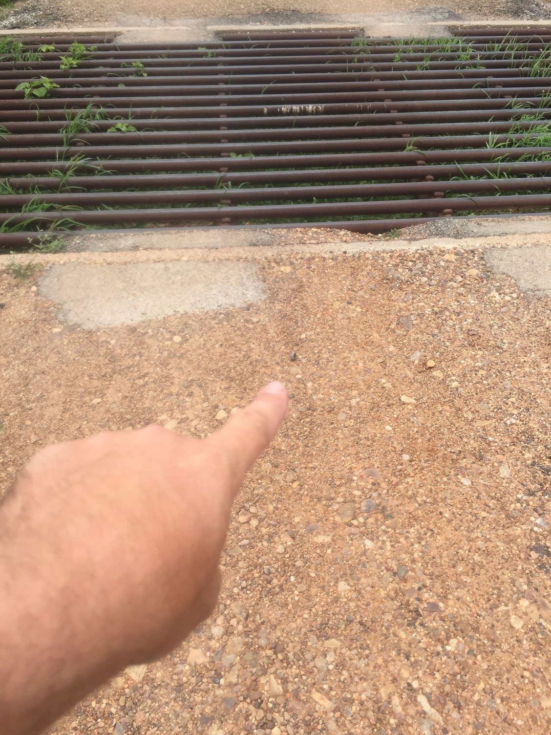

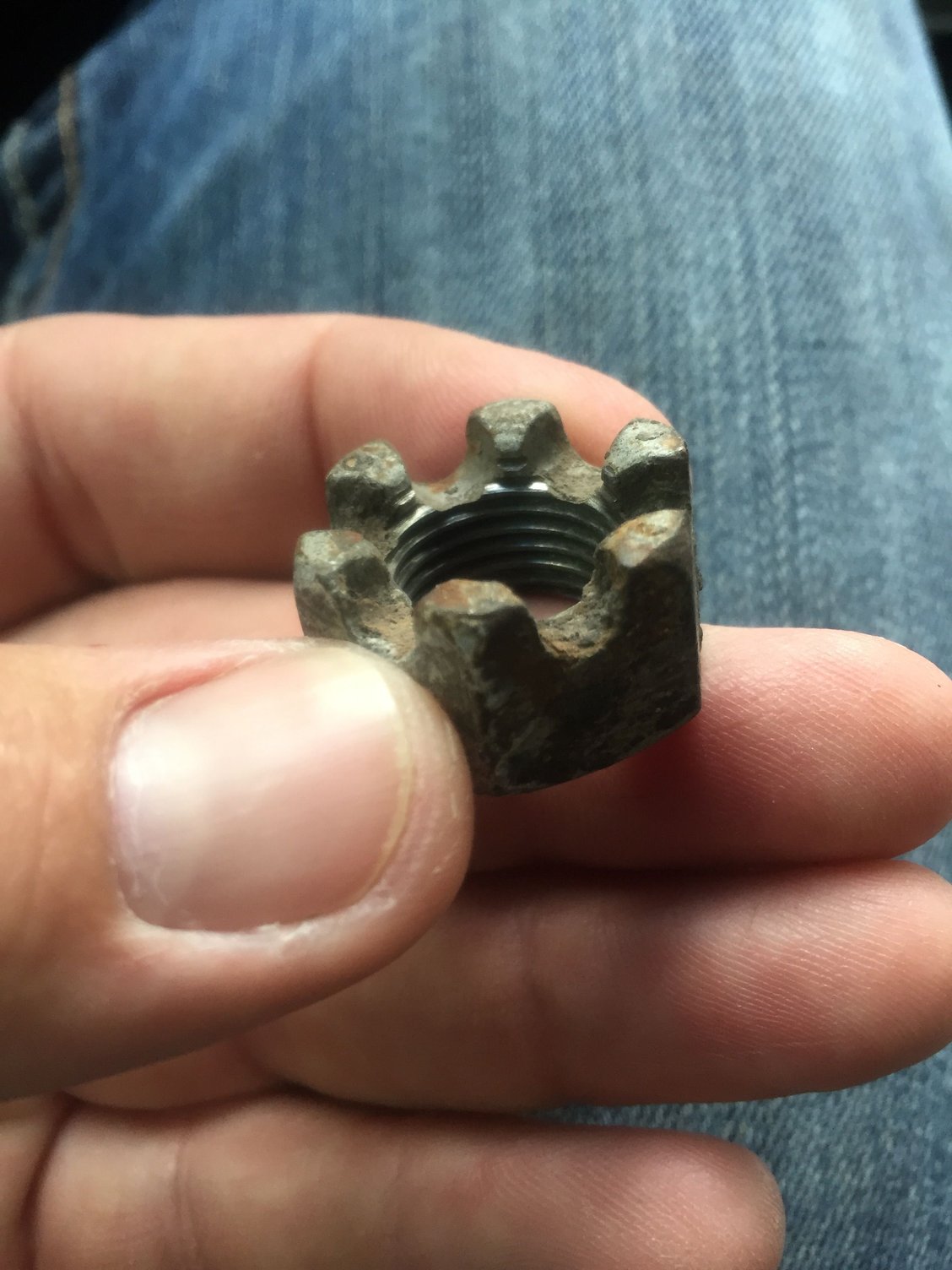

***UPDATE***
I was headed to the stealership to buy a castle nut and pin and what do you know?!? The nut was laying on the road right inside my first cattle guard. It rattled off the last couple of threads as I drove in.
I can’t believe it finally fell off just inside my gate.
