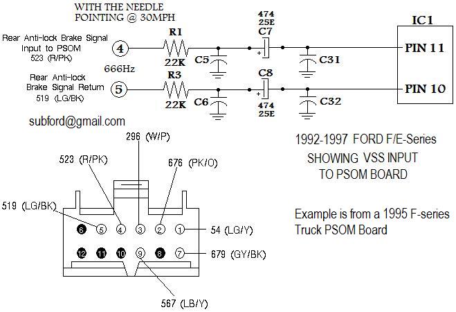

Was the plug plugged or not plugged to the VSS or PSOM or RABS?
The resistance of the VSS is about 1400 OHMS unplugged.
The wiring input to the PSOM is below and I would think the RABS module would be about the same.
Attachment 283102
Attachment 277289
