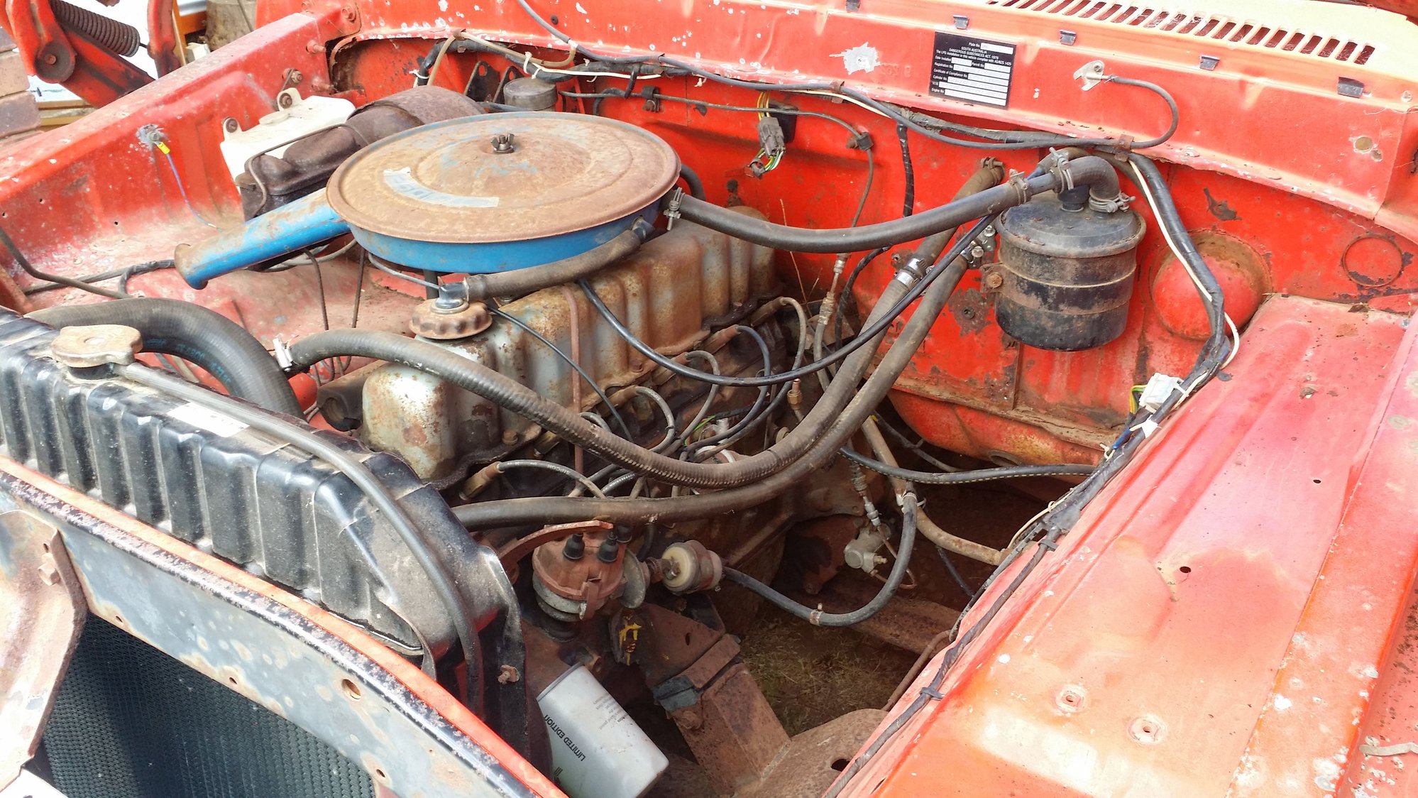

Early 1976, Australian assembled, with the original High Compression 250ci 6cyl log head, and 4 speed manual.

Pulled the wiring (which was joined and taped every 12"), and gas converter (which had been mounted onto the firewall with 12!!! 1/2" coach screws.)
Plugged the LPG port in the base of the carby.
Reconnected the heater hoses, and fired her up.
Must be the placebo effect.... but she fired up instantly, idled smoothly, with no knocking/tapping that she had before.
Heater warmed up. No leaks (yet).
She must be a happy old girl.
Next plan is to pull the subaru electric fuel pump that the previous owner installed, and its associated "wiring", and re-fit a new mechanical pump.
New ignition switch, barrel, and short loom/plug if I can find one

Wow, those are factory engine mounts? I suppose the hydro clutch is easier than mechanical being RHD.

I'm digging the "Limited Edition" oil filter!
It would be interesting (to me and a few others here at least) to do a comparison between the passenger car based 250, and the old 'big block' 240 which was also put in full-size cars.
I wonder if the extra ten cubes makes any noticeable difference, and I wonder if you can feel the larger architecture of the 240.
Either swap 'em into the same truck or find two very similar trucks with each engine.

Ha. Just a standard Ryco Z9 filter. Not sure of the promotion associated with it though.
Engine is an "L" code, high compression 1v, which from my guesstimations, is pretty close, if not equal to the 170hp and 250lb of the 2v variant.
I guess that's probably it's limit without spending big bucks. The 2v gives you a bit of room to play.
Been looking through old sales brochures, and can only see 300's supplied to Aus. Outputs seem very close, either way.
