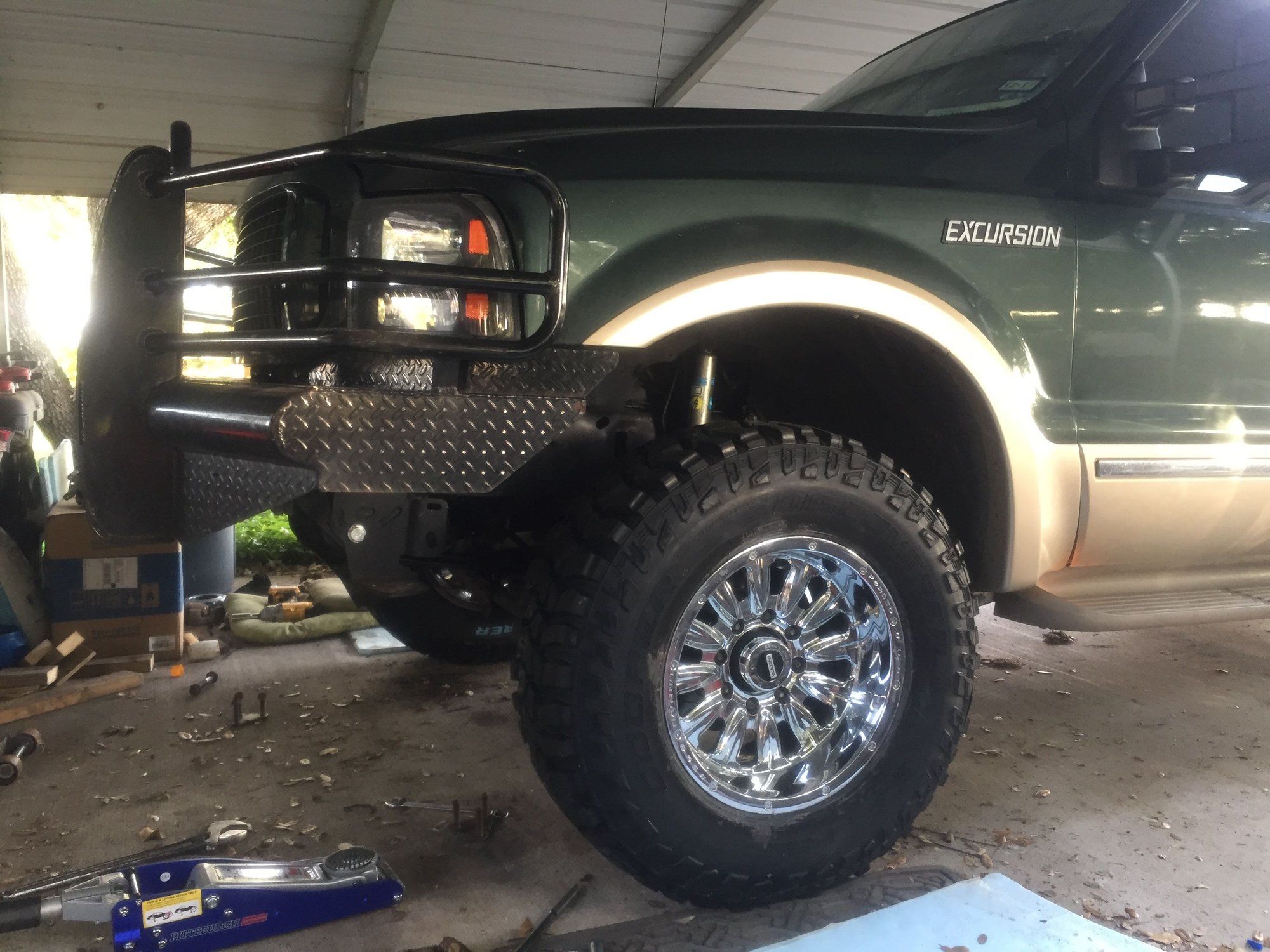

i put one set right in front of the Transmission crossmember on each side and one in the front on each side under my full replacement bumper and adjusted them so they all had weight on them. I didn’t like having all that weight on just the frame in front of the transmission while I was prying and jacking on the axle and springs. I did the fronts last Sunday and rears on Monday by myself with 6 jack stands and 3 floor jacks. Some 2x4 scraps and 1/2 and 3/8” plywood scraps worked like a charm for blocking up on top of the jack stands. I am lucky to live down south where there is no salt on the roads. My truck is rust free and the fasteners came out without heating anything up.

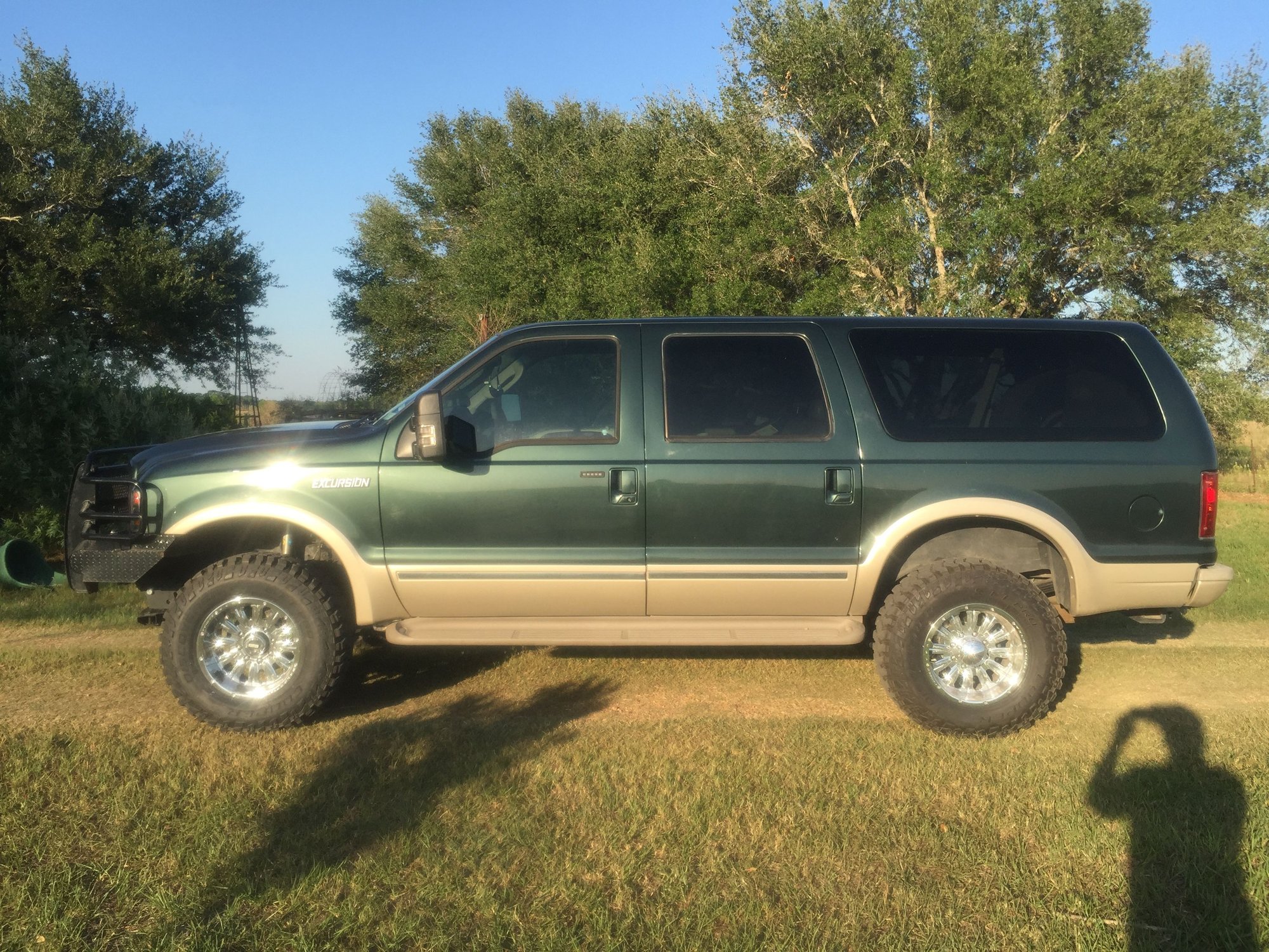

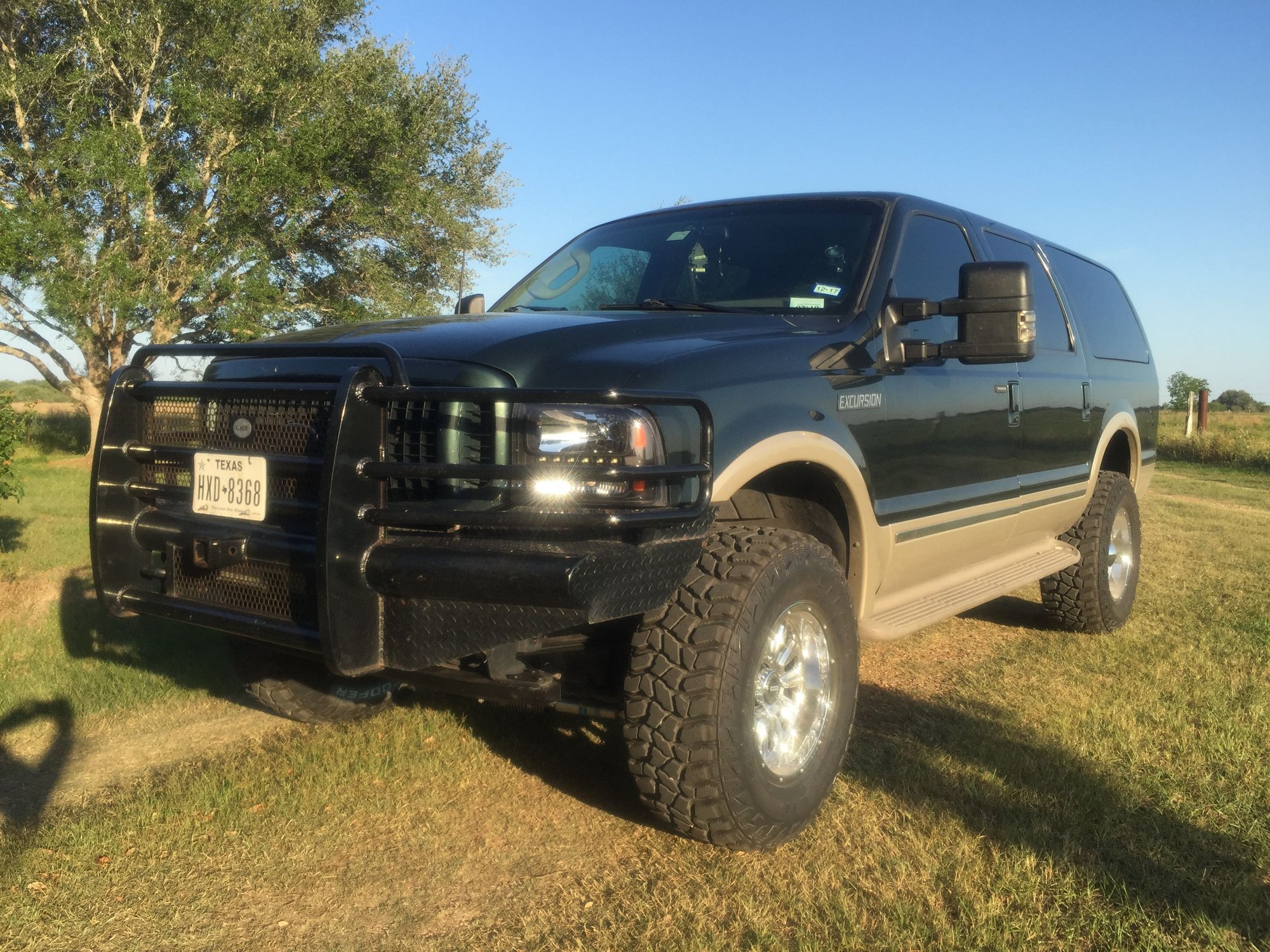

Did you cut your fenders out to fit those bigger tires? Its hard to tell from the small profile pic

No, 35x12.50’s fit fine, just had to wire the rear of front fenderwells back so they don’t rub when I turn into parking lots etc. ni

I’m going to go another 2” in front with ICON 2” shackles and 1” more in the rear with an F-350 3 1/2” block to get it where I want it.
