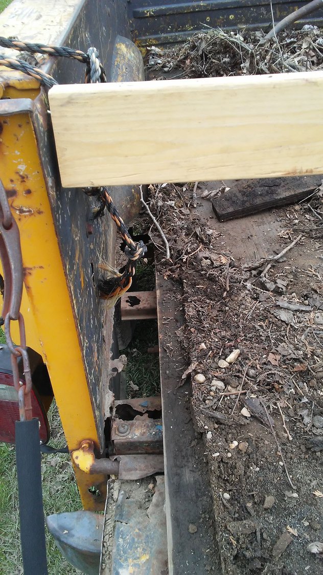

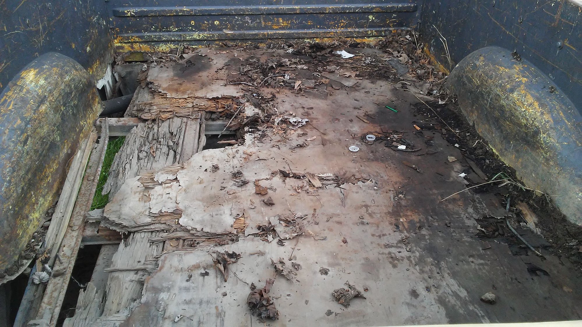

So, I picked up an "82 F100 that was owned by a city who then sent it to a camp to be used. It shows 90k on the odometer and the body is in pretty decent shape. The bed however is another story. I've seen a couple guys on here re-do theirs but haven't been able to find a whole lot. Someone did some repairs to it using old road signs to reinforce the sides a bit. Is there any significant differences between the Bumpside bedsides and the Bullnose ones? It seems that the newer model year I search the less is available. I know I can get a Ford tailgate for around $500 lol.

Yes, they're quite a bit different. The fender mounting studs are all different for one, and there's no fender hump on the inside of the bumpside panels. You could buy them, but by the time you were done making them work, you could probably get Mar-K to make you a set of "blank" sides that you could put your own fender studs in. I just bought an almost complete Flareside box for $500 bucks, and it does need some rehab work, but it is mostly complete. If you look around you will find the sides...used that is, but they are still out there kickin' around. Where are you located?

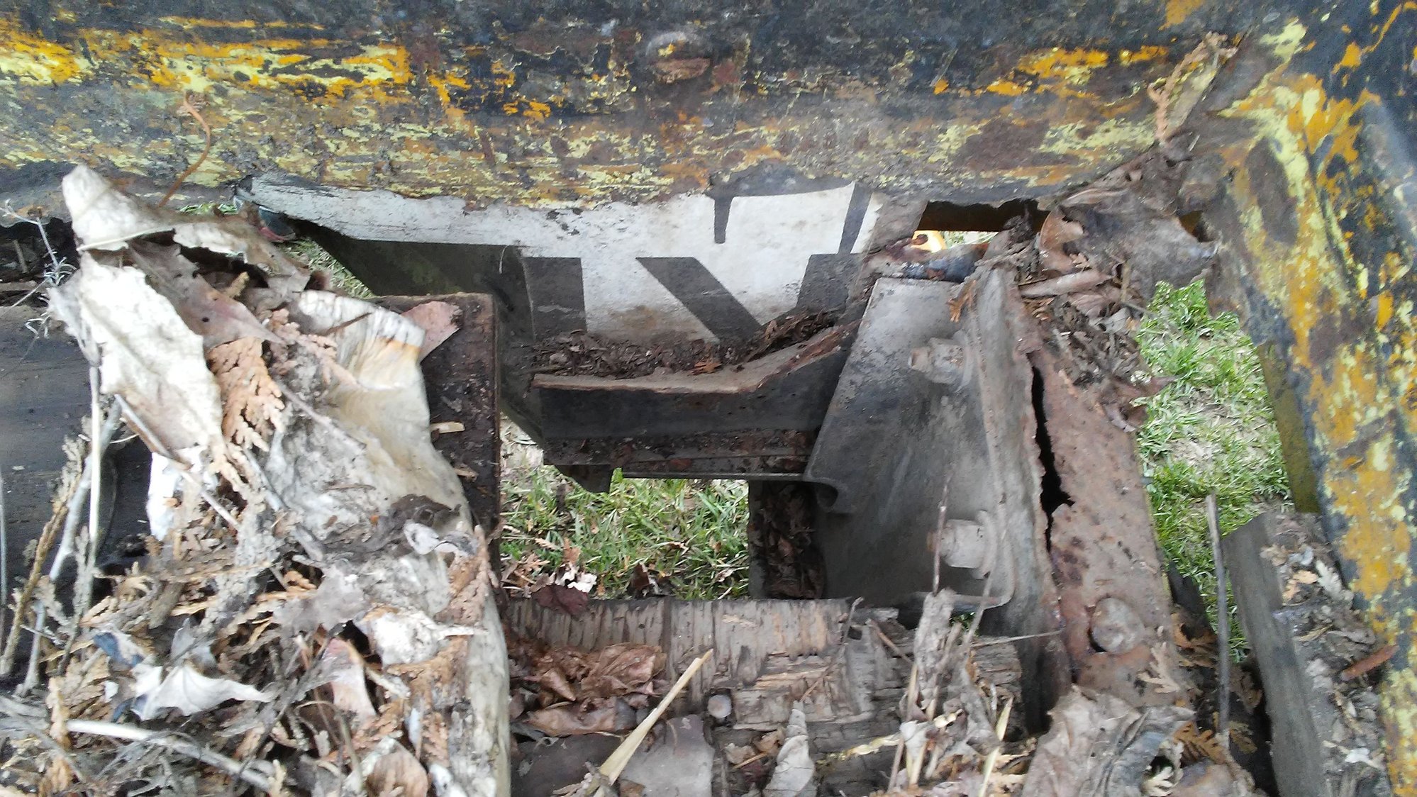

WOW! My sides were not that bad only had to fix the rear & front most lip on both sides and 1 or 2 holes on the rest.
First I go to ask what is your skill set and do you have a welder?
You can get the front & rear sills and all the cross members for about $1000 when I checked.
You saw the tail gate for $500, was that the one that had the FORD letters on it if so it is cheaper with out the letters.
You can also get the front panel or header panel think was $250?
That was as far as I went as I could not swing the $1000 for the sills & cross members.
The wood part (ply wood local) and metal strips you can also get but did not price it out.
That bring us to the sides! At first I was looking for a 90* sheet metal strip that I could over lap weld to the sides making the bends around the wheel area with shrinker/streacher I have and drill or punch the holes in the bottom side of the lip to bolt to the wood. Not being able to find the 90* sheet metal lip I looked over my sides and went a different way.
I was able to make a pattern from cardboard from what was left of my lips and used them to cut & mark flat stock that I used to fix the lips. Flat stock cut and holes made for the bolts before welding to the bed side.
On the front & rear there are flat parts that "hang down" you can see in the picture above, I just welded in patches as needed after I welded in the lip.
Primed & bolted to the floor
Now the floor.
I used a long bed style side floor in place of the wood floor and as you saw bolted the side to it ......... But it is not quite that easy! I did a lot of measuring and asking but mostly measuring to see if this would even work.
After the side were cut off and the front to make it shorter we test fit the bed sides & front panel, had no tail gate so the opening was measured and clamped to hole that measurement.
All the cross members fell in the right place but the front one so I had to drill out spot welds and move it back a few inches.
The floor was also a few inches too long so I had to cut that also. The panel just above is the outer part of the FS rear sill. I welded that to the floor to finish it to look like a stock FS rear panel.
Front header panel had rust across the bottom but because of the ribbed metal floor it had to be shorter so I cut the rust off and used 1 of the style side floor cross members I was not using to make a new lip.
Sorry none of it welded up.
Floor done and bottom side painted
I have since gotten a tail gate and because I have added duel tanks I added the rear fill door.
It was a lot of work but if you did not know it was to have a wood floor you could not tell, like the duel tanks, and how I like to do my custom touch.
Dave ----

I read through your whole thing Dave. Very detailed and informative. I'd like to keep the wood floor. I was thinking c-channel or square tube for the cross braces. Then add some angle to replace what rusted away. I may follow your lead and steal some styleside bed panels to rehab it. I only paid $166 for the truck and am not planning on dumping $1k+ for a bed. I just want to keep the flareside look.

Does it need wood blocks, can't I do something else? Seems like wood is a bad idea

The hard wood does 2 things. 1 keeps the metal on metal from squeaking as the blocks are a little taller than the channels. @ because the blocks are taller when you tighten down on the bed bolts the blocks stop you from crushing the channels.
You could make your own from hard wood or if you don't care of the noise, I don't know how much noise there is, you could use pipe to put the bed bolts thru cut a little longer than the channels to keep from crushing the channels.
The metal floor has the channels turned up and welded to the floor but it also has pipe spacers the bolts go thru so not to crush the floor.
I think Dennis Carpenter has instruction on how the floor goes together may want to get a set so you under stand how it was from the factory.
