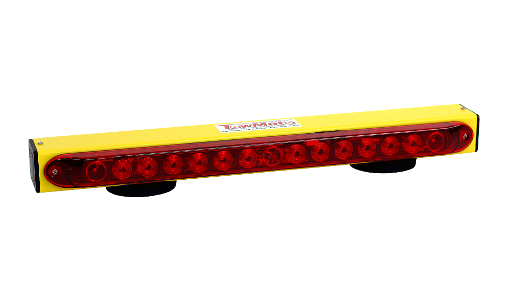

I wonder if something like this is bright enough....

http://www.towmate.com/TM22Y-Wireles...Bar_p_357.html
I flat tow and this works great on top of tailgate rail on 2 flat stock metal pcs bent to lock in tailgate stepName:  photo690.jpg
