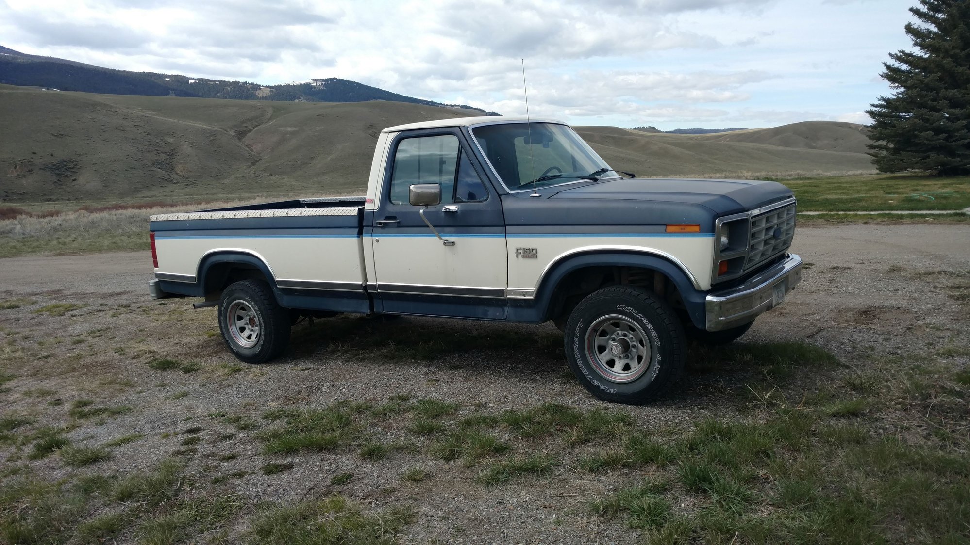

Recent rebuilt the transmission and Tcase. Cruse control always worked fine but at times it surges somewhat. No surging with CC off. Obligatory picture attached.
