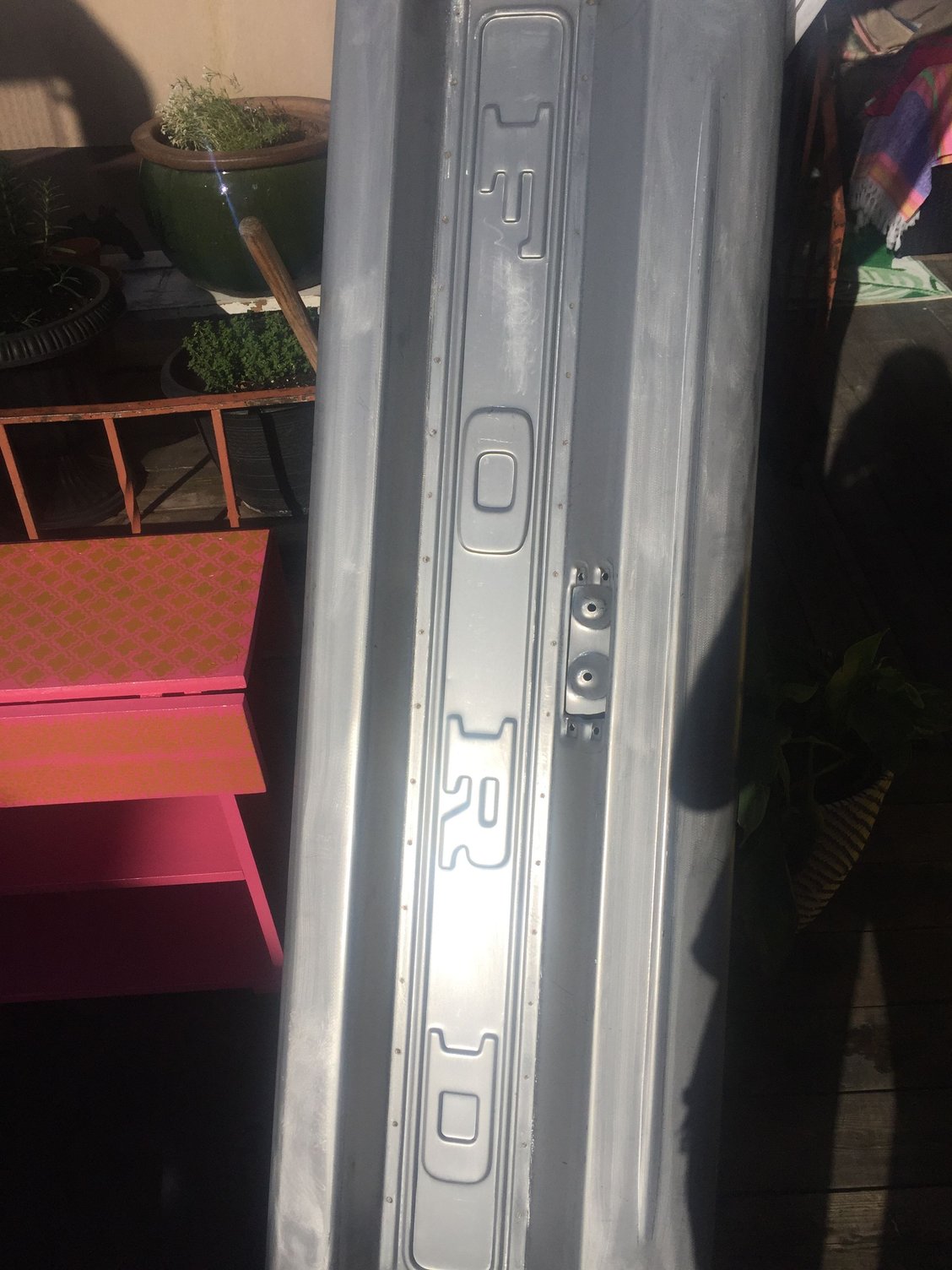

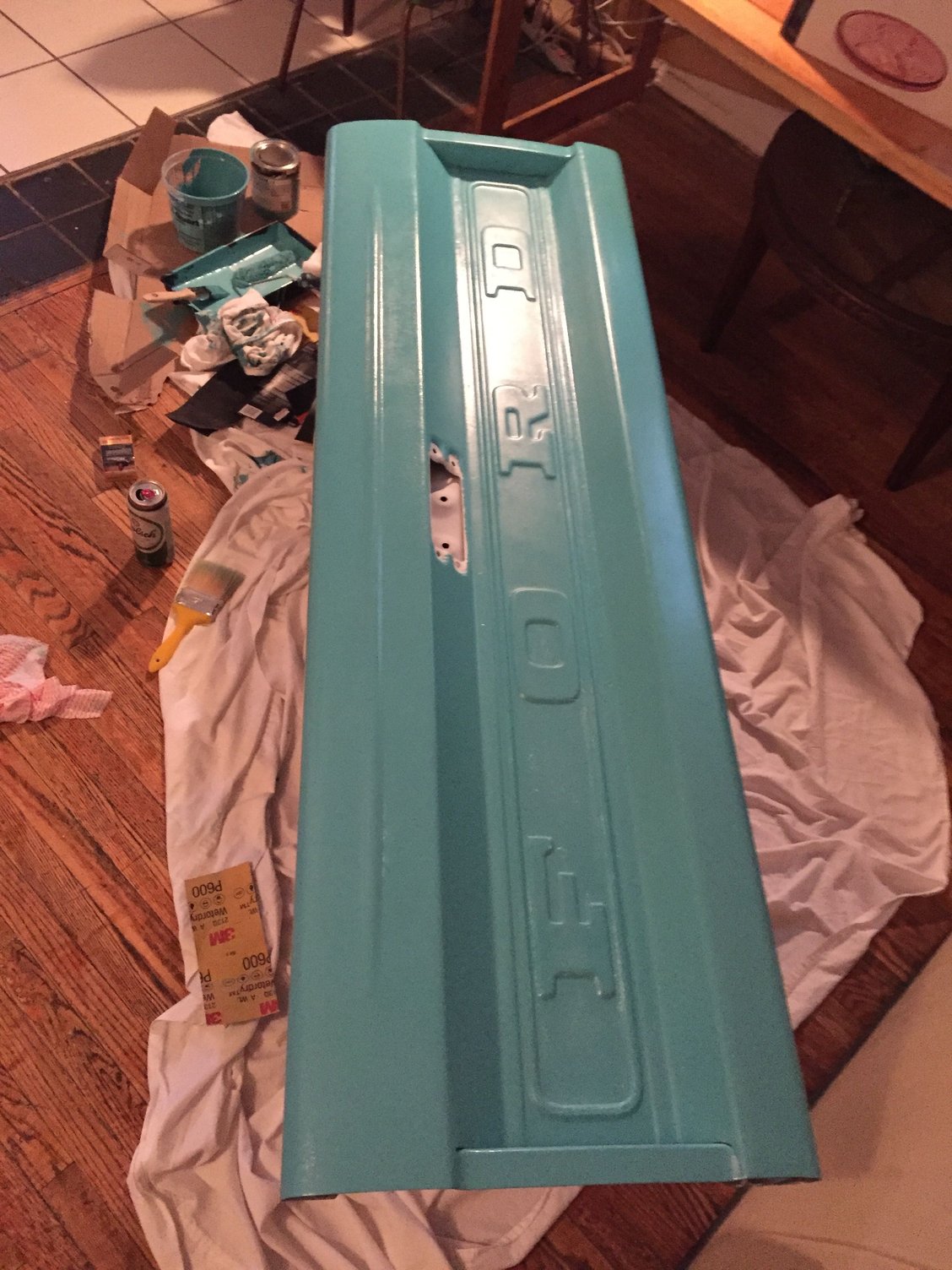

I fired up the paint on the tailgate last night. Worked out well, had a little mishap with a cheap roller which was a bummer but it worked out in the end. A little pebbling and totally not a pro job but it will still be the best painted part on the truck! From 5 feet away it looks great. Here is what I did:
- Sanded with 80 in spots where the welds were
- Sanded all over with 600 grit
- Ignored the spots that I could have bondo'd
- Washed the whole thing down with rubbing alcohol
- 2 coats of high build primer
- 4-6 coats of paint with 15% diluted thinner probably 30 mins between coats at the maximum
- Let sit over night and now its out in the sun getting some warmth
It was super fun, done in my apartment living room. Can't stress enough that you have to ventilate as best you can. Paint thinner and beers is a cruel mistress if you don't ventilate. I have a piece of moulding on my old tailgate I would like to put on the new one. It doesn't seem to want to pop off, if anyone has any ideas about how best to approach this it would be great. Their aren't any screws or anything that I can see to unscrew to get it off. Thanks guys.
pre
mid
post
