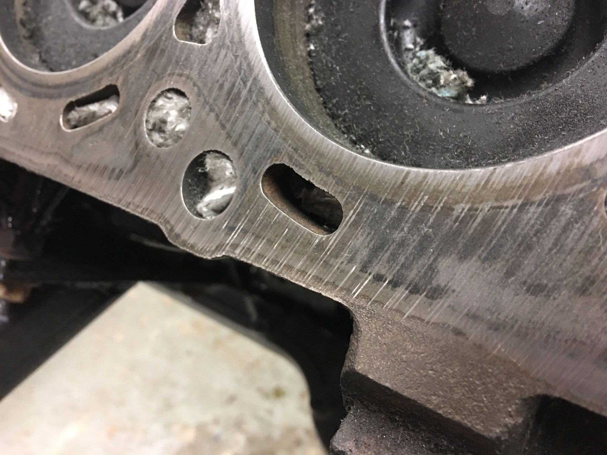

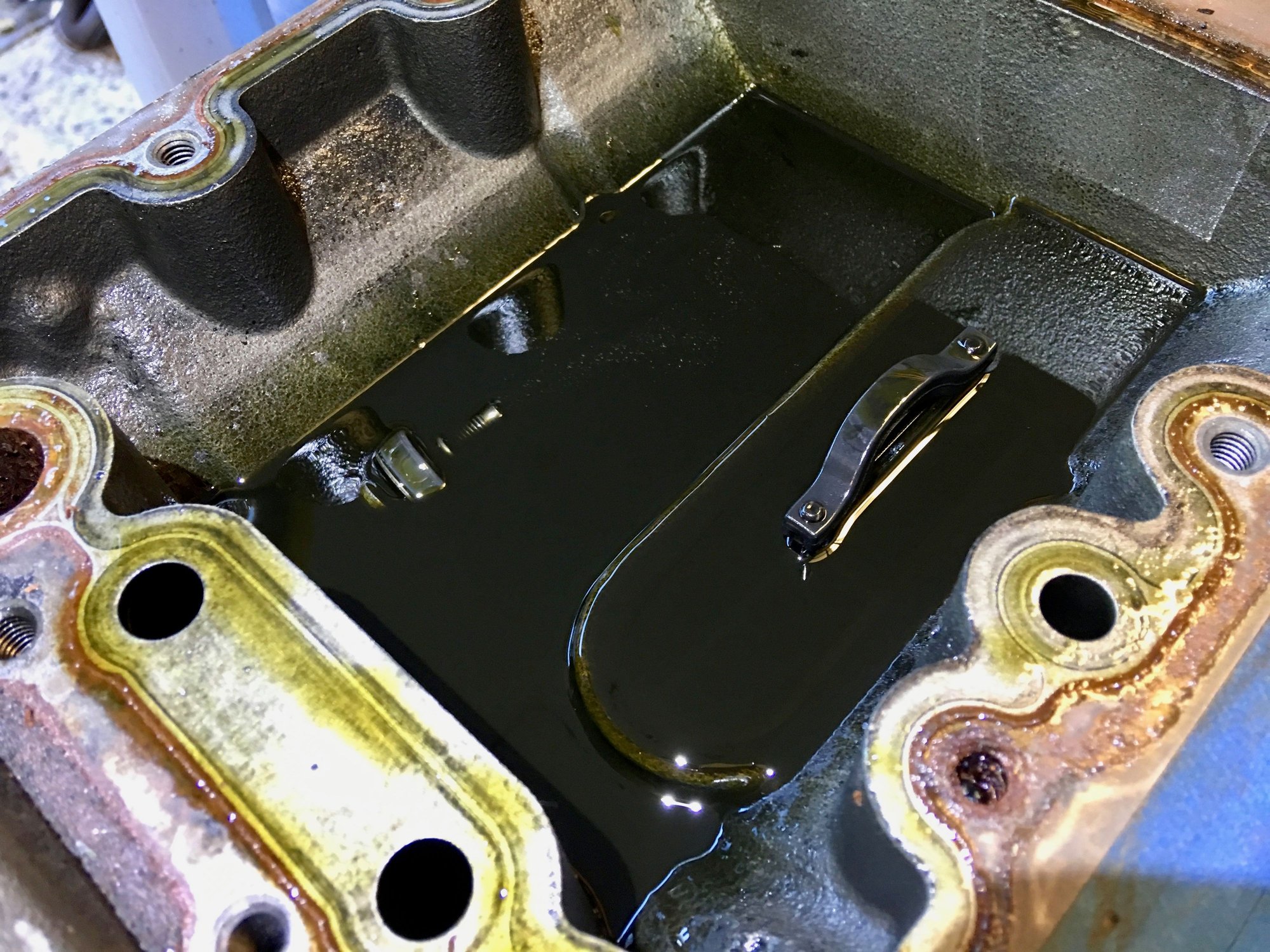

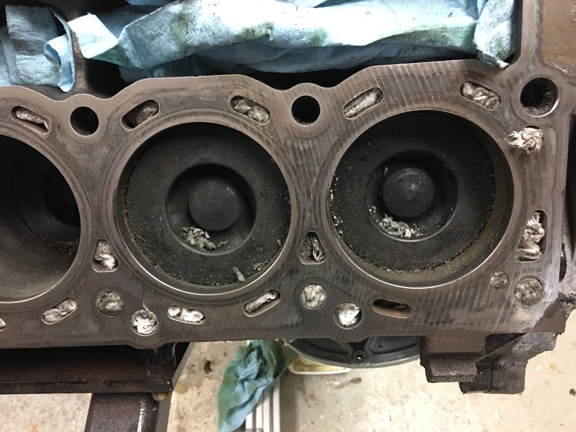

Oh, I'm a little unsatisfied once I opened mine up.
Decks with a surface finish well exceeding 60Ra. One side cut with chatter, the other looks like it was grit blasted clean but never re-machined.
And the cherry on top of the whip cream, loose parts in the sump.
