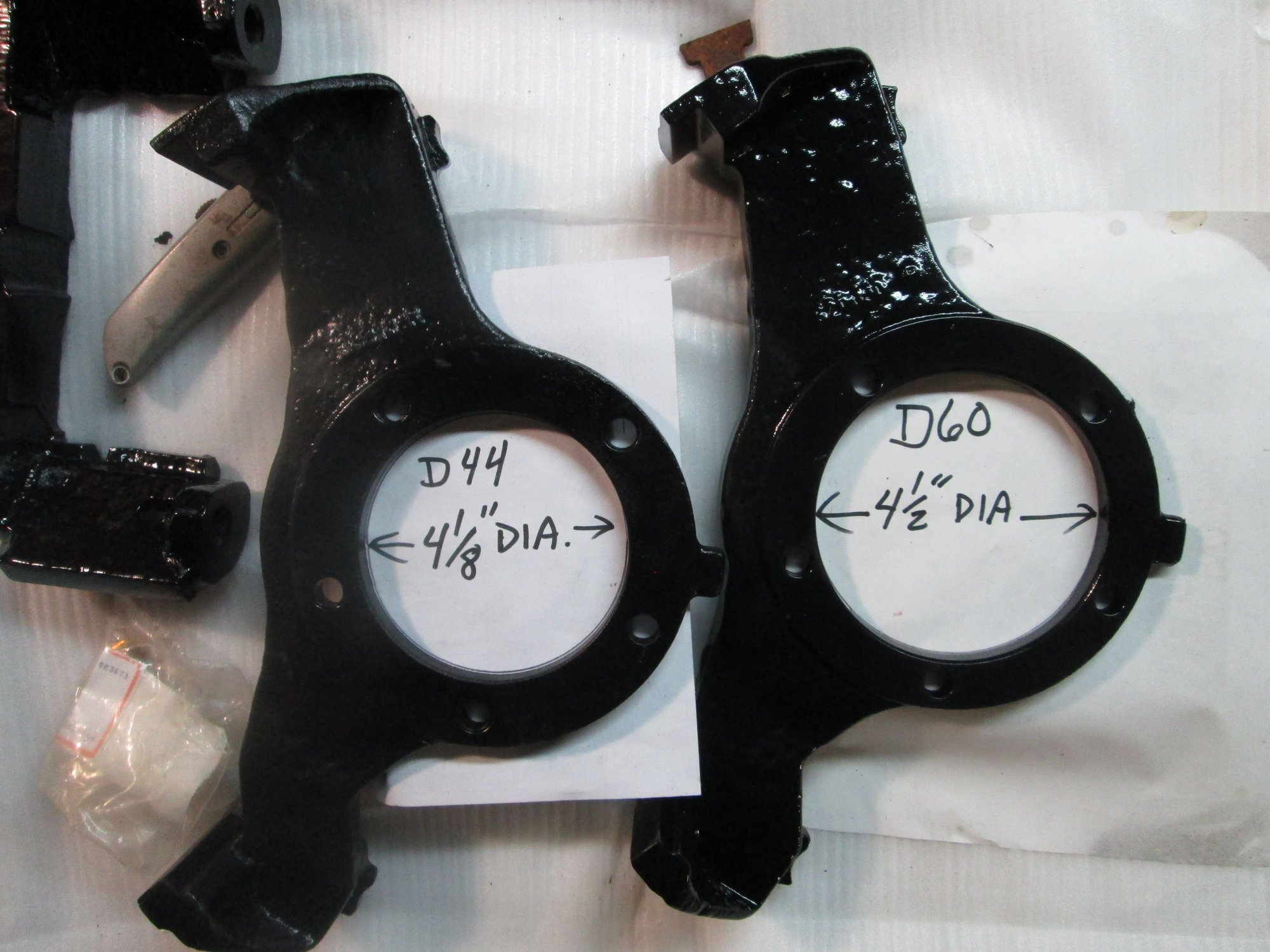

Let me post up a picture of the D44 and D60 brackets.....I'll get the distance between the bracket seats in a few.....

I'm not sure from where you took your measurements, sorry. On mine, measuring from caliper lip to caliper lip - the outer most caliper seat - is 10 3/8."
I can get a better picture (with a tape/rule) if need be. Your brackets appear to be smaller than mine...mebbe it's because mine are nekked and yours are in operation? Mebbe you do have the single piston caliper 'cause you don't have a HiBoy.....
