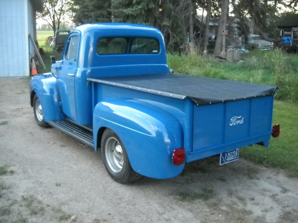

Mr. Parker did his with sideboards, heavy vinyl and snaps. The convex shaping is held by aluminum bar stock,
about 1 and a quarter by one eighth, bowed across the width and held, bent, in place by little end-stops. It all works
great except when the vinyl starts to shrink, and the neighbor's cat decides he loves the truck more than I do,
that is, he gets is beauty sleep lying on the cover. When the bow strips decide to collapse from his weight, it does
make for some interesting cat-videos....
