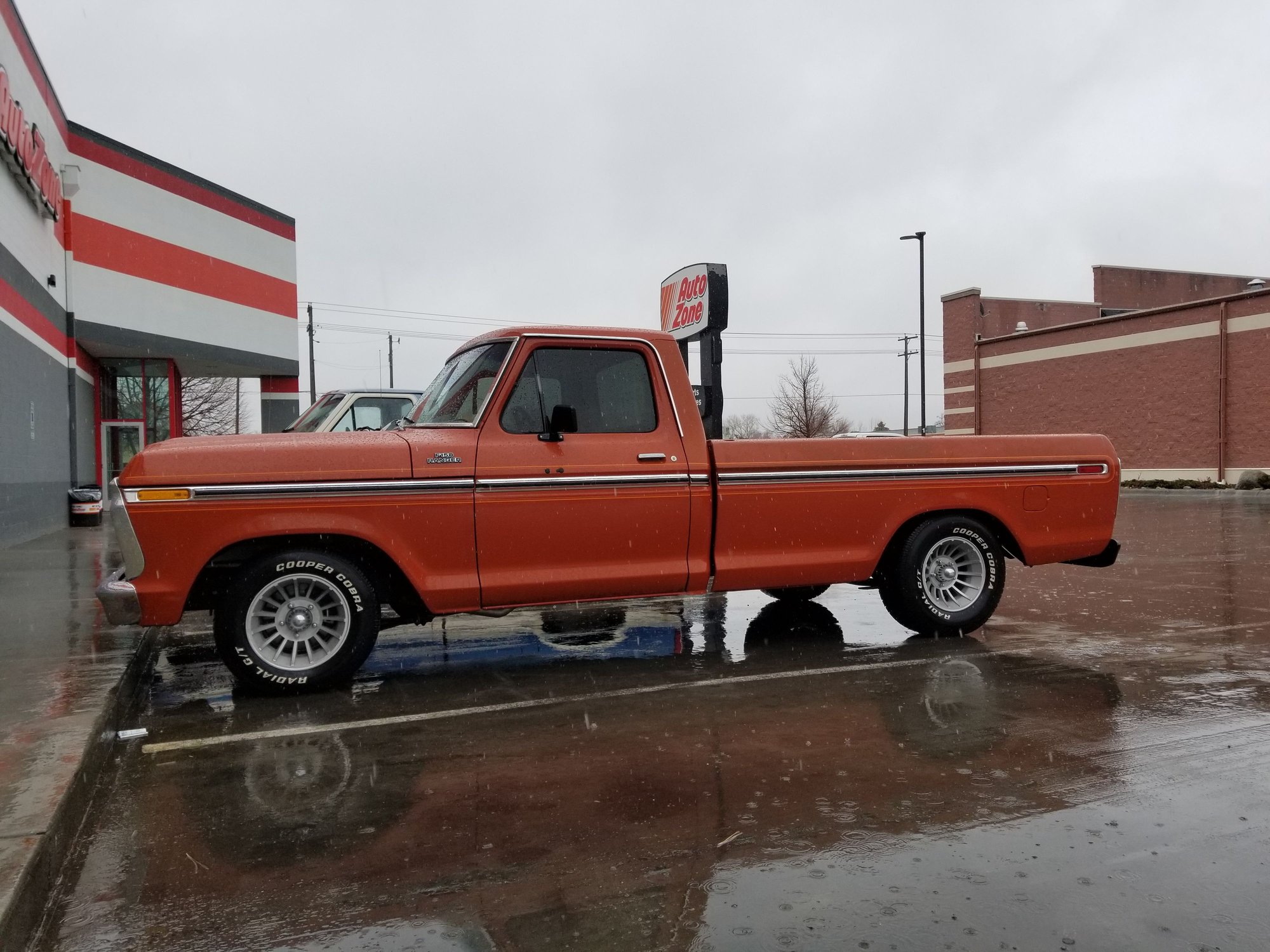

77 F-150 2wd, 400 c6. Had a kickdown rod stock but can no longer use it; the FiTech throttle body doesn't have linkage for it. Using the Autoloc kickdown cable setup.
I thought the truck is in my signature but can't see signatures on my phone.
