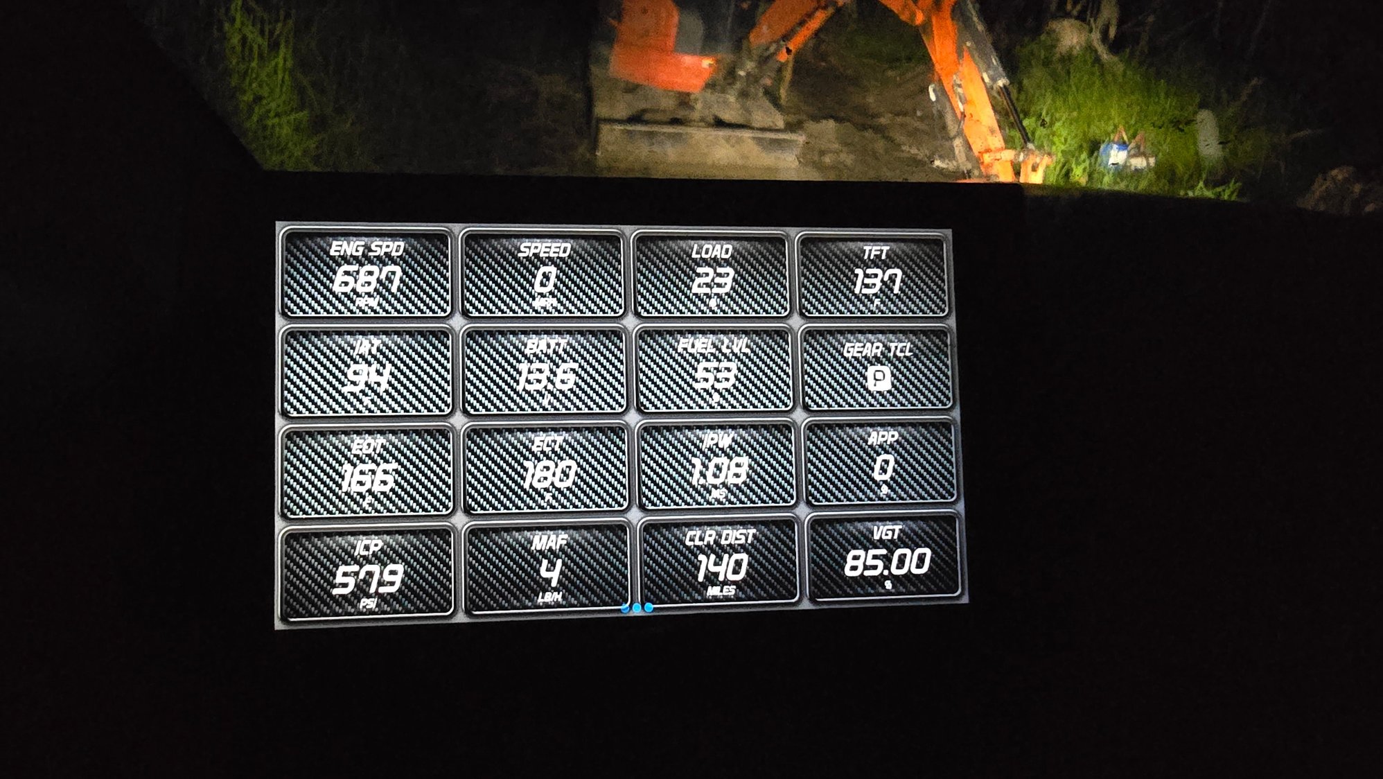

I've chatted with you a few times on a few different platforms. I'm really struggling with a situation. It's been a few months since we last spoke. 2006 ford f350 swd. larriat fx4 6-1/2 factory bed. ... does not have factory bed. Has 9ft flat bed. Overlaod spings and shocks. Welder, tools and tool box. Total gross weight is 13,500lbs l. Edge evolution. Kc stage 2 turbo. New ficm. We last spoke about my eot and ect being significantly different. You suggested to replace the sensors. I did. I'm still having the same issue. However. The oil temp isn't as lazy as it was. But my oil temp never gets over 185. But my coolant temp is on average 25-32 degrees above my oil temp. Now, I've put new oil cooler in. Has about 3000k miles on it. Change coolant filter frequently. Using ELC coolant. Head studs ford gaskets. All recent within the last 8k miles. And have had this issue the entire time.Now when I first fire it up. Oil temp is always warmer than coolant. By a few degrees. Once coolant warms up. They are l9cked together untill oil temp reaches about 170. Then coolant starts go up. And it goes up gradually. On the freeway running 70. My oil temp is 167-180. And my coolant temp sits between 204-208. . 208. Fan kicks on, oil temp drops. Like it should. I live on a grade. On my way home it's gotten hot a few times, depending how hard I'm driving. I've just been playing with it to get data, the grade is about 3 miles long. I have seen as high as 235 coolant temp and 200 oil temp. That's running 70 up the grade. On average with tow hual on. And crusing 45, it runs 212-215 coolant and 175-180 oil temp. Everyone says 15*point spread. But as far I understand that only apply to oil temp being higher than coolant temp. I do believe I have a leak in my heater core. Because I smell coolant when heat is on. And occasionally I have to put about an ounce of coolant in to top off. So it's not substantial. Now going hack to the 15* delta spread. Everyone says unloaded do a freeway run. Should be 15*. That's not an option for me. Bed is welded to frame. Welder is welded to bed. So I guess my question is . Given the weight of the truck. Would that be considered under a constant load? I'm mean it it be like a stick truck dragginga n empty car trailer around. And if it under constant load. Would the deltas be concerning given that the cool8ng system if functioning as it should. And oil temp isn't going over temp. But devils advocates says that if oil temp isn't up to temp then I'm chasing harm. Because oil viscosity hasn't reached optimum parameters. I'm gonna drive it untill blows. But I mean this has been driving me nuts. I'm afraid to to my excavator. I'm afraid to tow anything. . A penny for your thoughts.
This was 5min after returning home
This was 30min after retuning home. Letting idle
Old Jun 20, 2024 | 05:55 AM

Old Jun 20, 2024 | 06:02 AM
bismic's Avatar
bismic
Joined: Nov 2003
Posts: 27,931
Likes: 3,653
Sorry, I need reminders ...........
Didn't you say your oil cooler is still an "oil-to coolant" cooler (OEM style), not like the air cooled one from Bullet Proof Diesel?
What scan tool are you using?
Where did you buy the sensors?
Disconnect the EOT sensor and then report what the oil temperature reading does. On every engine I have looked at, it is the coolant temperature that experiences the more rapid increase in the first phases of engine operation. Then the oil temperature reaches, and then exceeds, the coolant temperature before it stabilizes.
My truck gross weight is about 9500 lbs. now, so it is always a bit loaded down, but clearly not quite up to yours. Still, an extra 4000 lbs isn't a crazy increase.
As a reminder - the theory behind the "temperature differential" is just to use as an evaluation of the health of the oil cooler. Obviously you want to control the ultimate oil temperature itself, but the differential across the "plate style" oil cooler can also be an important indication of the mechanical stress that the cooler is seeing (thermally induced). The 6.0L sure did see a LOT of oil cooler failures in the early days. It wasn't always just about gasket quality (but Dorman sure showed us their capabilities when they put out their product, lol).
Also, just curious - What fan clutch are you running?
