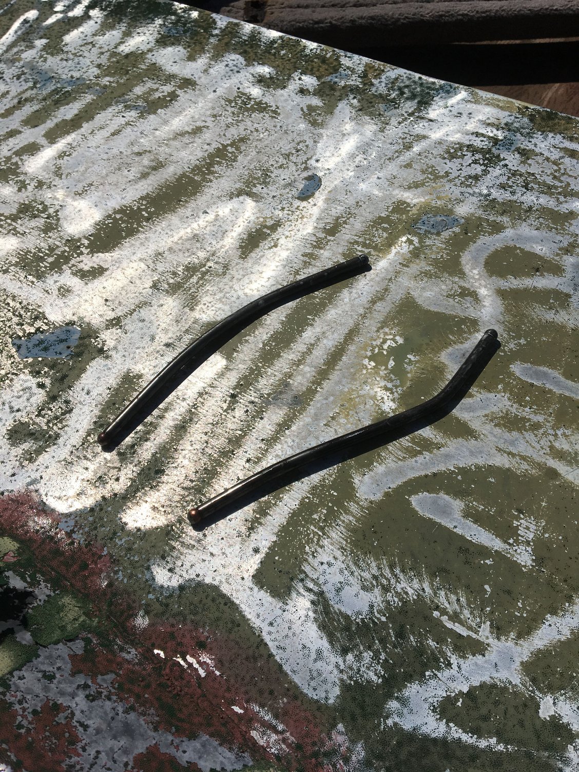

Just pulled the valve cover on the passenger side and have 2 bent push rods on the no. 5 cylinder

Seems to be a bunch of these lately.
