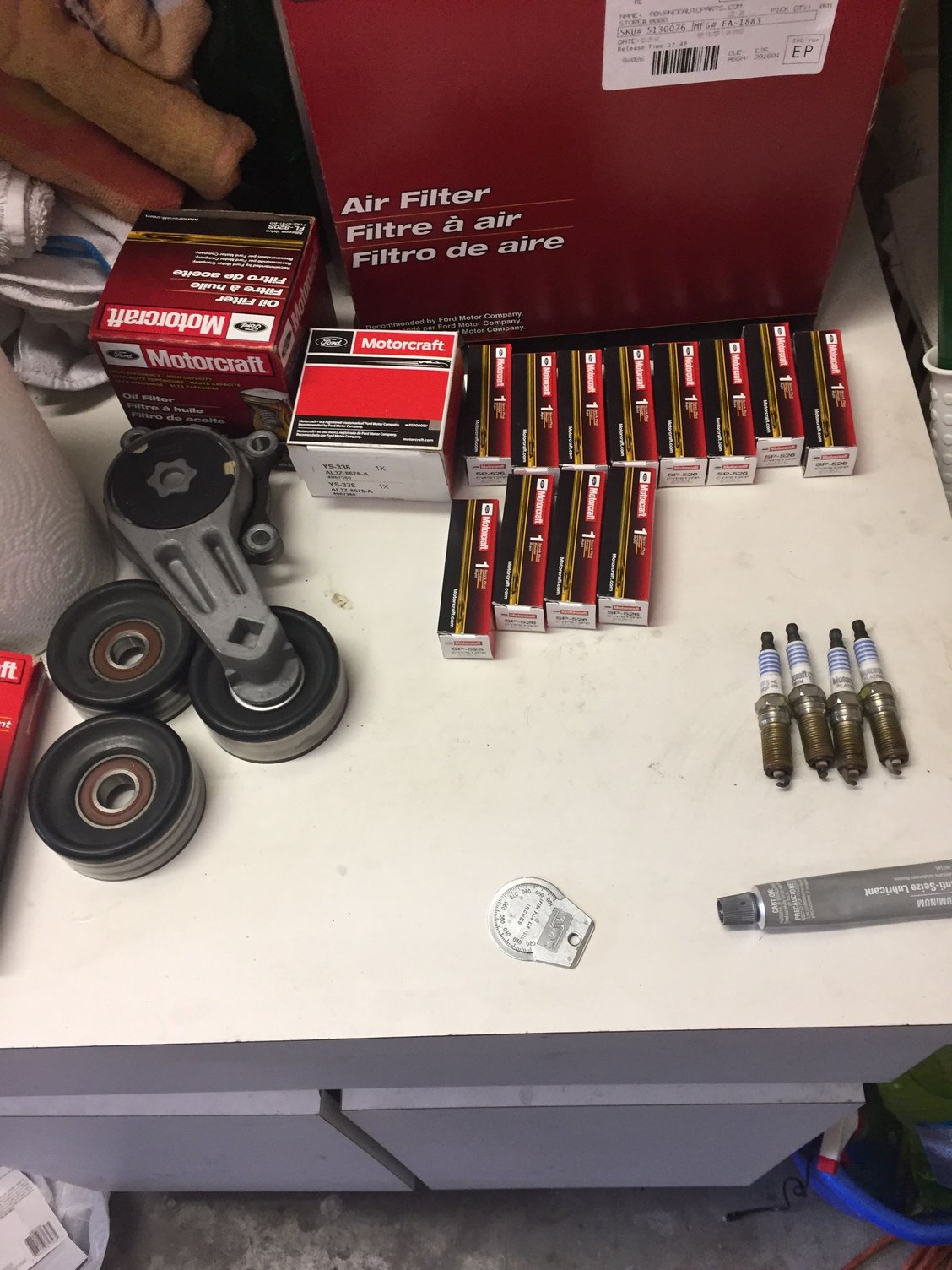

My 13 has 84k and change on it now so I wanted to get some pm taken care of because I know these trucks will kill the cats if the plugs get weak as they get close to 100k.
i did a bunch of stuff today, belt, tensioner, idlers, air filter, sway bar end links, oil, transmission and transfer case in addition to the plugs.
The top plugs come out relatively easily, you just have to take stuff off to get to them. The bottom plugs are much easier if you take an extra 15 minutes to pull the inner fender liners.
i got all the top plugs done and started on the lower ones on the passenger side when I came to #3 and it snapped off in the head. After crapping my pants, I was able to get it out with a punch and a bolt extractor.
As as best I can tell, that plug gets some spray from the wheel. It was the only plug that was rusty (I’m in FL and this truck has never seen salty winter roads).
Just a heads up to anyone attempting this.

How big of a ratchet or breaker bar did you use to take that plug out that snapped?

The shell of that plug was most definitely rusted and looked like it was hanging on by a thread. When you barely put any force on the ratchet and it simply snaps, there was something wrong with that plug.
None of the others were like that and all came out of the warm engine like butter.

OP - all the other plugs look fine at the swedged junction. I suspect that was a manufacturing defect issue that was just lurking. Probably would have happened at 35k or 100k. Look like a gap allowed general corrosion to set up and then it was just a matter of time.

to the "OP".. the rust on that one plug... is a defective plug...

...and yes to those saying the plug was defective, I had already understood that. Thanks!
