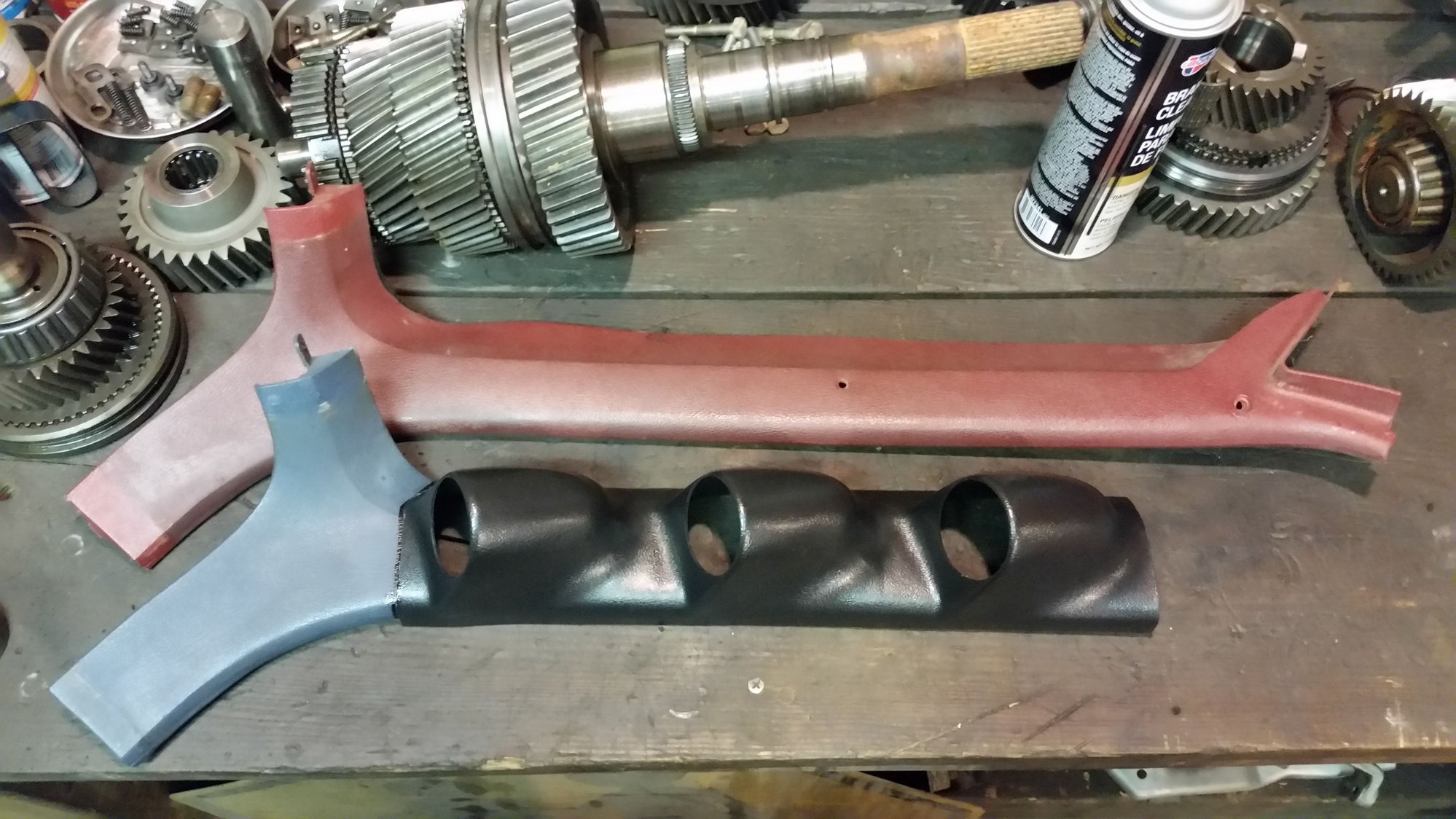

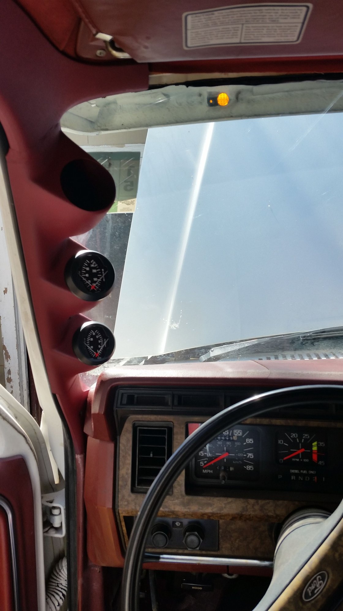

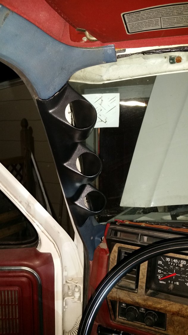

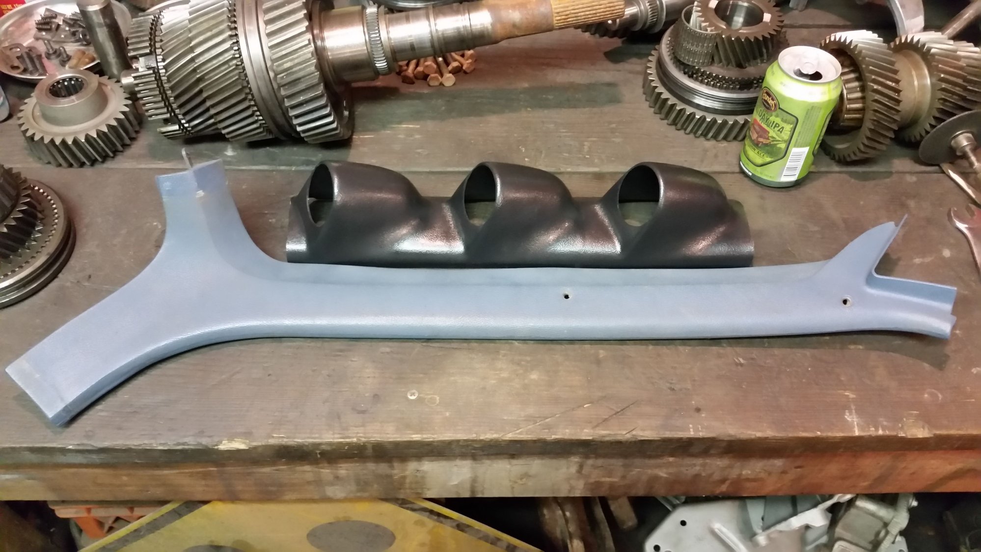

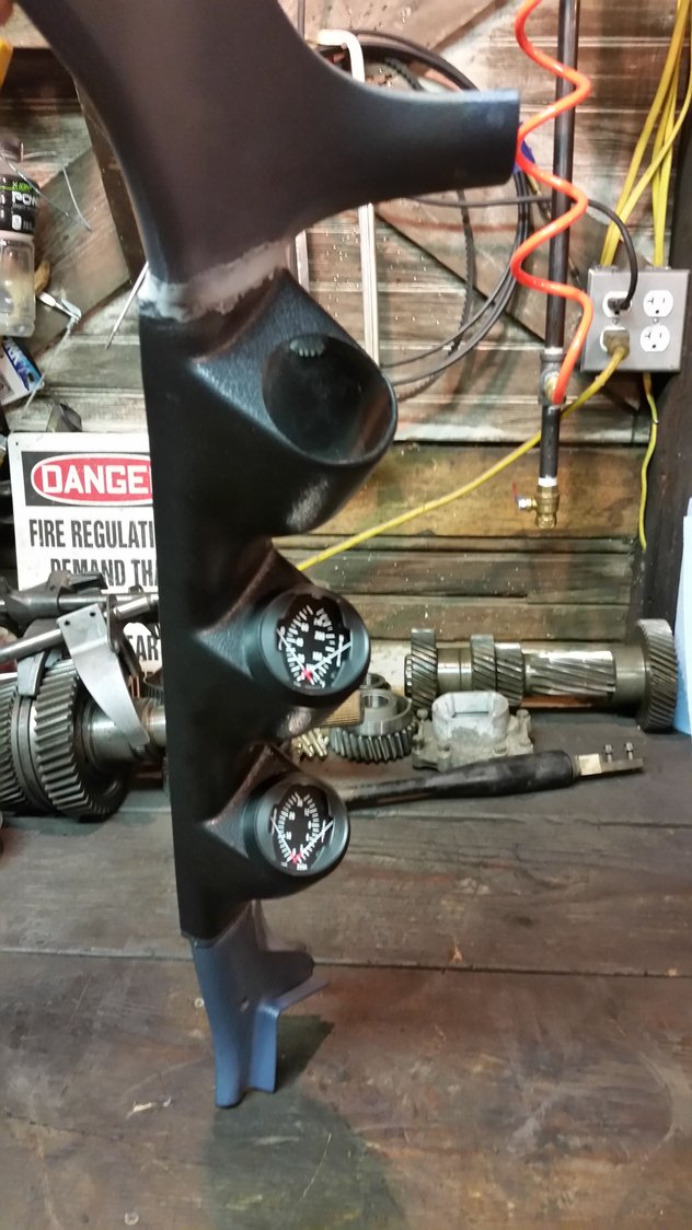

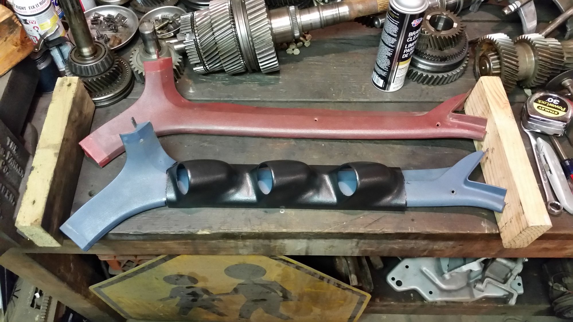

It's relatively easy to make a '92-'97 pillar pod fit. I used a Glowshift pillar (https://www.glowshiftdirect.com/1992...le-pillar-pod/).
Cut the ends off, law it over your original A pillar trim and mark where to cut. A few dabs of superglue to hold it together, then fiberglass with mat and epoxy resin on the backside. I used PlastAid to bond the front and mold it to match the old shape to new. Drill the hold for the center retaining screw and chamfer it. It came out well enough for a daily driver and with some practice could be matched better.
