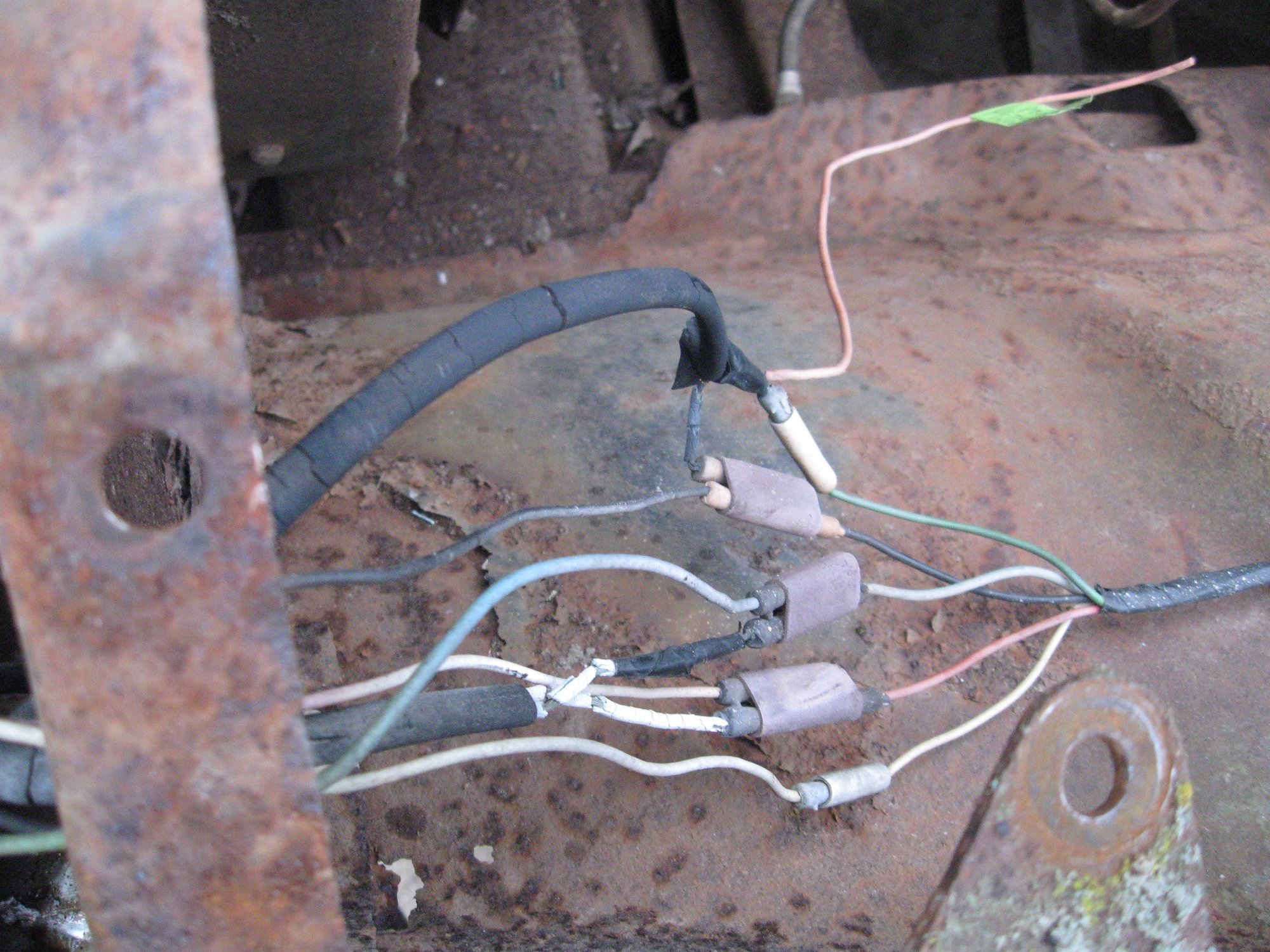

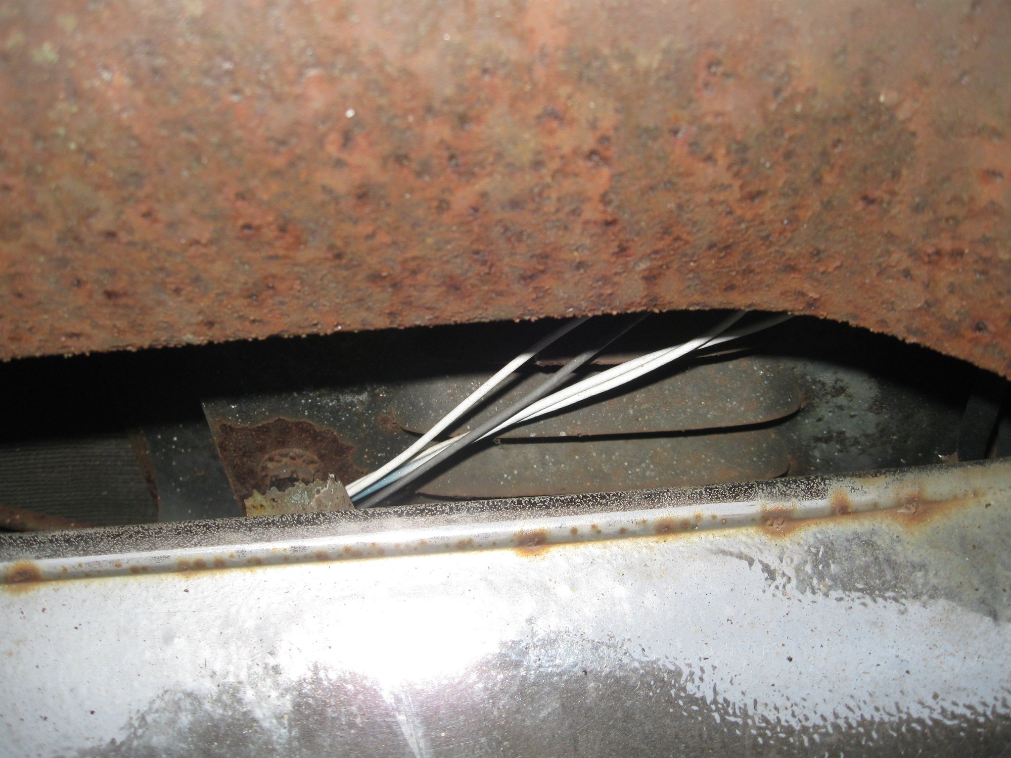

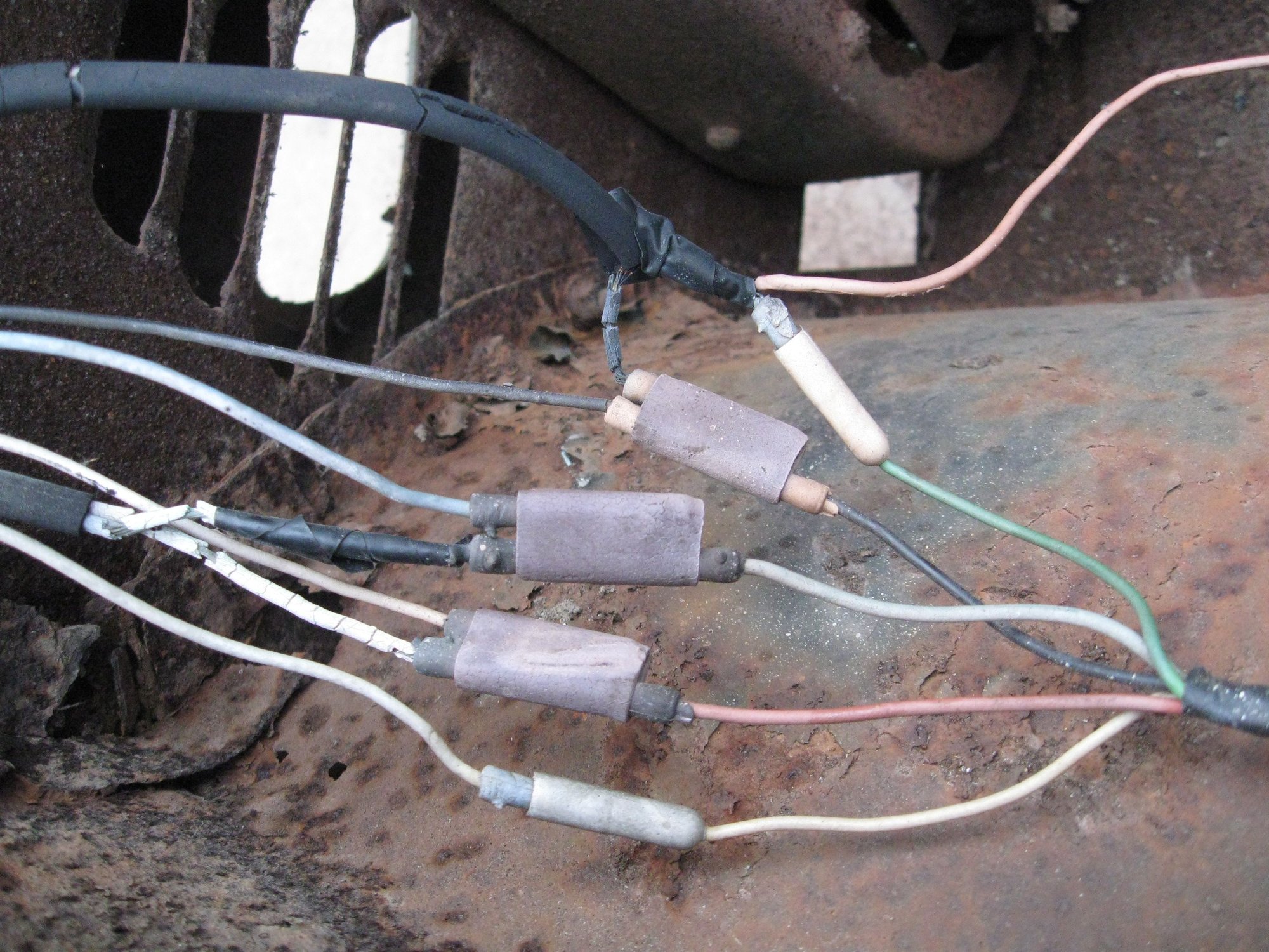

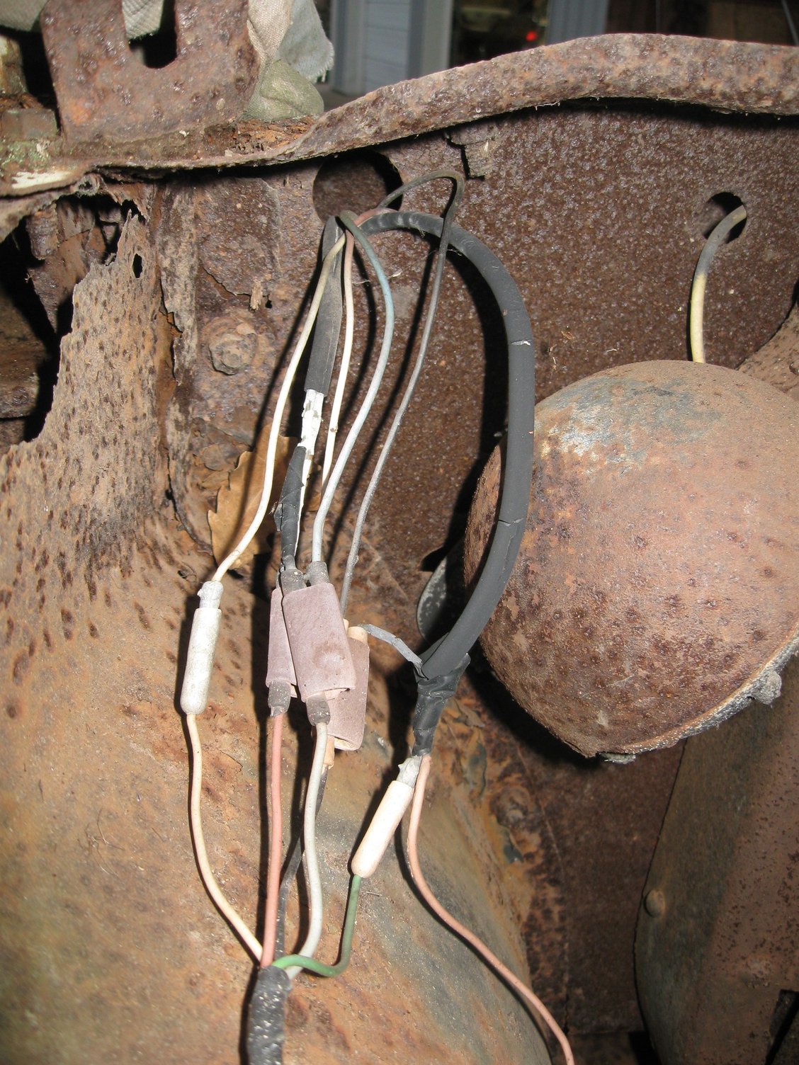

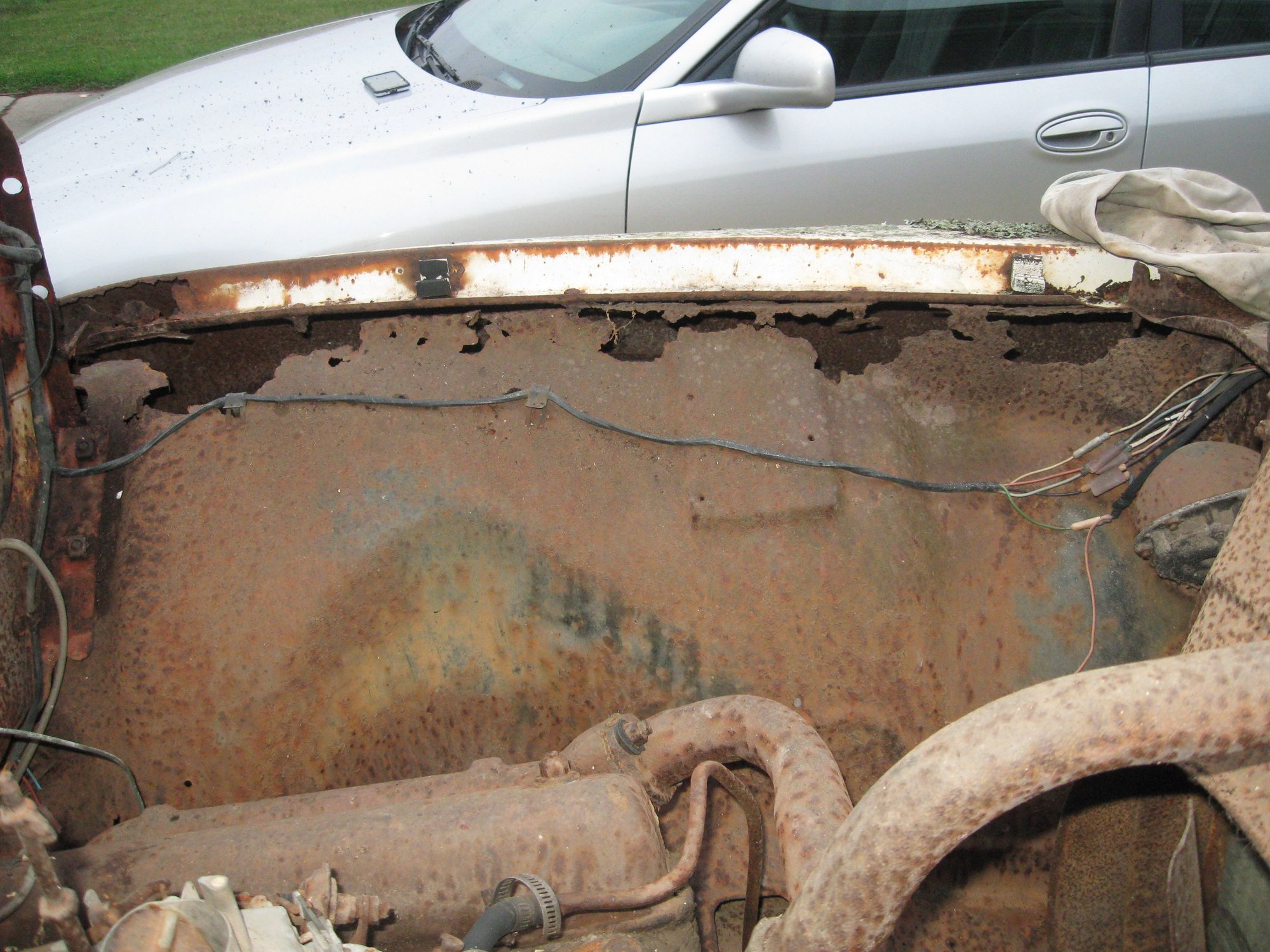

I'm at the same spot installing mt headlights/grill/parking lights. I have a Mid Fifty original style wiring kit. I know the wiring I removed off a 56 F350 all plugged together above the left inner fender way towards the front under the hood. Then the headlight harness went thru about a 1" hole in the sheet metal piece outside of the radiator support to the left lights and across behind the grill to the right lights. The horn wires came from the generator/ voltage regulator on the right side. Hope this helps.I'm gonna see if I can find the pics.

Looks spot on Greg That is some serious RUST though I wish I would have taken more pictures when I took mine apart. My horn wire also went around the passenger side. Only one horn. Hopefully getting to mine sooner than later!
