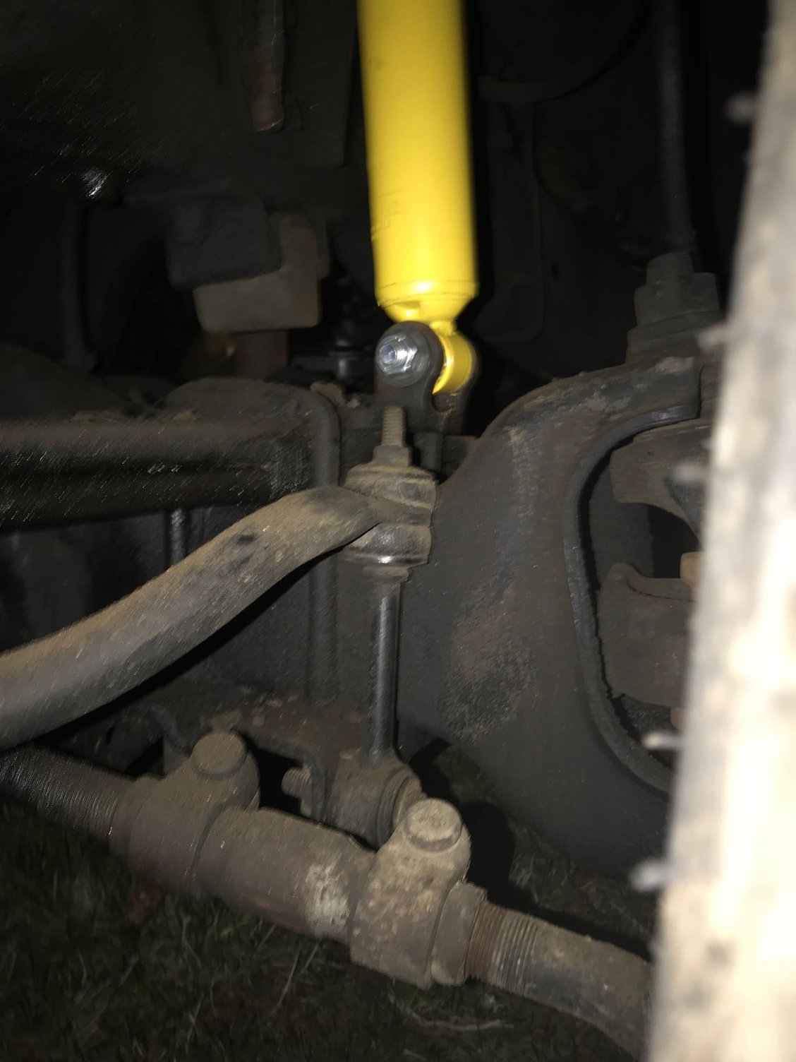

Driver's
Passengers, shock mount broken off
Here is what it all looks like.

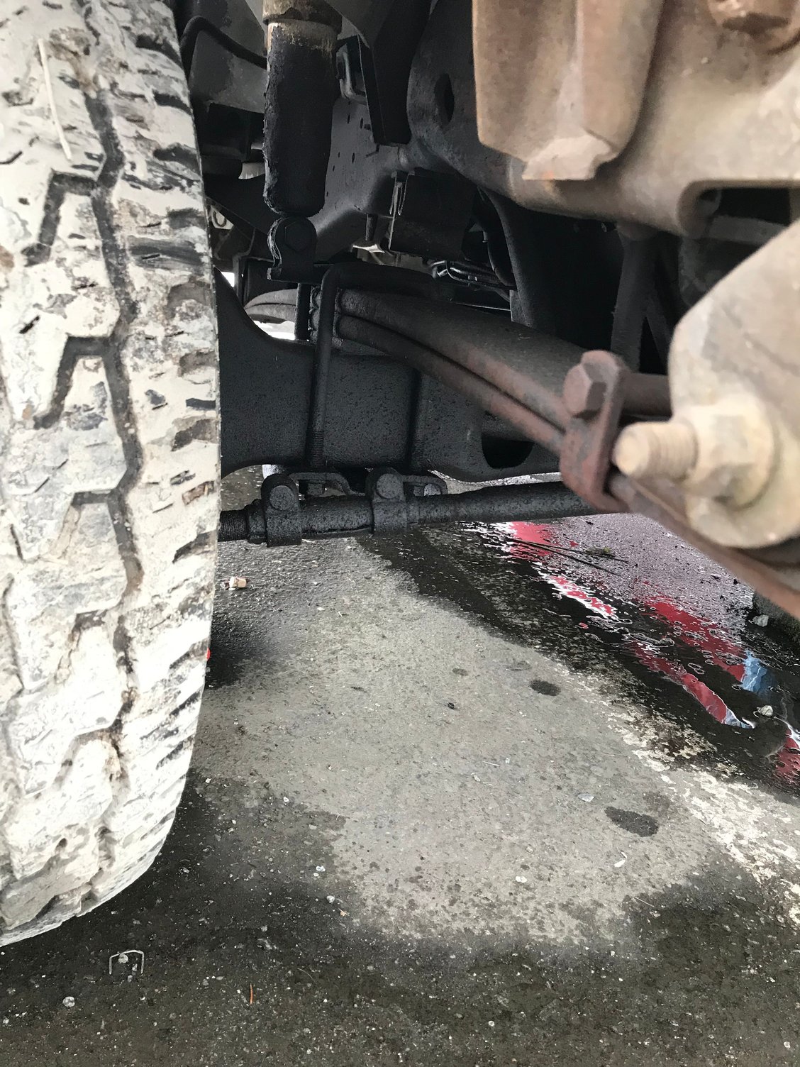

The sway bar has shifted to the drivers side it has pulled the insulator with it on the passenger side as seen in the photo.
What has happened here is with out the shock on the passenger side the sway bar has in effect been acting like the shock and has caused it to shift over to the drivers side.. This not uncommon to happen on the 4x4 TIB if one shock goes bad or in this case is missing. Had the same issue my self on the 89. But it did not get over far enough to impact the spring.
We could do with a pic of the driver side sway bar link. But the passenger side link looks ok.. If the drivers side link is ok, not bent and with no cracked bushings it should be ok to use. If it is not ok replace both passenger and drivers side swar bar links. Regardless Personally I would just replace them both to make sure the as the current ones will have had the rubbers way over stressed. . Also given it is like $30 for the pair it best to just replace them .
The fix ,
Replace the broken shock mount, and replace both front shocks with new ones
Unbolt the sway bar mounting brackets from the frame. Re-position the insulators in their clamps if the one is damaged replace both. Recenter the sway bar and bolt it back to the frame.
Replace sway bar links as needed but it is advised to replace them.
The spring locator can be beat back in to shape and position. A good sized spot weld on the broken side spring locator will fix it up just fine. Don't weld the spring or on to the spring just the locator.

I tried to post pictures of all of it. Here is the drivers side.
