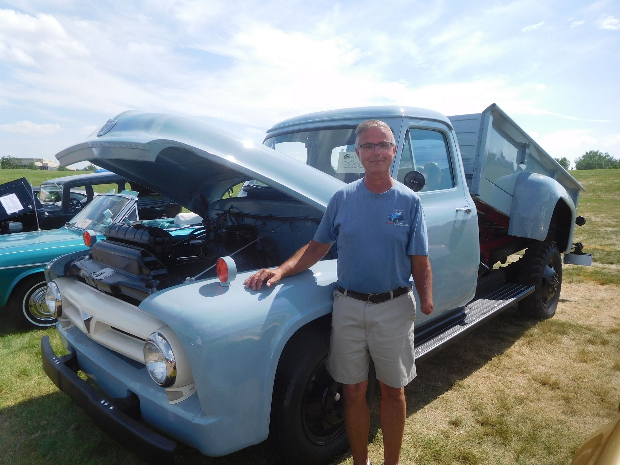

Dave,
I do a lot more reading than posting and I don't post many pictures. Last summer our tonner was basically completed (they are never done). I said OUR tonner because my wife was very hands on involved as we did much of the restoration work together. I have enjoyed following your project because of lots of similarities in trucks and the stories behind them.
Grant

abe's Avatar
abe
Joined: Dec 2000
Posts: 25,376
Likes: 5,386
From: Central PA
Grant, that truck looks awesome! I like stock trucks you know! You got to show us more pics and tell us some history, please.

fish pond's Avatar
fish pond
Joined: Sep 2017
Posts: 385
Likes: 29
From: Pinckney Mi.
Grant, your trucks a beauty! congrats to you an your wife.
Greg
