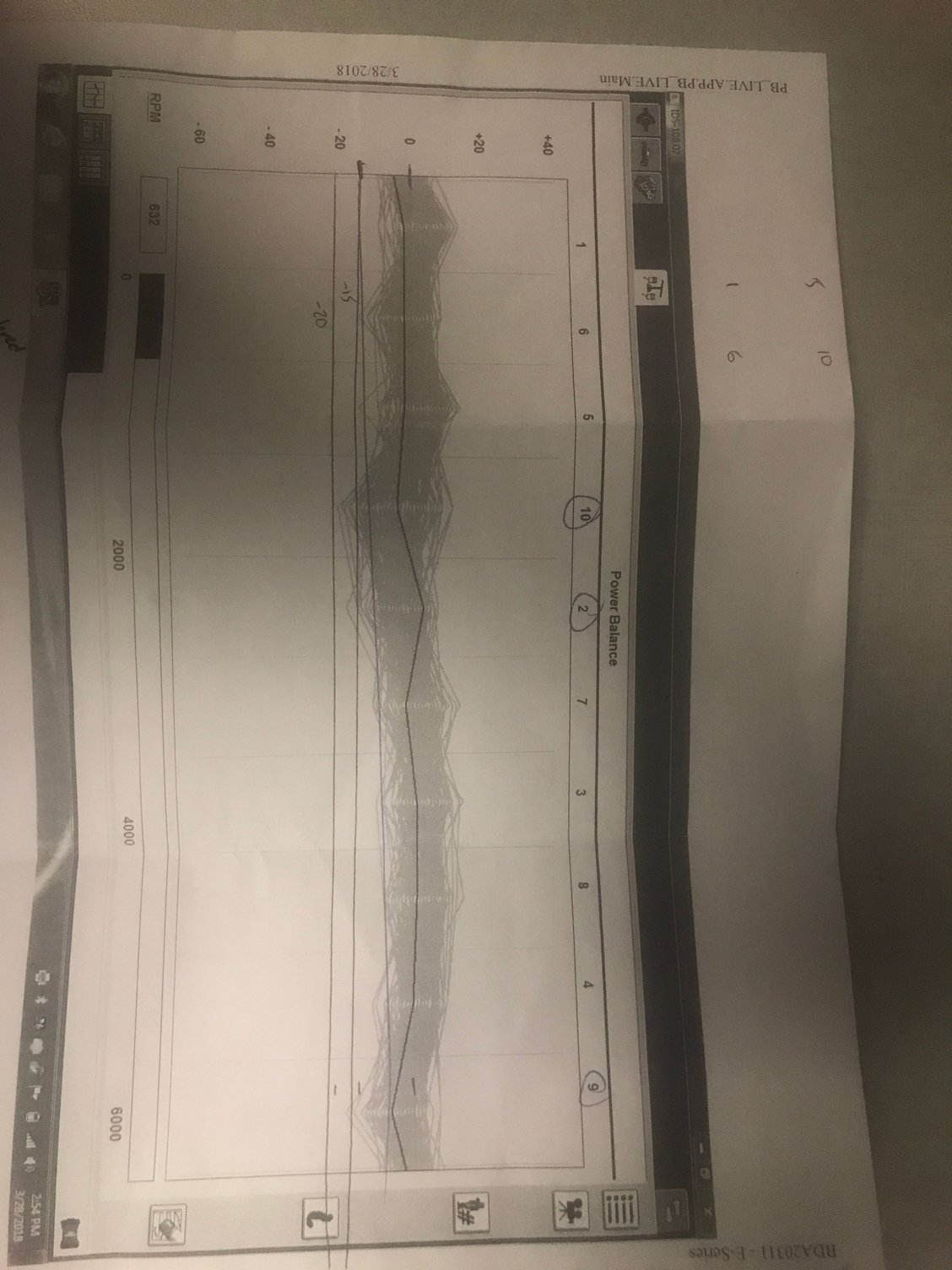

Reading a power balance test
Hi all. I have a rattle or predetonation ping at high rpm under load. Ford did the test on this and this is what it looks like. They said van is not worth the money to fix with this issue. 2011 Ford e350 v10. Noise seems to go away with higher octane. They said cylinders 10 2 abd 9 are misfiring. And 6 5 7 are close. The compression test came back with 0% for all cylinders.

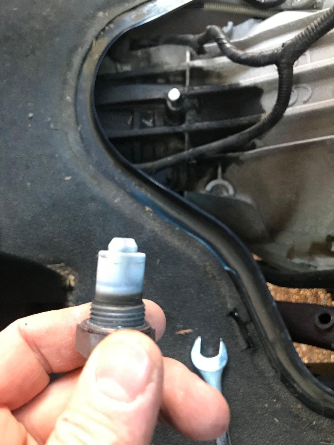

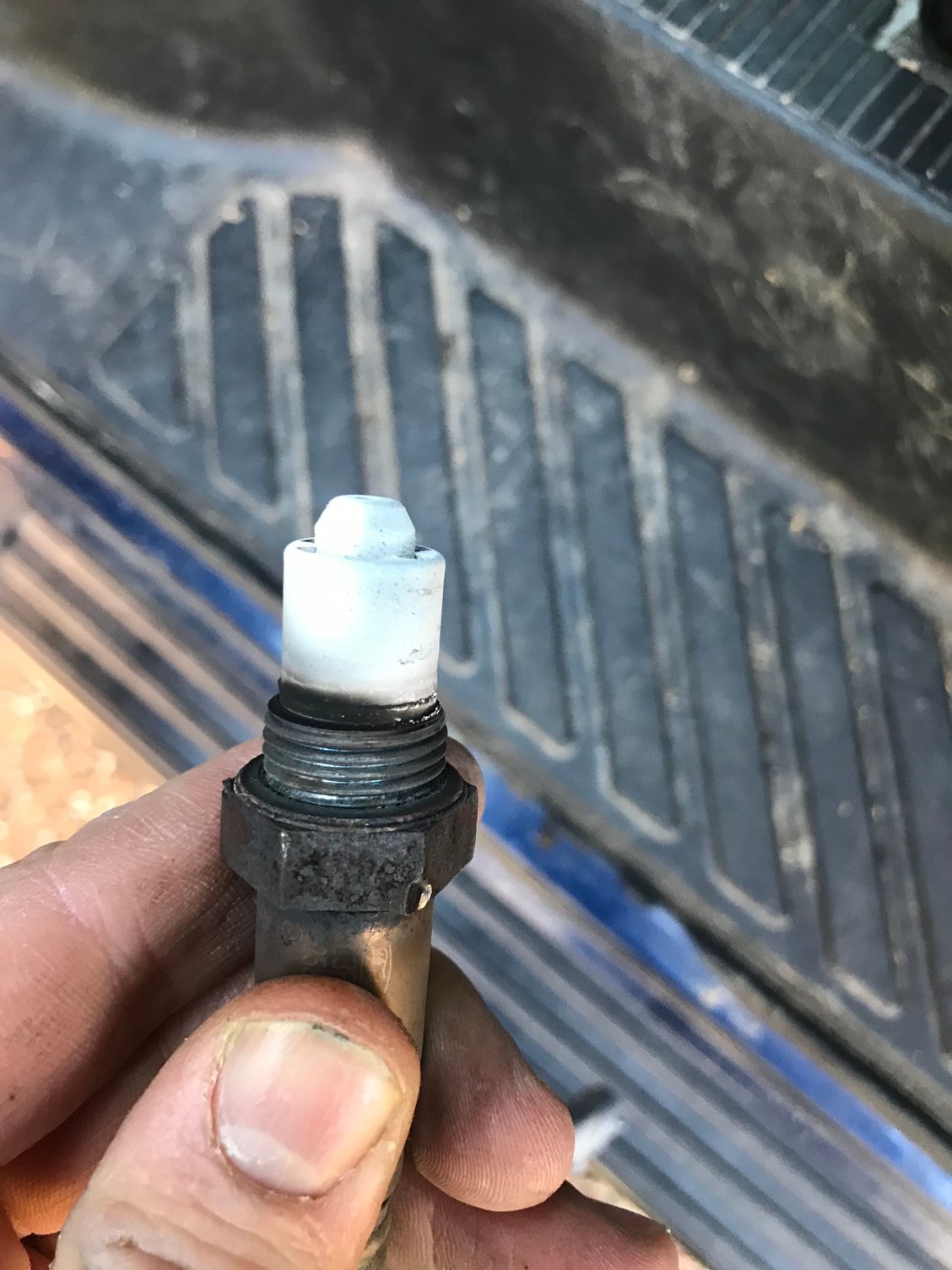

Old Apr 4, 2018 | 07:27 PM
NCMODELA's Avatar
NCMODELA
Posts: 44
These are the O2 sensors. 2nd pic was replaced 5k ago.
Old Apr 5, 2018 | 09:43 AM
krewat's Avatar
krewat
FTE Leadership Emeritus
Joined: Jul 2002
Posts: 42,561
Likes: 423
From: Long Island USA
I don't remember my O2 sensors with around 50K on them looking like that.
Old Apr 5, 2018 | 11:29 AM
NCMODELA's Avatar
NCMODELA
Posts: 44
To me they look carbon fouled. Like it’s running to lean. But the AF mixture is not lean. Is there anything else that will cause carbon fouling?
Old Apr 5, 2018 | 12:35 PM
rock2610d's Avatar
rock2610d
Joined: Mar 2013
Posts: 1,576
Likes: 41
From: Wyoming
To me that looks like coolant, deposits.
isn't carbon fouling black?
