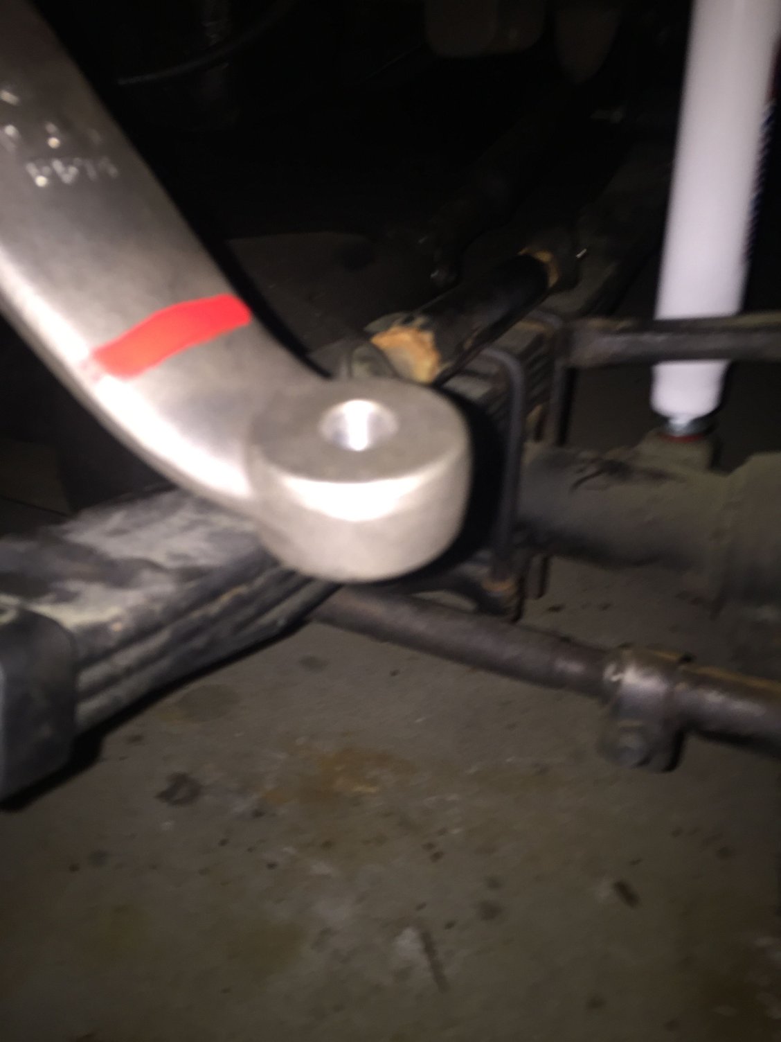

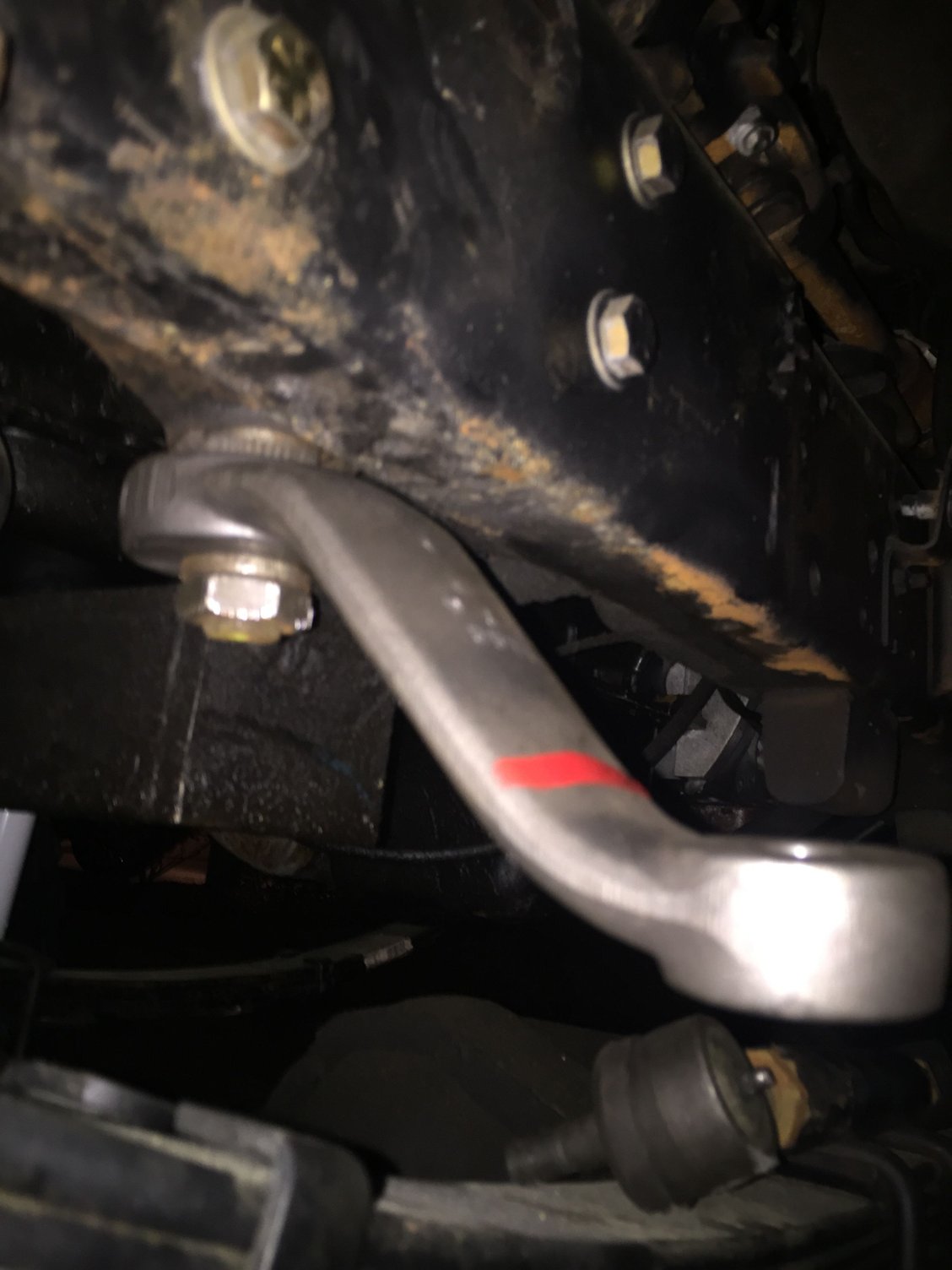

I just finally installed a skyjacker drop pitman arm on my 74 highboy. I used part # fa325 which fits a 77-79 f-250. Thought this would be correct since i have a 79 f250 dana 60 in front
Got the pitman arm attached to steering box, although offset of arm looked slightly different. however , my drag link will not fit inside the lower part of the arm. Basically the new arm has a smaller attachment point than the stock arm.
Do I drill out the new pitman arm, or can the end be changed out on the drag link? (or do i have the wrong pitman arm all together)

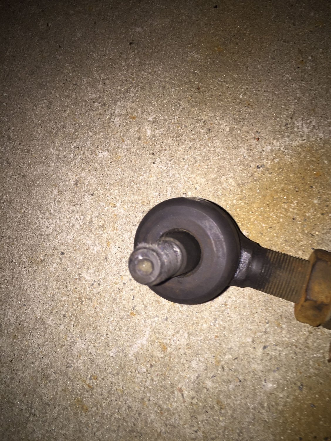

Might be that your drag link has the bigger Chevy end on it. The stock ford size is noticeably smaller and can be drilled out but with a tapered ream not a drill bit.

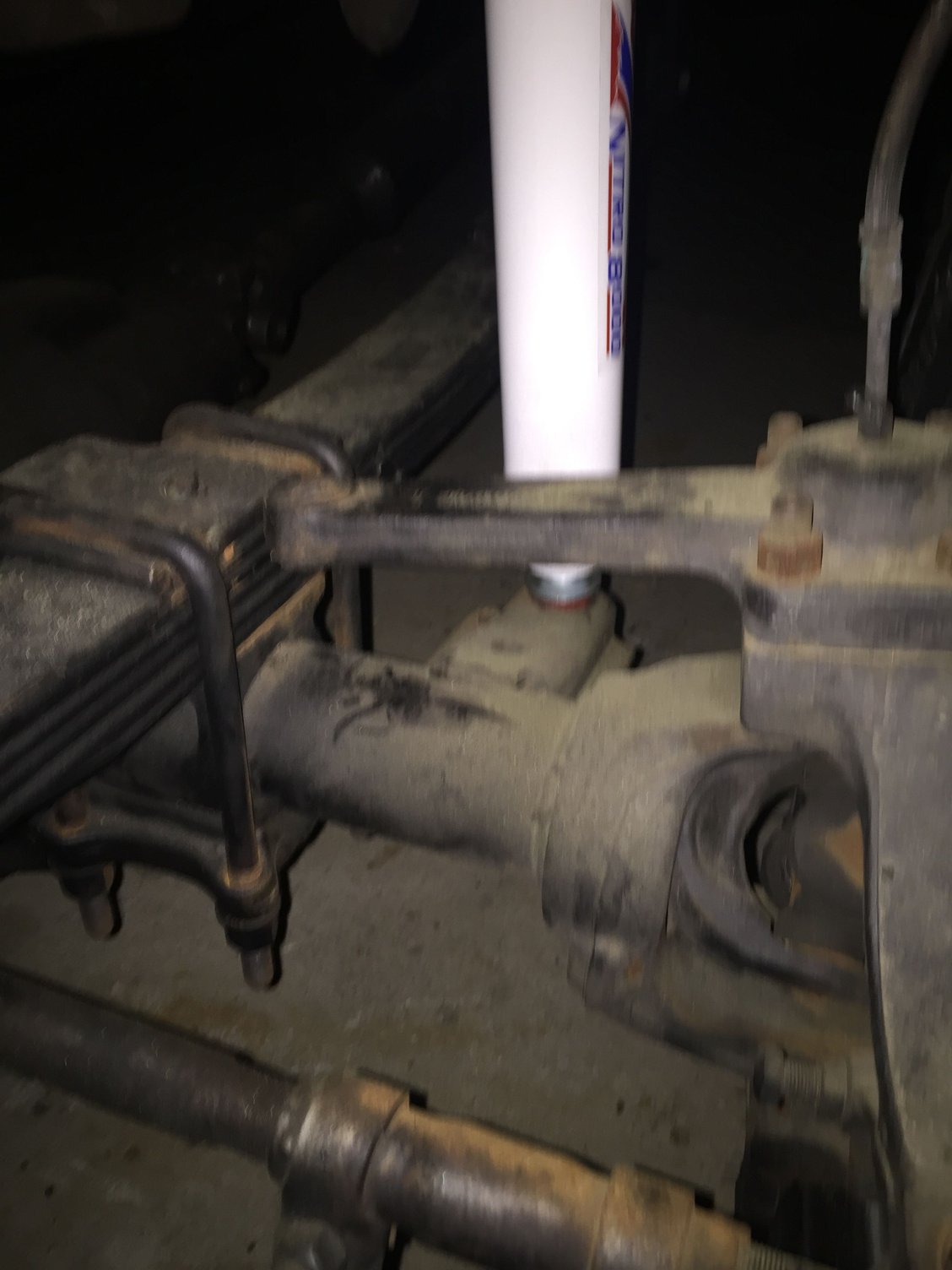

Looks like someone's homemade drag link with Chevy tie rod ends. I'm betting the axle already met the reamer, it's doubtful they kept the small Ford end on that side.

Not sure if these pics help?

correct. Both ends of drag link have the same size tie rod ends
