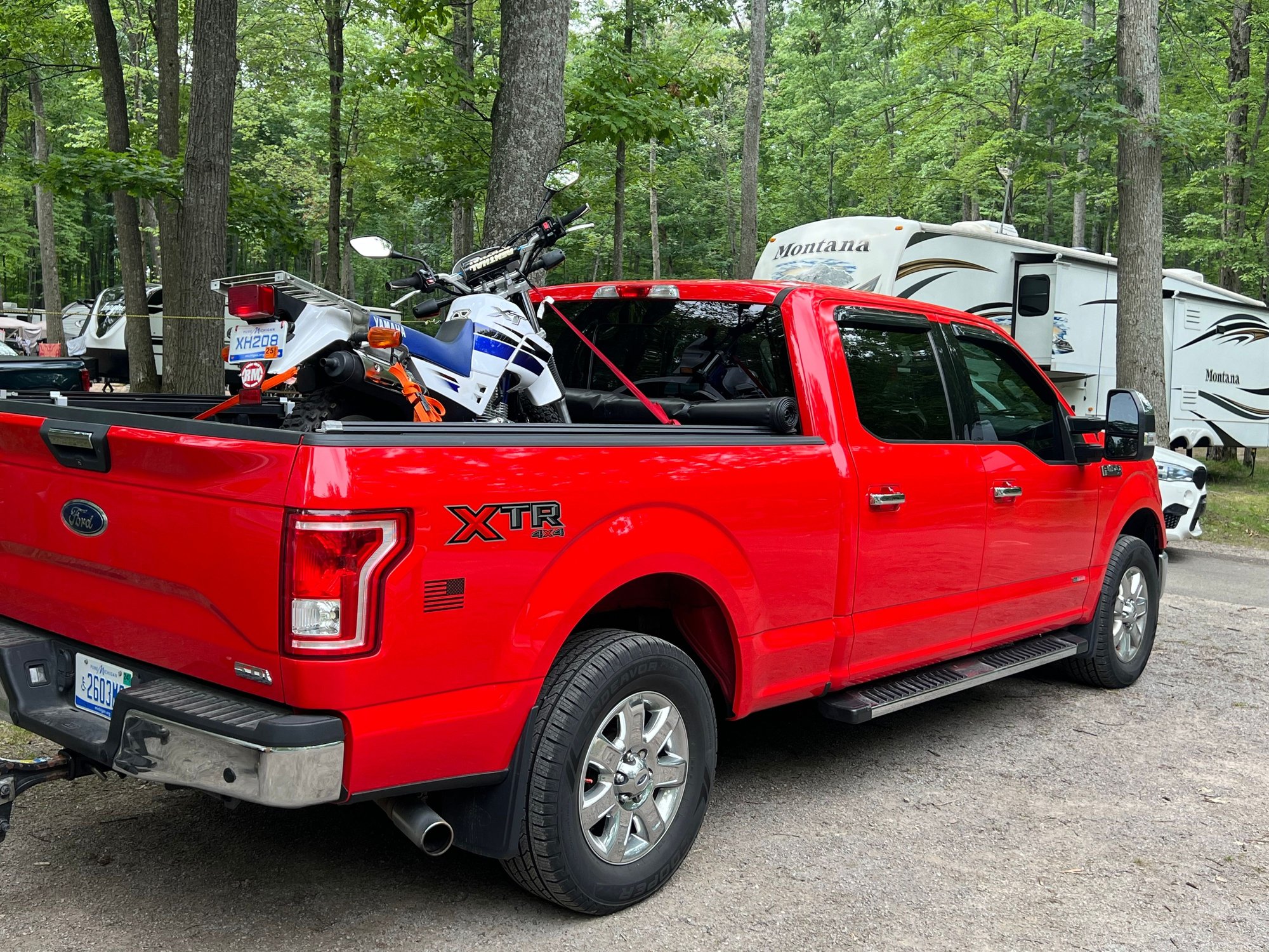

This was a few years ago. Ended up selling it. I’ve had a 2017 5.0 for about a year and a half now. Bought with 72,000 now around 95,000 with no issues. Towed a camper with it for about 1,400 of that so far. Love it! I’m keeping it until it dies. lo
