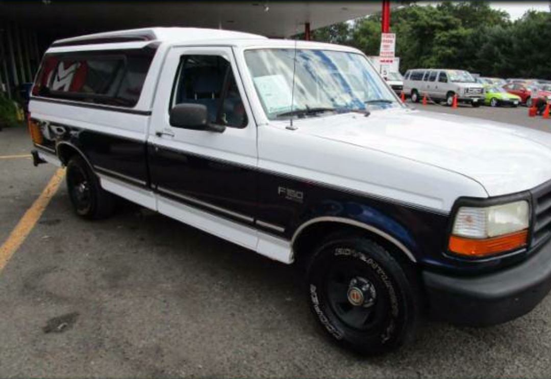

I bought a 1994 f150 2 wheel drive 302 automatic with 103000 on it. I have searched for years for an older ford f150. Love them. Well I drove it back from New Jersey. 300 miles. Ran excellent strong no tapping no tranny slipping etc. Baby is strong runner was taken care of no question. Well issue is. Here we go following not working horn cruise odometer speedometer. OD is flashing air bag is flashing. Is there a bad module bad wiring or what. I am keeping this old girl and plan on fixing the little rust on her. Placing the chrome back on her someone painted it black.
this is Betty
