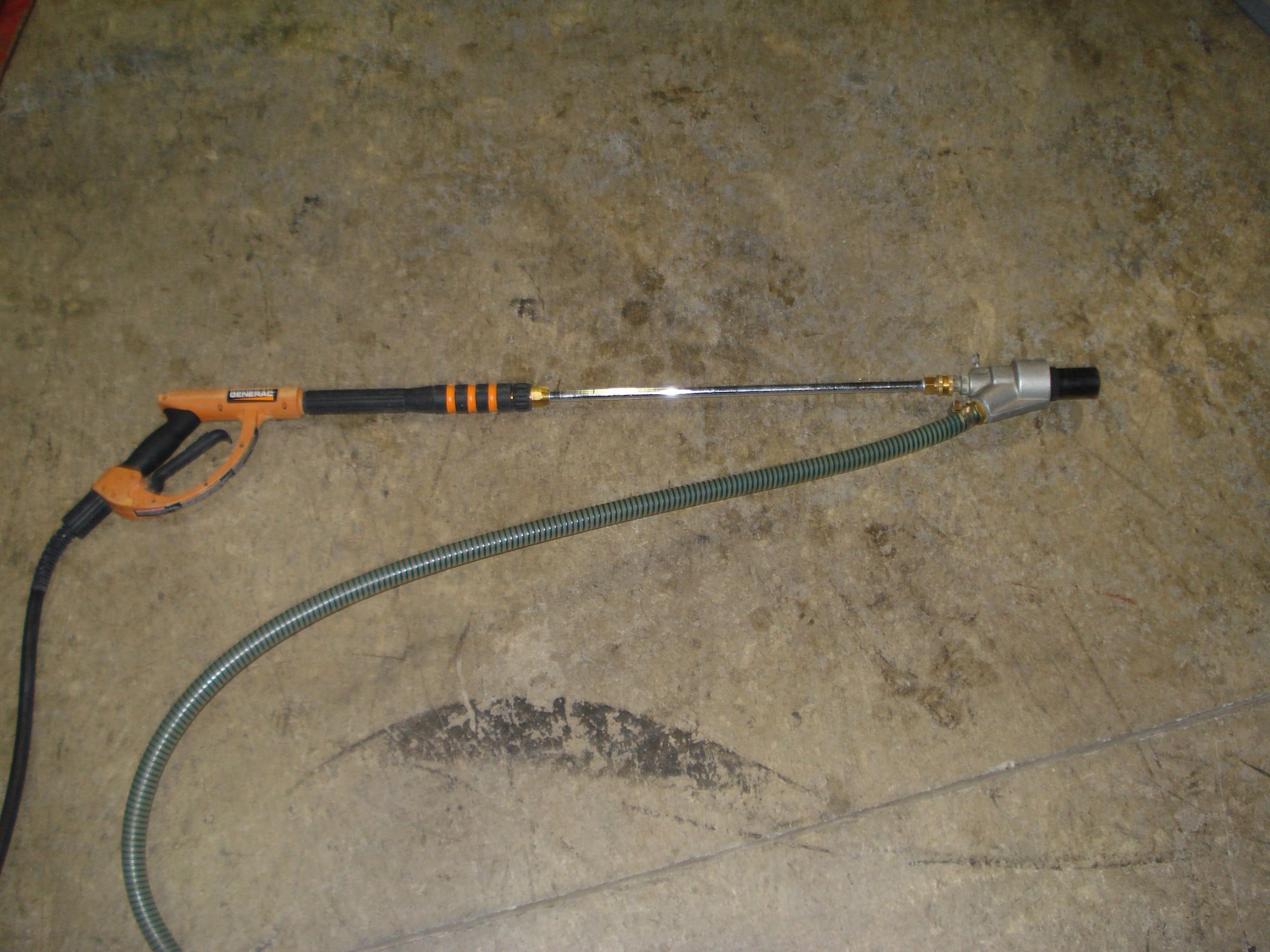

I have finally finished blasting the frame and took it to the powder coater last Friday. He called today and it is done, so I will pick it up tomorrow. Figured I should catch up this thread. My initial sand usage estimate was way out of wack. I ended up using 31 50 lb bags of play sand, plus 100 lbs of actual silica sand. I wanted to see if there was a difference in how the sand preformed. The play sand actually seemed to do a better job. The play sand cost $4.75 for a 50 lb bag and the silica sand was $11.25 for 100 lbs.
I forgot to get a picture of the dry sandblasting equipment, so I will get that later. I did make up a fitting to get rid of the lance on the power washer so it was not such a long reach.
Here is the standard power washing setup
Here it is with the fitting I made. Much easier to use, although maybe a little more splash back.
