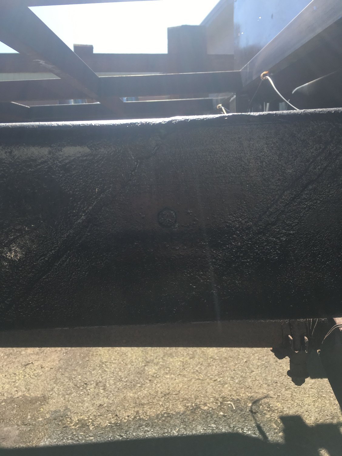

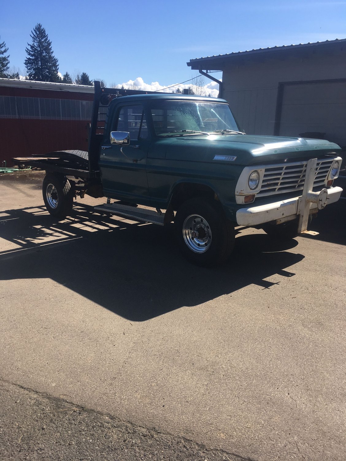

Have a 1967 f250 4wd that my great grandpa bought off the lot in 67 as a cab chassis. And it looks like on the frame they lengthened it 6in before and after the axle. And I was wandering what was the wheel base of a cab chassis truck?

Well if the frame was lengthened there was three things that were changed from factory. The wheels, the frame, and the full time hubs to hubs from a Early 90’s ford truck. It even still has the plastic cover for where the radio would be if it had one. It only has 39k miles on it and I know it has the 5 digit odometer. The truck was used as a farm truck and hauled a camper up to Alaska every few years or so until 1995.

1967/72 F250 2WD/4WD Regular Cab: The wheelbase is 131." It makes no difference if it's a Cab & Chassis or with 8' Flareside & Styleside beds.
