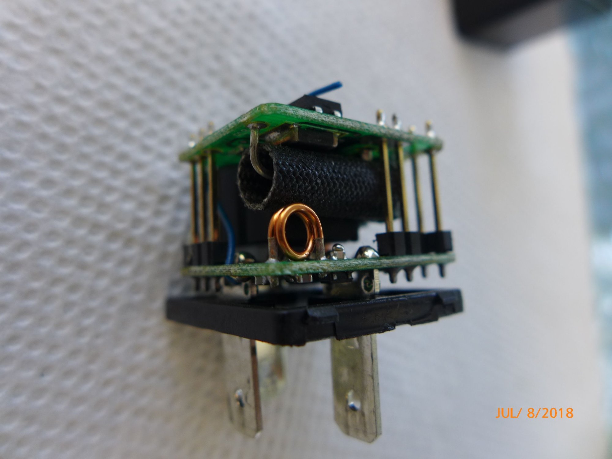

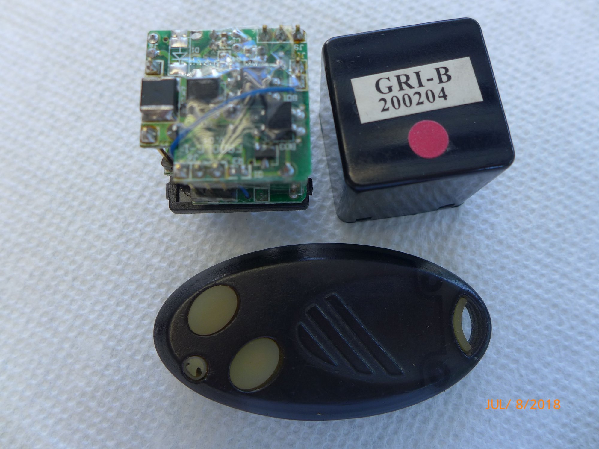

Old Jul 8, 2018 | 12:03 PM
Yahiko's Avatar
Yahiko
Joined: Apr 2012
Posts: 27,307
Likes: 549
From: Spanaway
Good to hear.
If you find the desire you might take the other one apart and post some photos of the inners and the contacts.
Old Jul 8, 2018 | 04:13 PM
HTM101's Avatar
HTM101
Joined: Apr 2017
Posts: 278
From: Maryland
Sean,
This is a remotely controlled relay and a bit more complicated than the OEM it replaced. You seem to enjoy all things electrical, and you've make my fix easy. I'll send this relay and remote to you so you can tinker and evaluate it. Then you can trash it or whatever. If you want it, I just need your address.

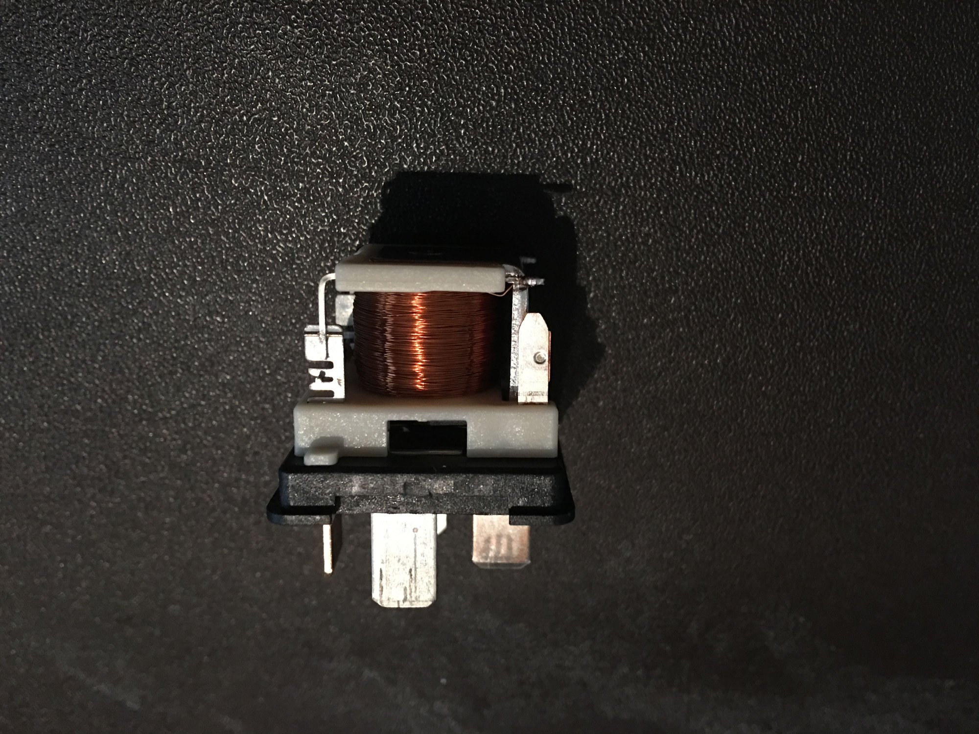

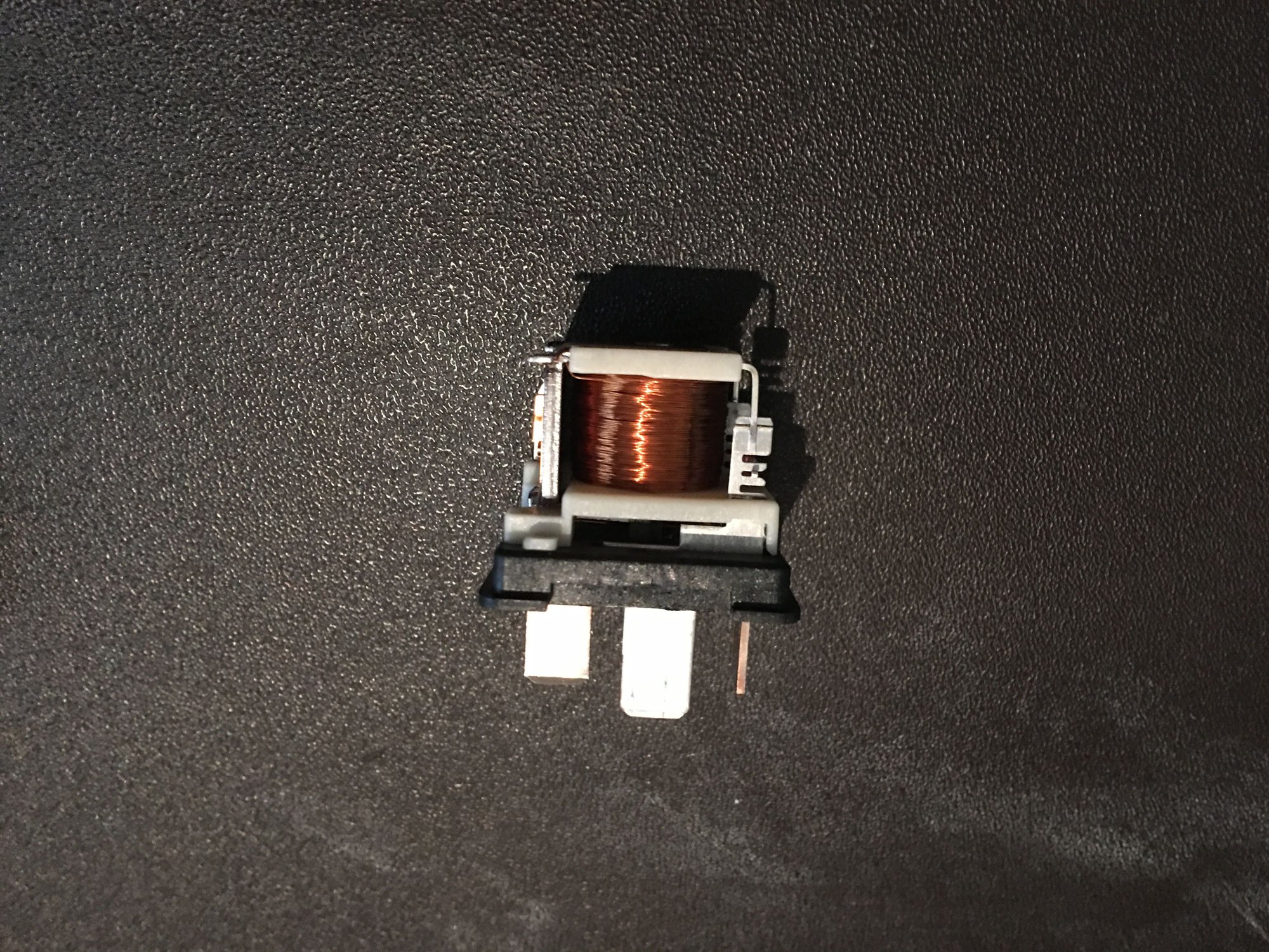

Old Jul 8, 2018 | 04:25 PM
TooManyToys.'s Avatar
TooManyToys.
Joined: Dec 2014
Posts: 17,829
Likes: 3,114
From: Jersey Shore
Here's the OE for comparison.
