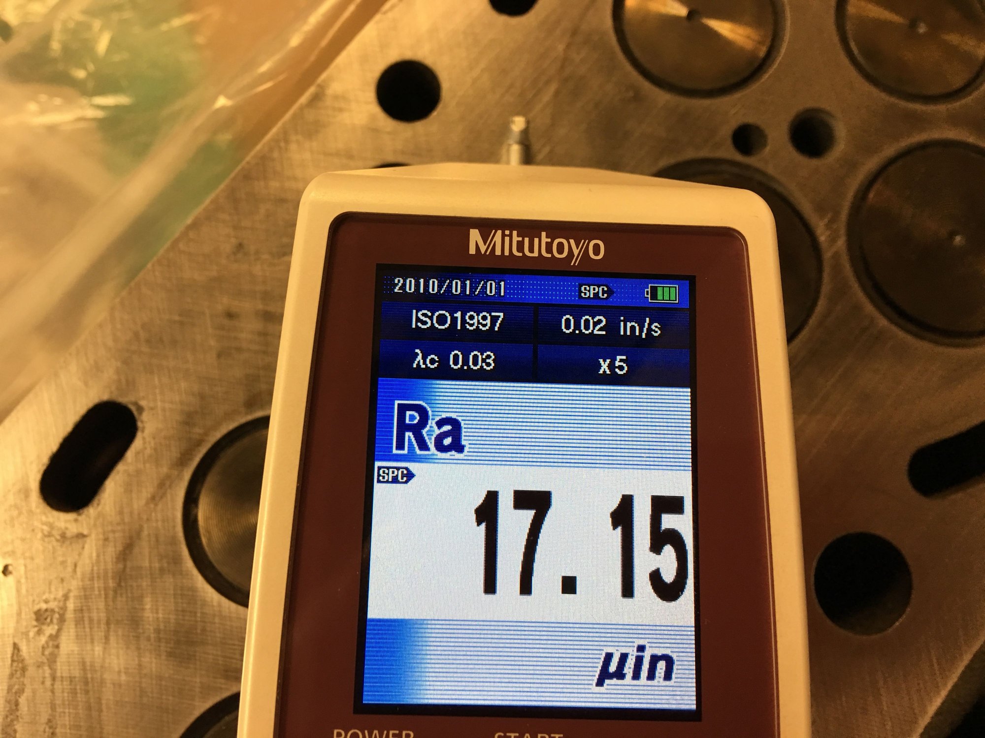

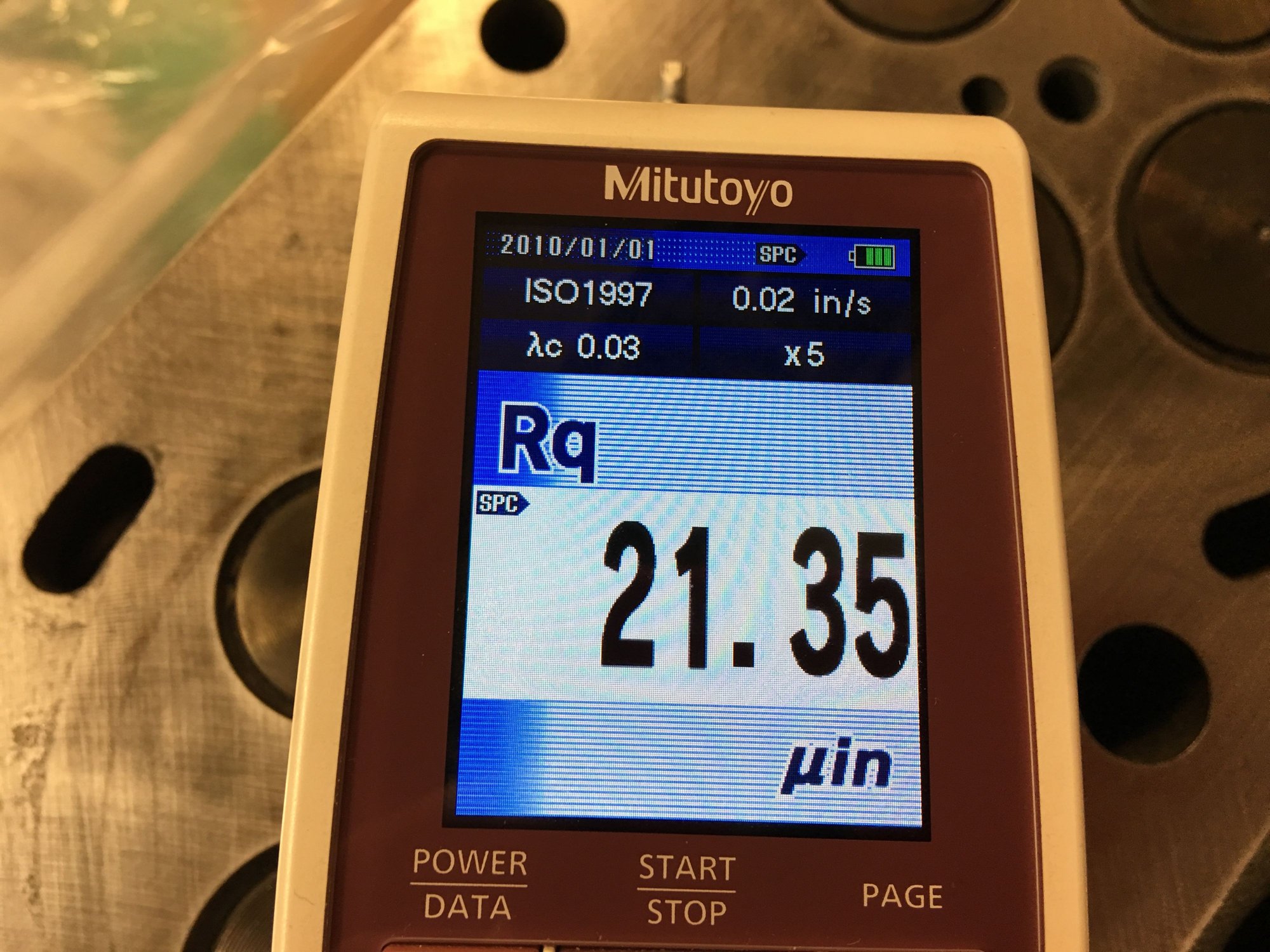

I cover the block and heads with one layer of a paper towel, the spray soak them with gasket remover. This prevents the liquid from getting into the recessed areas. I then cover with plastic wrap held in place with magnets. The covering prevents evaporation and you can let it soak in for a long time.
Then I fall back to what is shown in Fel-Pro's vid on block prep, as it's the same I’ve done for years. The Super Scraper, Scotchbrite green 96 pad by hand, and if I have to a brass wire brush of 0.006 to 0.008” wire diameter. That's the only powered work done, and it's mostly for the rusted areas on the edge of the heads and blocks, not the sealing surface. There’s something else I do but I’ll leave that alone for now.
