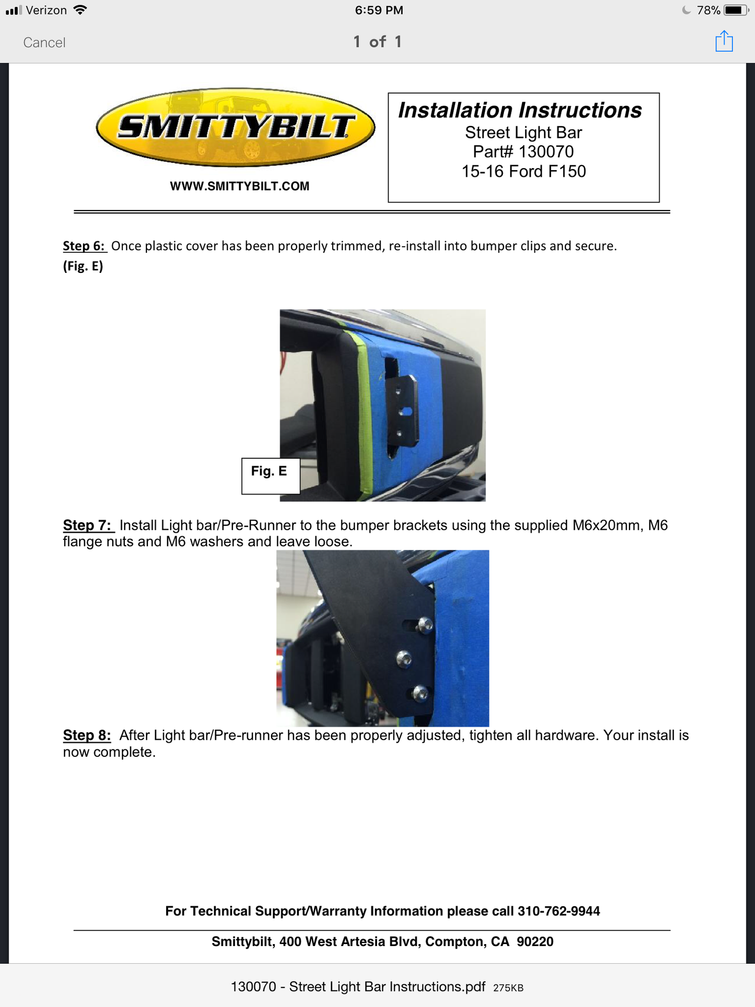

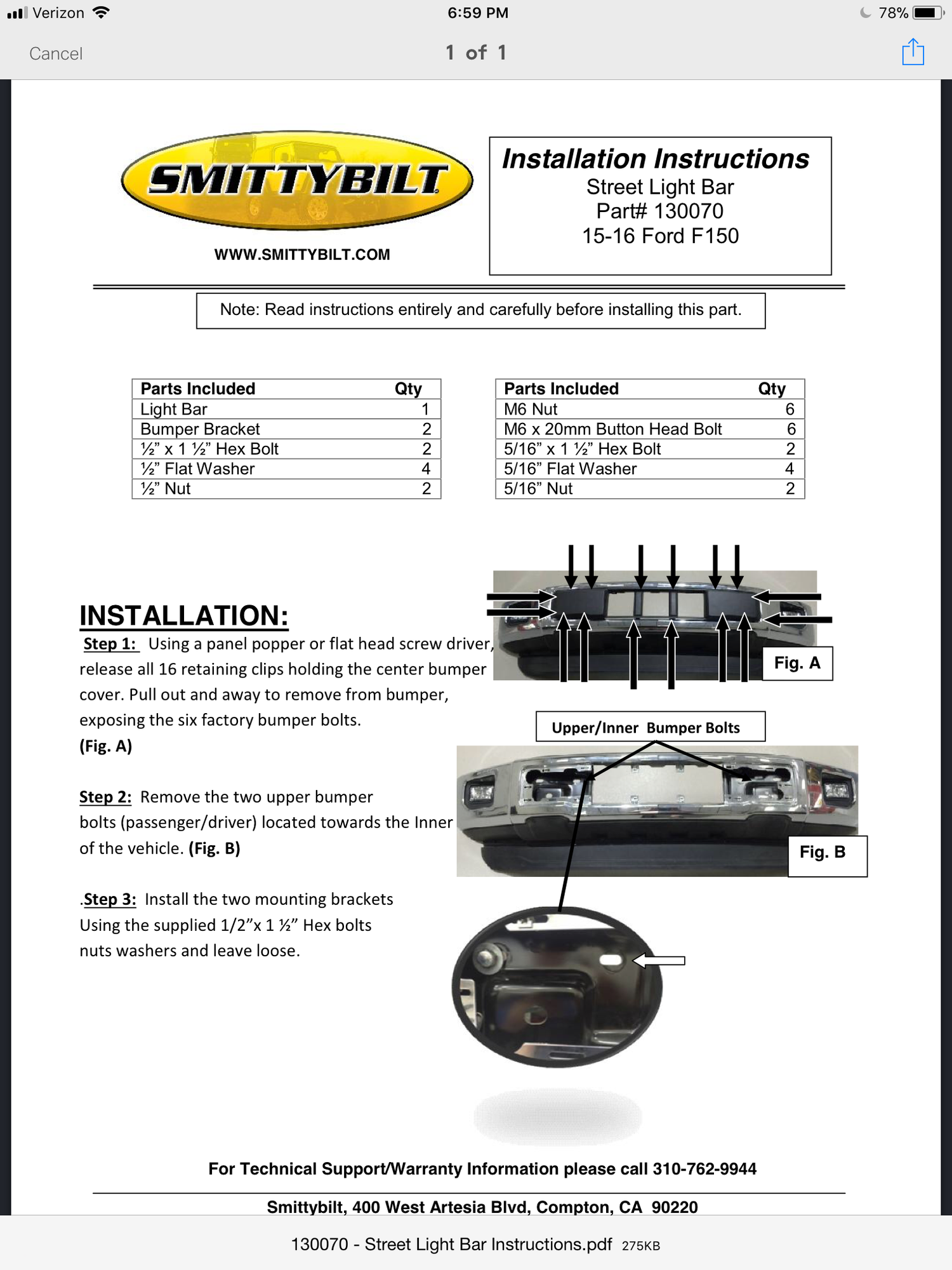

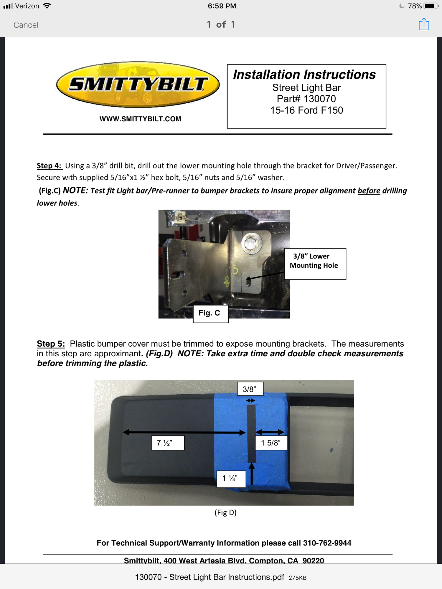

Here are the installation instructions. It doesn’t list 2017, but it is the same. Also, the Nfab bar is made by Smittybilt....you can order either and get the exact identical product (both have the Nfab emblem).

I am not sure if I want to do any cutting of plastic. That's the reason I am looking at Hammerhead, I can take it off and there won't be any trace.

Agreed. I was hesitant too, until I found out that plastic OEM bumper insert can be bought from my local dealer for $35. After learning that, I felt much better about cutting it. The Hammerhead looks good too. I just needed something to mount my lights that wasn’t too big. I really liked the idea of the Setina push bar (very different from these bull bars, it’s actually designed to push vehicles and is typically mounted to an emergency vehicle), but they are much larger than what I wanted on the front of my truck. You can even get the Setina made from aluminum...which I thought was pretty cool.
