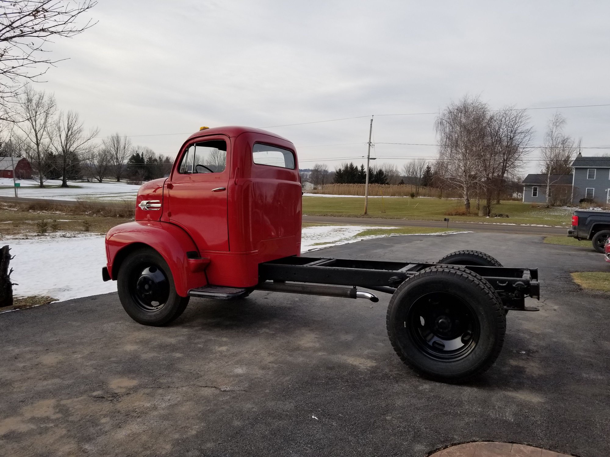

These on my truck are original 22.5 one piece wheels. Hard to find. They are from 50s 60s era. May have went into early 70s but not 100% sure. truck is an f6. Is the 19.5 wheel the size you want?

The last listings I have for 22.5s were Budd in 1979 and Accuride in 1981. The 19.5s are so much easier to find it makes them a fall back option. The good used 22.5s are really hard to find which makes the new ones worth a look. Stu
