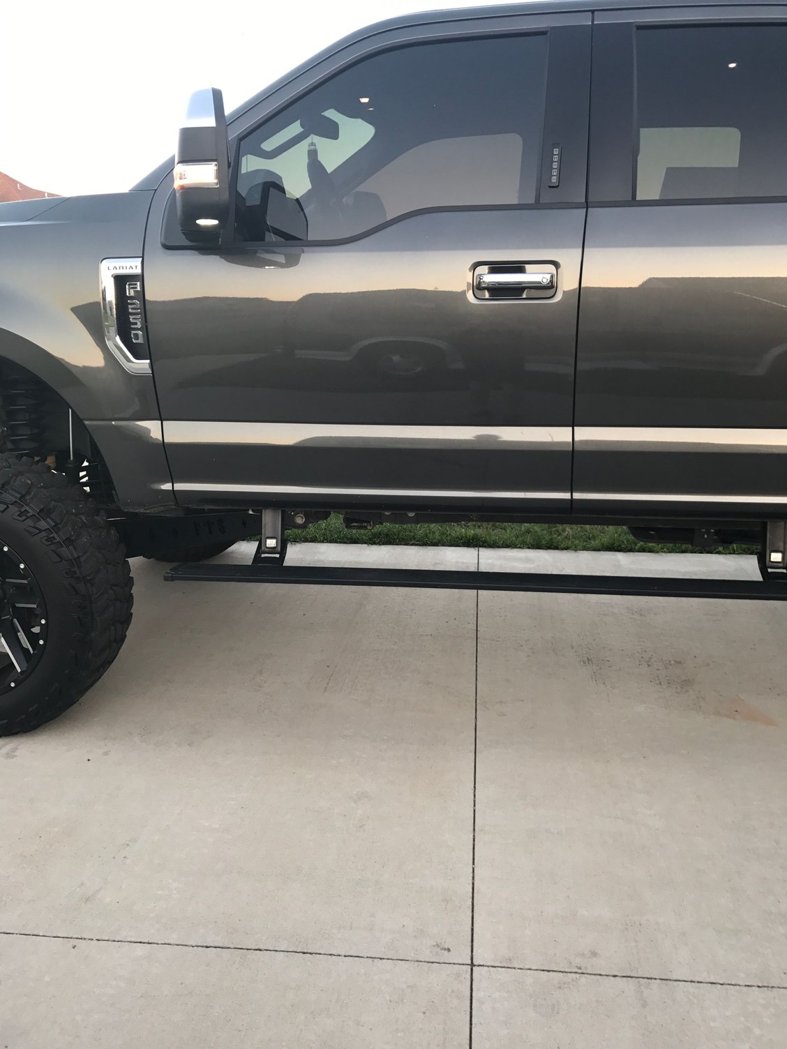

I have the Amp power steps and live in northern kansas( may not be the frozen tundra but it snows quite a bit) I’ve never had a single problem with the operation even with truck being covered in ice from driving. I would recommend these to anyone as they are absolutely worth the cost
This just shows distance from the ground.

Robert, how did you end up getting the powersteps with the chrome pkg. Aftermarket? If so do they turn on/off with the ford menu system like the factory ones do?
I was told that you cant get powersteps from factory with the chrome pkg. Don't ask me why.

Robert has aftermarket steps (Amp). I was able to order them with tha chrome package but decided not to, in part because you get no credit for the standard $695 steps included with the chrome package. You pay $795 regardless of whether or not you already have a package that includes the $695 standard steps. Still cheaper than aftermarket however.
