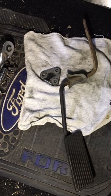

Somehow the bracket that holds the gas pedal rod to the firewall under the firewall pad has cracked and broken, making the truck basically undrivable for the time being. I have no junkyards with these trucks in them unless there is an 80s vehicle with an interchangeable part. When I looked at the exploded diagram I couldn’t pinpoint the part number either. Has anyone ever had to replace it? Where’d you get it from. Thanks.

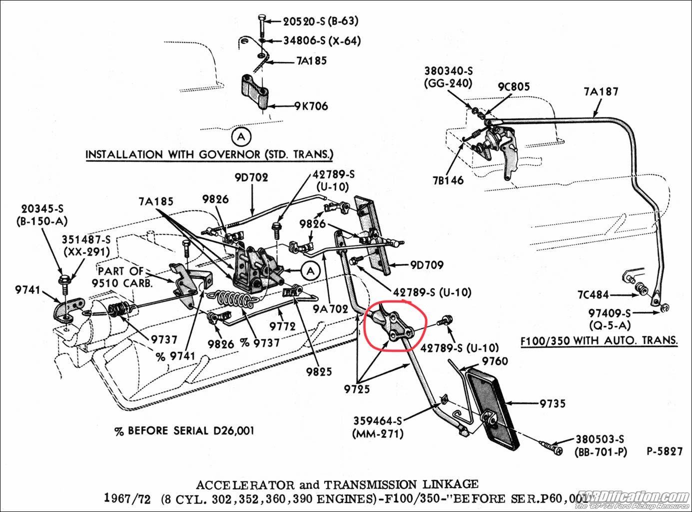

I found a much better diagram, but the part number seems the be for the entire linkage, not just the bracket. I hope that’s not the case.

Note the diagram says 8 cylinder. The six cylinder uses a different one. You can go online and find junkyard directorys, some who no doubt ship.
That is the case. As shown in the pic, 9725 is the accelerator ASSEMBLY.
Please, when asking questions, list ALL the pertinent info, we are not mind readers.
What year is the truck, what engine? I deleted your V8 pic, replaced it with the 6 cylinder pic:
1967/72 F100/350 240/300 use the same pedal assy: C7TZ-9725-AC (1 available NOS) .. 1967/72 V8's use several different types.

HIO Sliver i thought these pedal brackets where pot metal and can not be welded. maybe you could use some JB Weld on it.? however i have been known to be wrong once in a while.
I also think they are pot metal. If it was mine and I couldn't find one I also would be fabbing a new one from mild steel.
yes, I have an 8 cyl

Doesn’t seem like weldable material

It’s a V8, that’s why I used the V8 picture
It’s a v8 that’s why I used that picture. ‘72 302

Now JB is an idea for temporary purposes. Not sure how long it will hold it.

Same thing happened to my '69 on the day i bought it on the way home, the accelerator fell to the floor making the carb go WIDE OPEN ! Talk about "pucker factor 10" hence she will always be called "Lucky". I came up with a shade tree fix until I could find a good used one, not pretty but worked.
That's very cool. Nice. I don't see why this wouldn't be am almost permanent repair.
