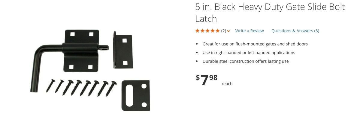

Originally Posted by pchelp
thanks, i live by the ole saying "necessity is the mother of invention"
I think it looks good. did you make the bracket or is it repurposed from something else?
Thanks to the local Big hardware store, be sure to save your nylon bushings other wise it will rattle.
I work there. Bingo. Thank you!

NashvegasMatt would that maybe the Home Depot.?
can’t beat the price

what does the gate latch look like from the other side after you make it fit your truck.?
Old Mar 16, 2018 | 09:59 AM
pchelp's Avatar
pchelp
Joined: May 2017
Posts: 590
I just re-drilled the holes to match the original bolt pattern.

pchelp what i meant was how did you attach the gas pedal rod to the back of the bracket. a picture would be a big help.
yessir it is
The latch needed to be persuaded apart then the arm of the pedal is crimped back in. This is the only other picture I could dig up. I hope it helps
