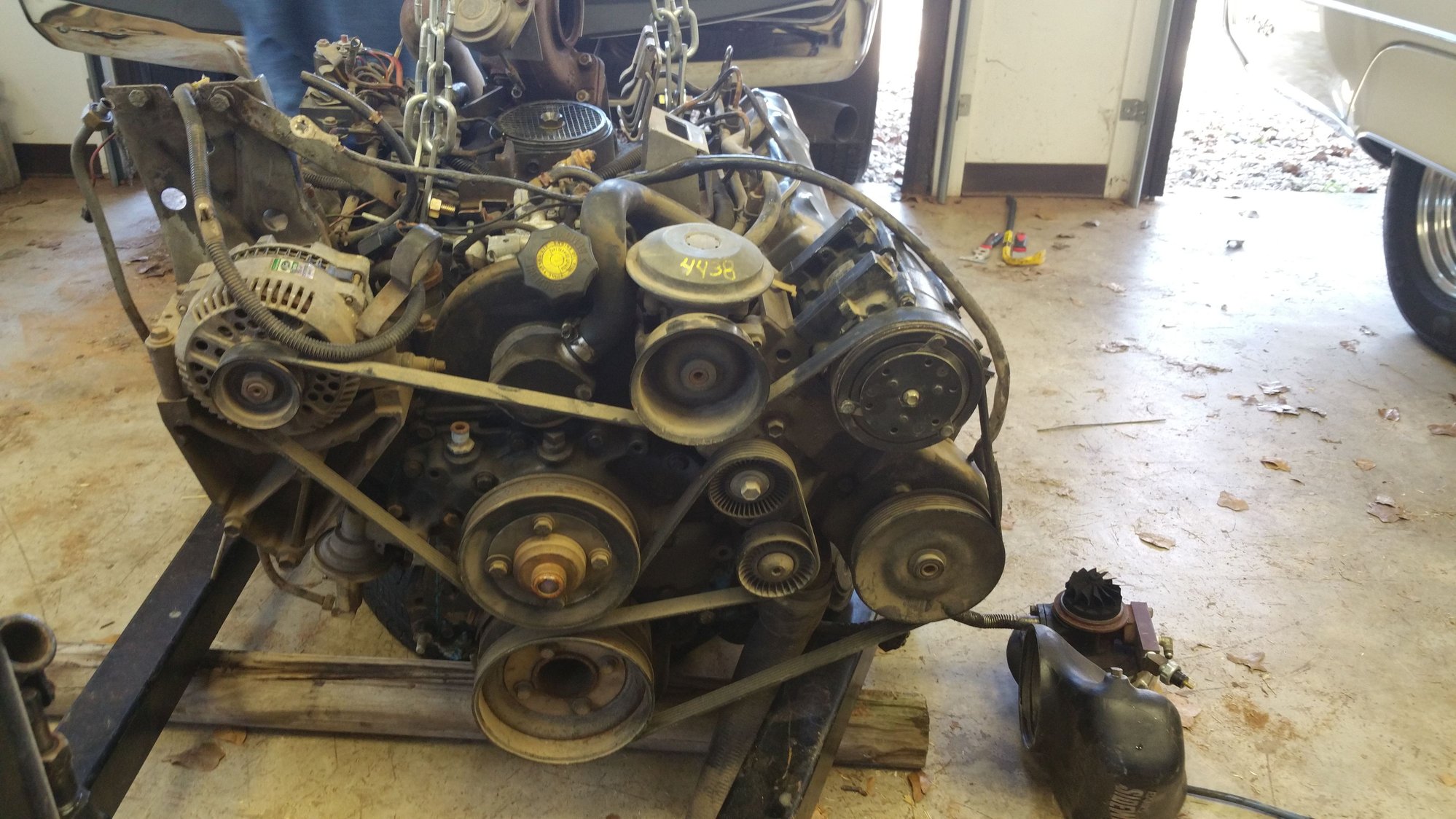

I got the engine onto a tire on my shop floor. I had to disassemble the intake side of the turbo and I had just enough room to clear the injector lines when I bolted the hoist to the lift points.
I was told that the engine was no good but it definitely looks like it was rebuilt or at least painted in the past. At the very least I will have to install head studs before I replace my 6.9l, so I should be able to assess the condition of the engine.
The engine supposedly came from a 92 f350 with a ZF5. I think I am missing a few turbo parts and engine parts (fuel filter header, flexplate and auto tranny turbo parts). The price was right though. $500 + $150 for a core if I want to return my 6.9l. Oh yeah...
Here are some pics.

I bought it from Eagle Mountain Auto Salvage in Fort Worth, TX. I didn't see the truck it came out of because the engine was on a wooden pallet in a warehouse. However, the folks at the salvage yard said the truck had been wrecked. The engine was covered in bits of windshield glass.
When I removed the oil filter there wasn't any glitter in the oil. When I finally get the rest of the turbo I will remove the heads to install head studs. If all goes well, it might only need gaskets and paint. Of course, it could need a full rebuild too. Either way I think I got a good deal. I need to get a good engine stand for it before I disassemble it though.
