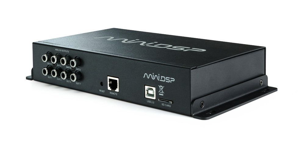

The reviews for it on Crutchfield are pretty dismal. Honestly, If I were going full active I would be getting a MiniDSP C-DSP6x8, the featureset and support are really unheard of at this price point. It's only $50 more than the DSR1, and does a whoooooole lot more. Plug a mic in and you can auto tune your time alignment and crossovers, all sorts of cool stuff. It might be a little too DIY/Techy for peeps here though.
http://www.minidsp.com/products/car-audio-dsp/c-dsp-6x8
The miniDSP C-DSP 6x8 is a Digital Signal Processor (DSP) targeting mobile/car audio installations. Leveraging years of experience building reliable platforms, miniDSP engineered the C-DSP 6x8 to pack plenty of processing power and I/O into a small and sturdy enclosure—a perfect fit for installations with limited space.
On the hardware side, the audio configuration of 6 x inputs (analog and digital) by 8 x outputs is perfect for multi-way setups. Don’t be fooled by its size or its price, this small enclosure packs high quality converters and enough DSP power to make your audio tweaking dreams come true. On the software side, the software application allows real time control of the unit via its driverless USB interface. The onboard microSD card slot supports offline configuration and firmware updates if you ever miss your laptop. Finally, the C-DSP 6x8 will follow in the footsteps of our product line with constant upgrades via new plug-ins and new features. Stay tuned for an exciting new ride!

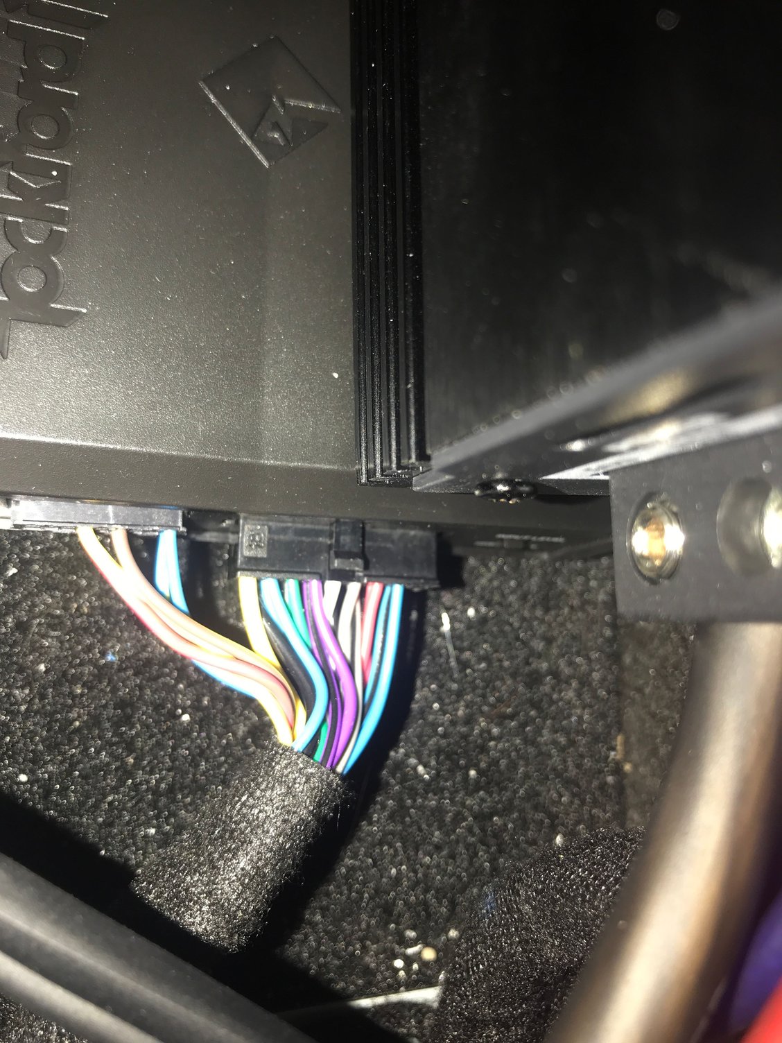

I'm not completely finished installing my system yet but I'm enjoying the DSR-1 so far. The hardest part of setting up the system is that nowhere in the paperwork does it mention you need to update both the idatalink Maestro part but also Rockford side of it. Once that was completed, it plugged in with little to no problem and was running in a matter of a couple minutes. I double checked with SloScooter on a extra harness that was not needed as well. Tuning was quick through my iPhone but I'll spend more time on it once my replacement sub is here and installed.
