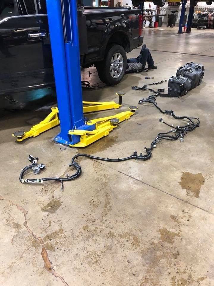

I had the tsb done as well. Its a big deal. complete wire harness and about 25 new connectors. R and R fuel tank, spare tire, and def tank.. Mine took two days.

TSB 17-2196 This is considered a safety hazard. If you take it into the dealership they probably won't give it back to you as it can cause a wreck. Mine started out doing what yours is doing, and then one day the driver's seat went all the way back, the steering wheel went forward and up and the seat massagers came on and couldn't be turned off,,, while doing 80 mph.
You'd better get this checked out. Its been taking some dealerships a month to get the wiring harness as they are on National back order due to high demand. The harness runs from the cab to the trailer hitch. The questionable connector is located on the passenger side of the trailer hitch. It gets full of water and shorts everything out over time. One guy had his tailgate come down on a post that scratched it.

Same issue. Took a couple days. They did give me the truck back as only issue was tailgate opening but they had to get it done prior to a trip towing my 5er. I could see how bad that could be. They suggested removing the tailgate and i said no. I did not know it affected other things too. The harness was hot rushed and i belive the last of what was available at the time.
