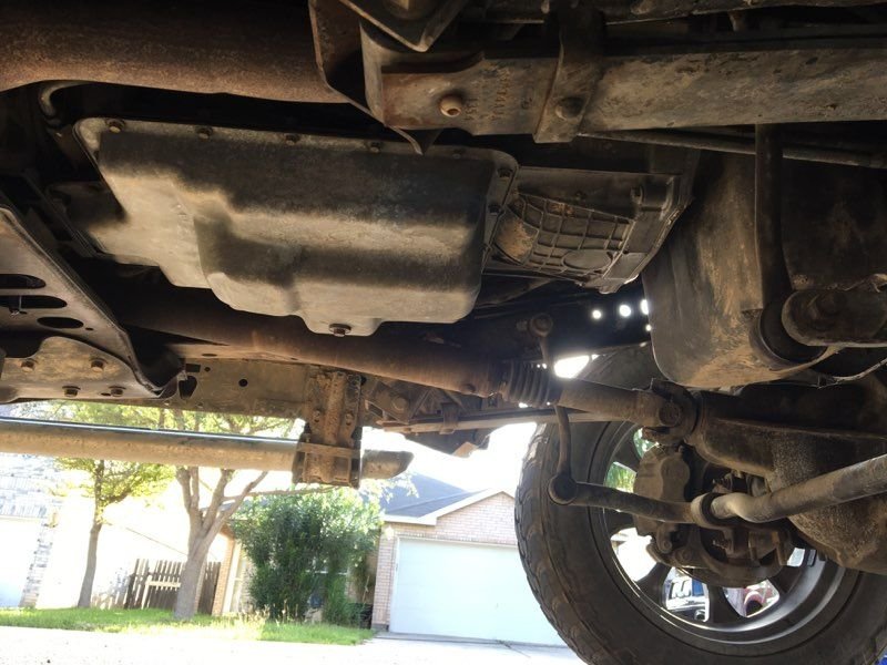

Looking at buying a Texas excursion this weekend. Hoping to drive this vehicle for the next 10+ years, hopefully more so is this undercarriage good enough? Also, I have a obd Bluetooth plug. What app do you guys use and what should I look for on the test drive? Thanks for your help again

I don’t see any rust just some typical corrosion on uncoated parts.
what I do see is.
minimal leaks
optional rear sway bar
Front and rear blocks on stock springs.
otherwise stock looking

I don't see too much rust, just its been on the beach a bit. I also have a 6.0 and love it for towing with the family. I would ensure the oil temp and coolant temp run no hotter than about 205 and are within 10 degrees of each other. If not there may be some problems. Also, make sure there isnt a bunch of smoke coming out of the exhaust.

Looks clean underneath. What's the rest look like? Maybe we can help with what we see in pics

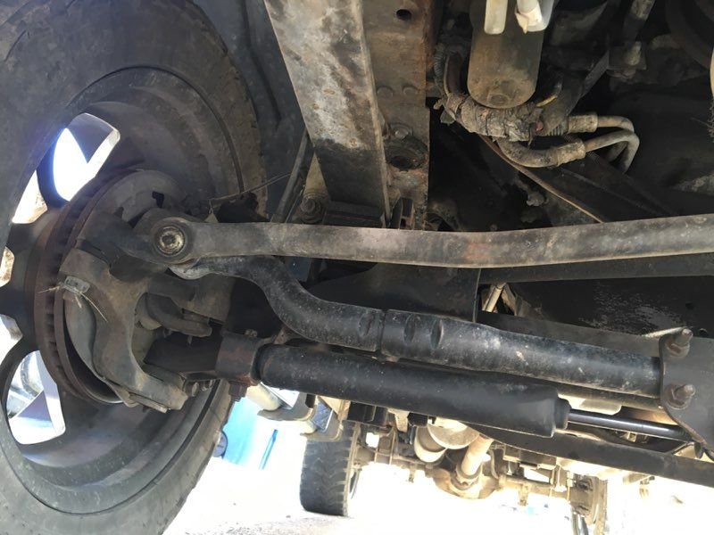

Being in the rust belt, I call that truck virtually spotless underneath. Look how good the back side of those rocker panels look ! I'm not in love with the mini spring packs on the front axle nor the stacked lift blocks in the rear, and it looks like it needs bump stops in the front.... but otherwise pretty nice under there.

Yup, passenger side bump stop is blown off. Somewhat standard but I suspect the front shocks are also shot as well as these go hand in hand.

Looks to me like it may have been on a fork lift/loader at one time. LH rear rocker flange dented. If Texas, may have been in water.

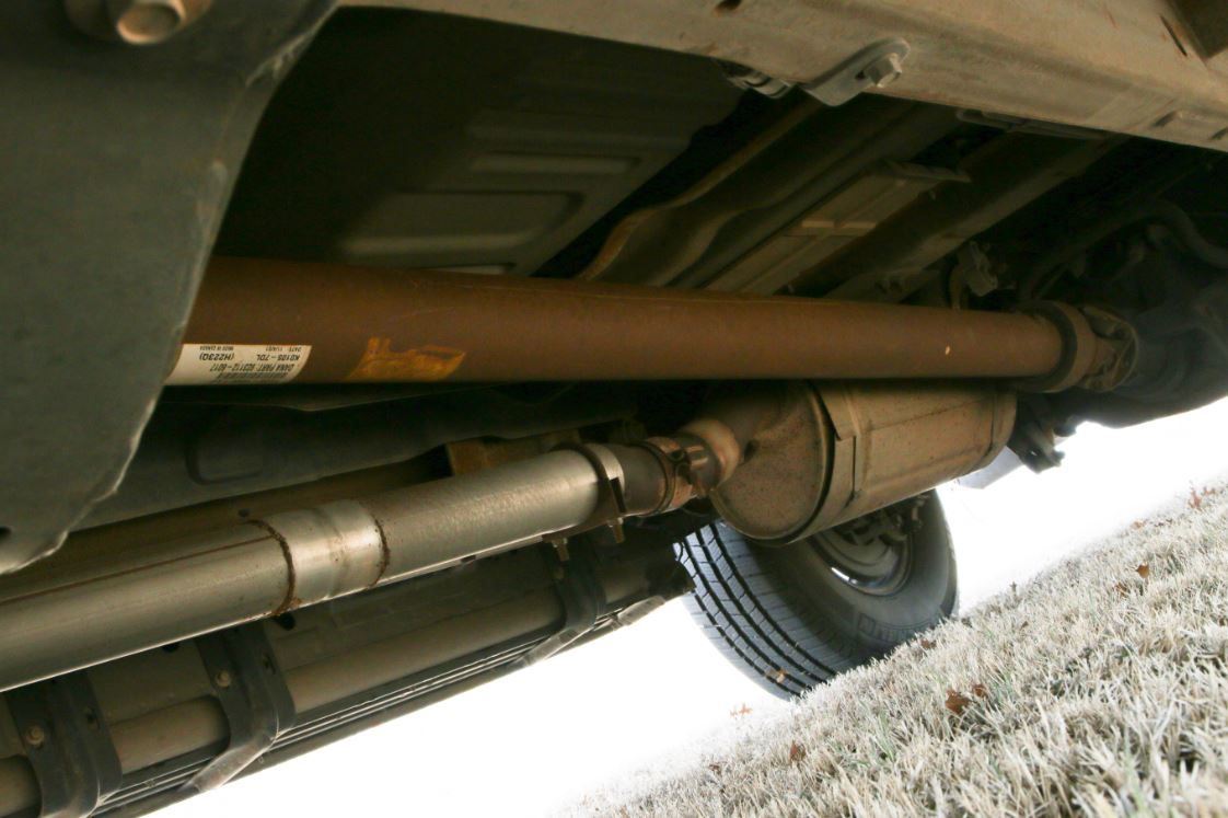

Compared to mine, that's not that clean. this is the best pics I have at work of mine...it's looking for a new home as well.
