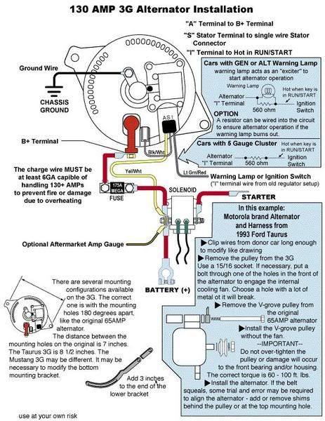

I used to have the same charging problems on my 1990 until I upgraded to a 130 amp 3G alternator. Here is a wiring diagram.

I understand what you are saying. I upgraded to the 3G because it helps eliminate connections problems with the external voltage regulator and charges better than the 1G system at low rpms driving around town. The cost was nearly the same for the 130 amp 3G alternator as the 90 amp 3G alternator and allows for improving my stereo system when I get around to it.

Changing an alternator and a couple wires is hardly an extensive change. It's a bolt on deal for only marginally more than a 1g or 2g. If you have a 2g, note they tend to melt the wiring and could be a fire hazard. For me at least it's not worth messing with a 1g/2g alternator, when they die or the regular dies I replace with 130 amp 3g. My time is worth enough to myself that I'd rather just upgrade and be done with it.
Aside from that, just the field to +12v and measure voltage, should go up to 16v-17v at full field. Only do this briefly as the alternator will get hot, but it verifies the alternator works.
Check that the regulator is getting full battery voltage at the key on 12v battery terminal (A)
Check that with key on you are getting near battery voltage at the key on 12v terminal (I)
Check voltage at the field terminal output on the regulator (F) and at the alternator field terminal when voltage is low. You should be getting full battery voltage at both. If you have that at the regulator output terminal but not at the alternator, replace the wire. If the other terminals on the regulator check out but you don't get full voltage at field while battery voltage is low, the regulator has failed.
