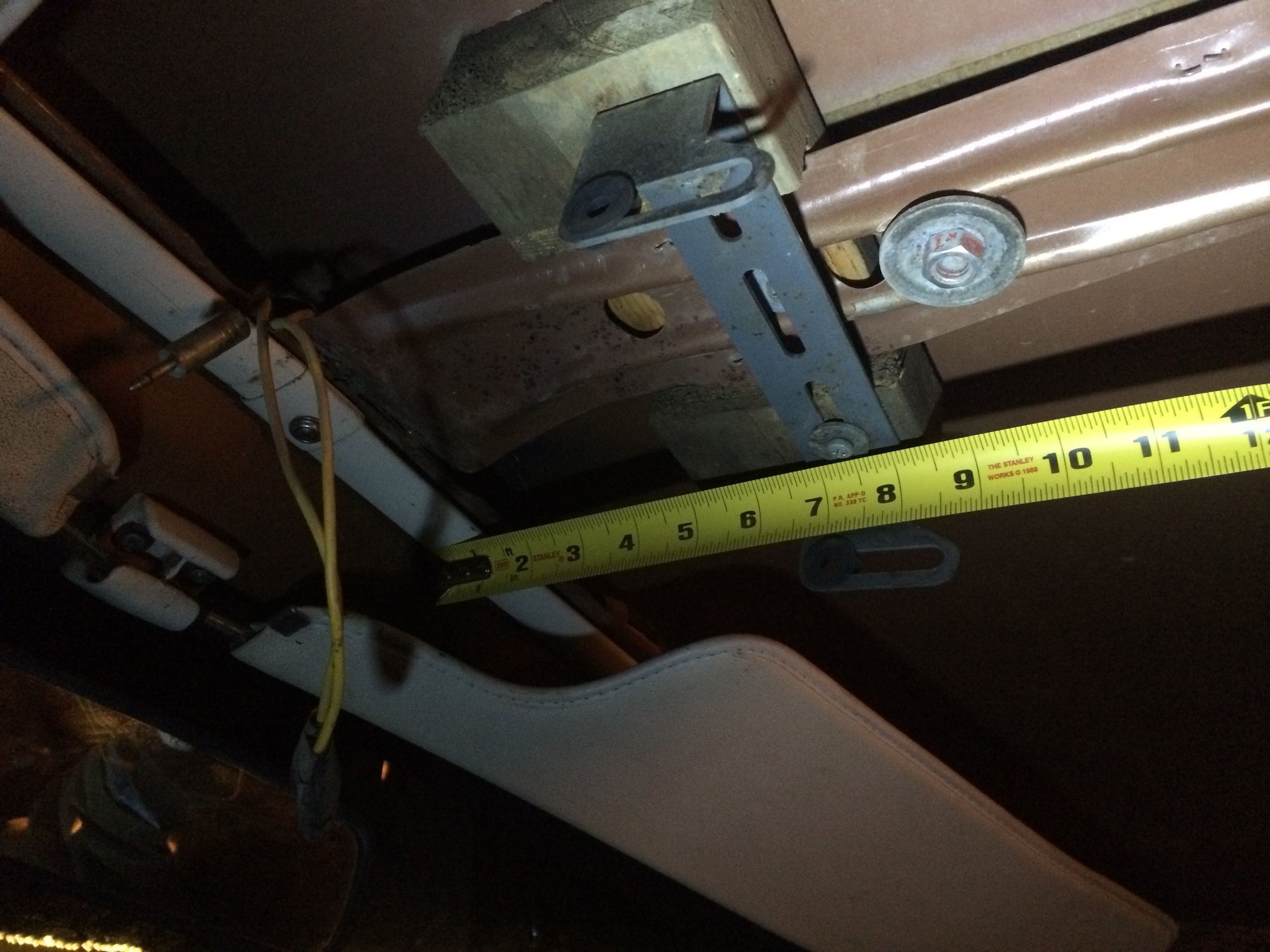

My truck was already setup for a CB from the 70's in Saskatchewan. I had a wooden block already in the truck cut to fit above the roof brace. I just screwed through the headliner into that block. I used the wires that already ran up the passenger side pillar and added a weatherpack connector. I routed the Coax along the windshield and across to the rear passenger pillar where I already had a hole in the tin for an antenna. I haven't got the actual antenna on in the picture but you can see on the passenger side rear pillar the gasket and the mount for the antenna. I run a spring on it so it doesn't tear the steel out if I catch it on something.
