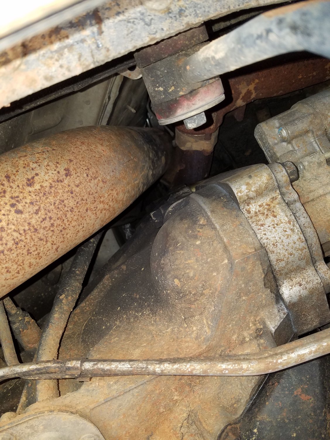

So I was changing the oil yesterday and while I was under the beast I decided to just check things out. I saw a bolt that looked to be looseand investigated further around the starter. What is going on here? If I put light force on the starter, I can move it an 1/8th of an inch or so. Also, is there a missing bolt here?
I havent done any work to the starter, surely its not supposed to be loose but it seems like there is a "housing" loose, and not just the starter itself.

Yeah, looks like you need to replace and tighten a few. And you have a film of oil covering everything too, that I'd want to clean up and find the source. It might be worth inspecting your flywheel and starter gear for damages.

Do you have an automatic tranny? if so I believe there is an adapter plate that bolts to the motor. check all bolts for security
Edit: So it just didn't look right. I went out and looked at my truck. That is the tranny bell housing bolt and you are missing one. The picture makes it look smaller than it is

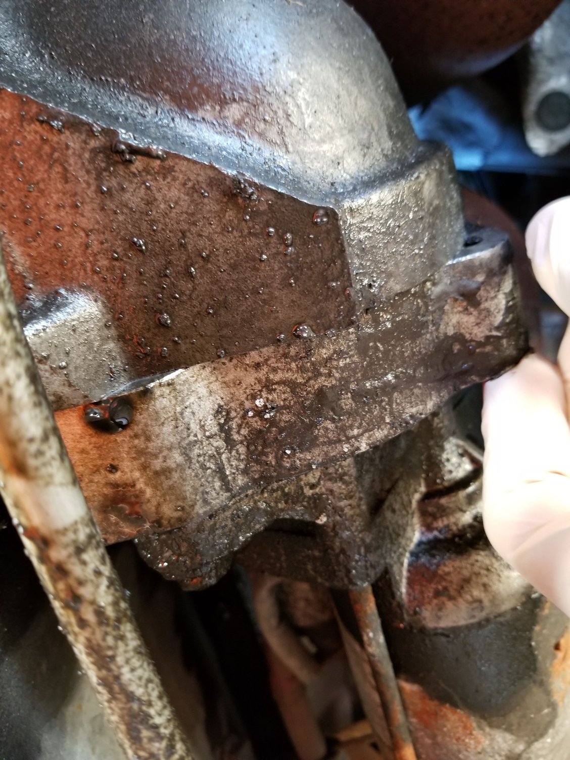

AllaboutMPG - I do have an auto trans. Do you know how many bolts are supposed to hold that adapter plate? I may have lost one, and the other (picture 1 from my first post) is loose.
But the starter itself isnt loose.

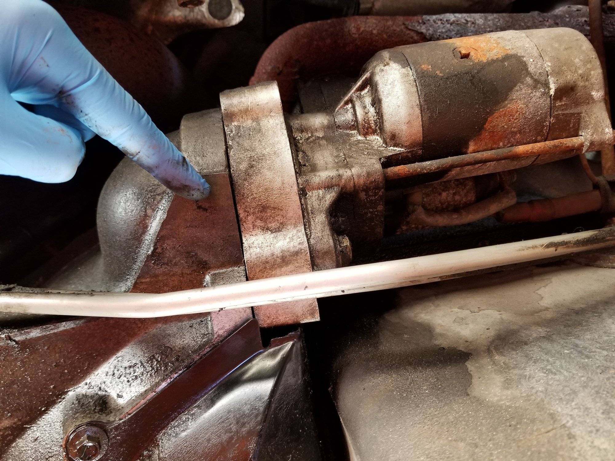

This isnt loose
This is the part that is loose.
Do the starter bolts go through the piece in the picture above and then into this part?

The part that is loose is your TRANSMISSION. Probably 8 to 10 bolts total. I've never had one out.

Starter bolts only go into the plate, not all the way through

oohhhhkay.... I guess I'll get back under it...... Seems like the adapter that I have isn't as flush with the trans as yours is.

Alright, so after some more research I think I can speak more intelligently. I have a 2 bolt starter and it is not the problem here. It is tight to the adapter. Looks like I have 1 loose and 1 missing bell housing bolts.
